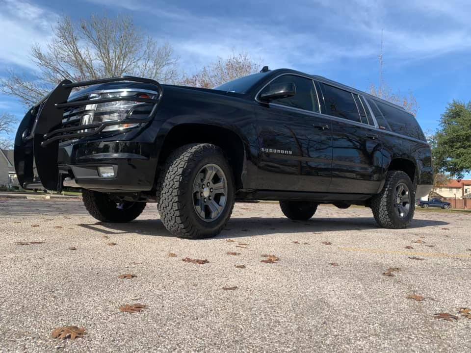

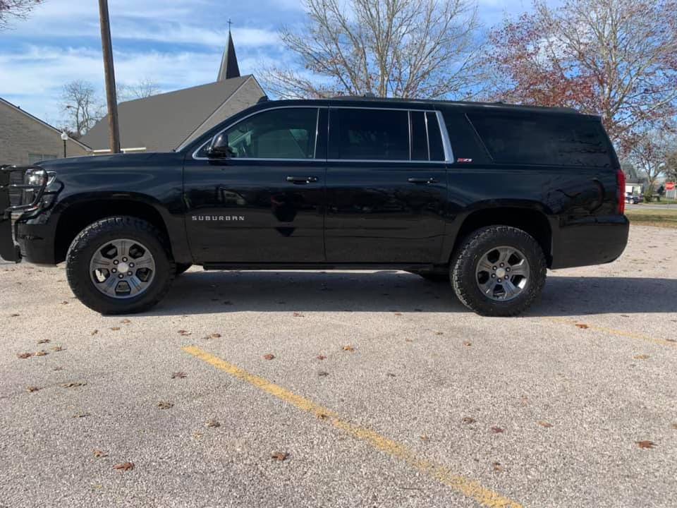

TechRev
Aug 27, 2022
I'll oblige. Here you go.
