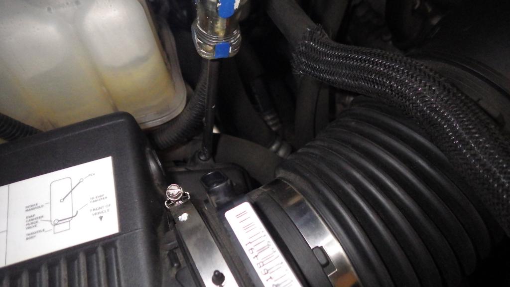

There are only a few places to take loose to get your MAF out. The electrical connection, where the top of the air box comes off (where you get to your air filter) and the two hose clamps.

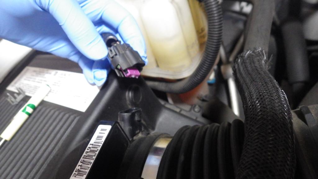

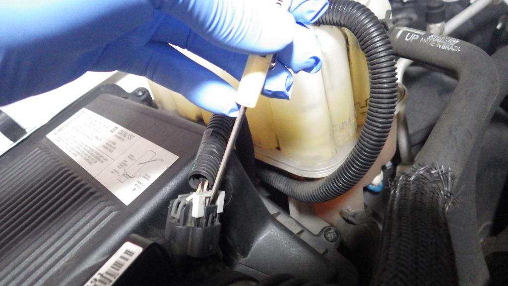

To take the electrical connection off, first pry out the lock clip

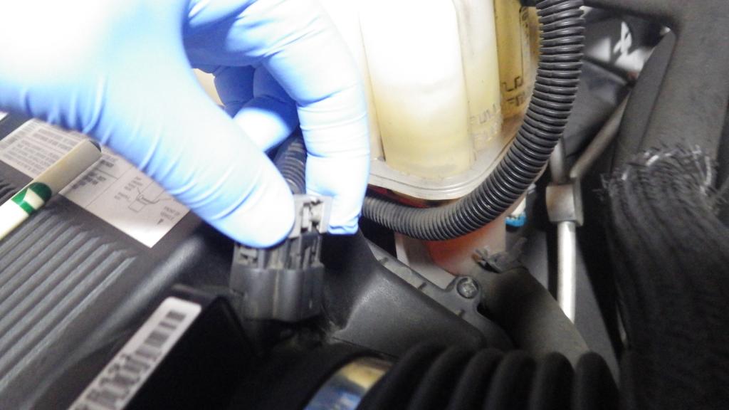

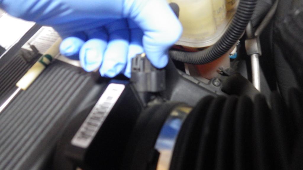

And then press the release on the electrical connector and remove from MAF.

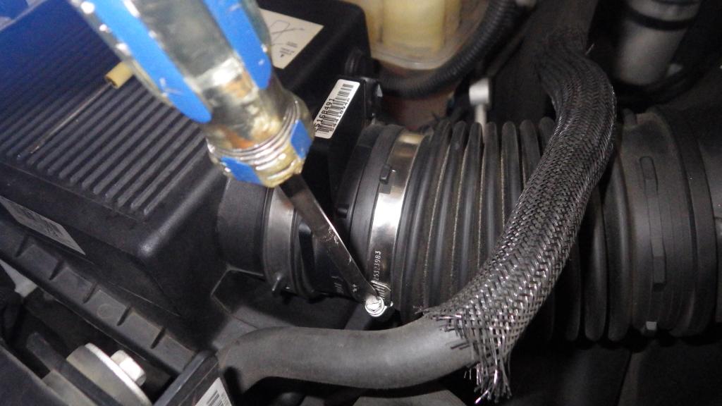

Take the hose clamp connections loose:
And the air box cover - 4 screws:

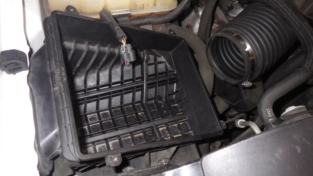

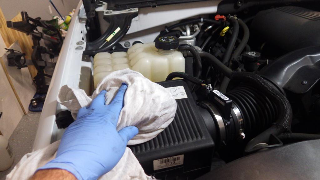

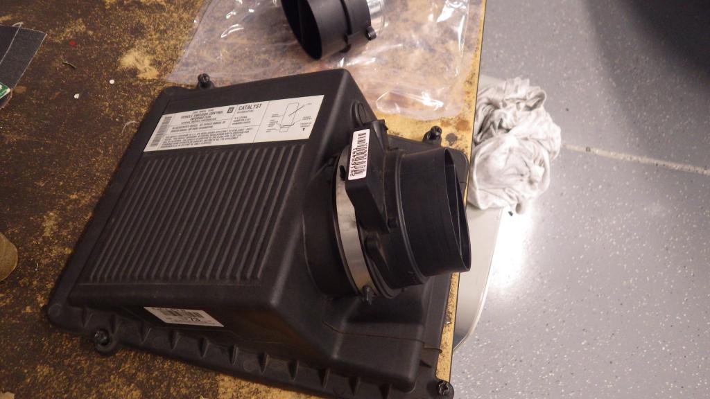

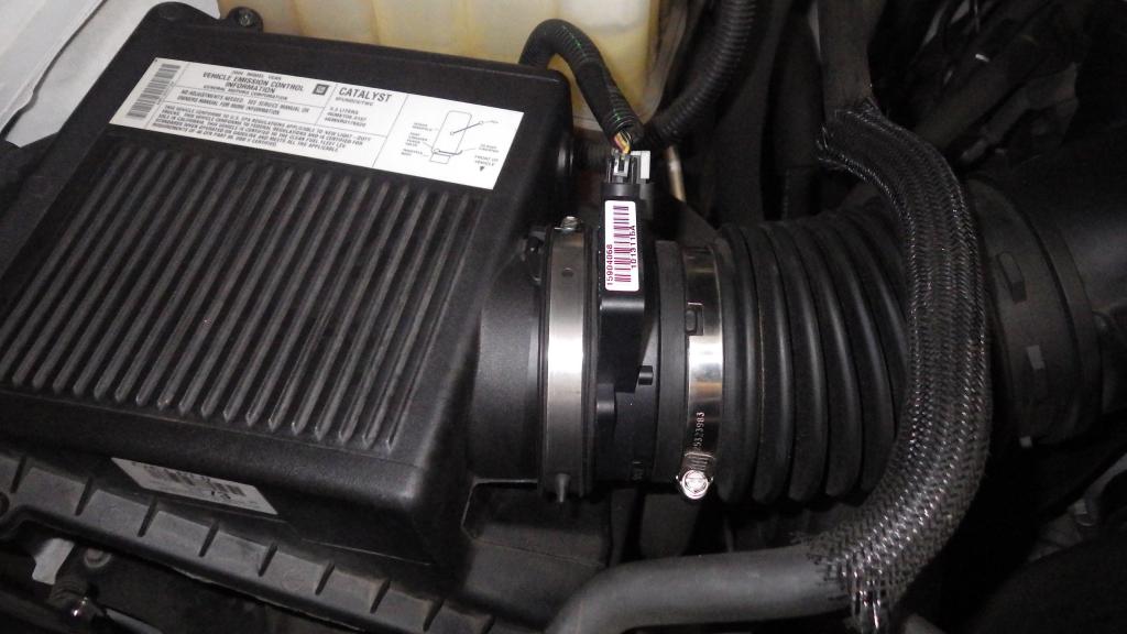

Take off the air box cover with MAF attached. Make sure your air box is clean – use a rag and some simple green or a shop vac if handy.
MAF still mounted to air box:

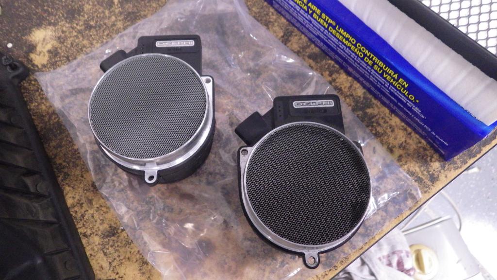

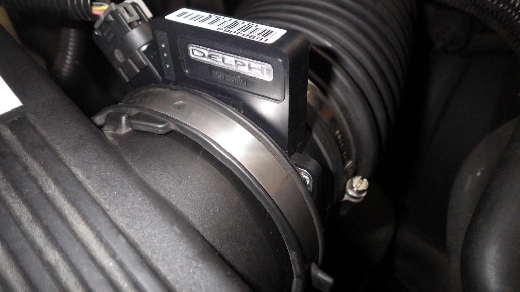

Old and new MAFS:

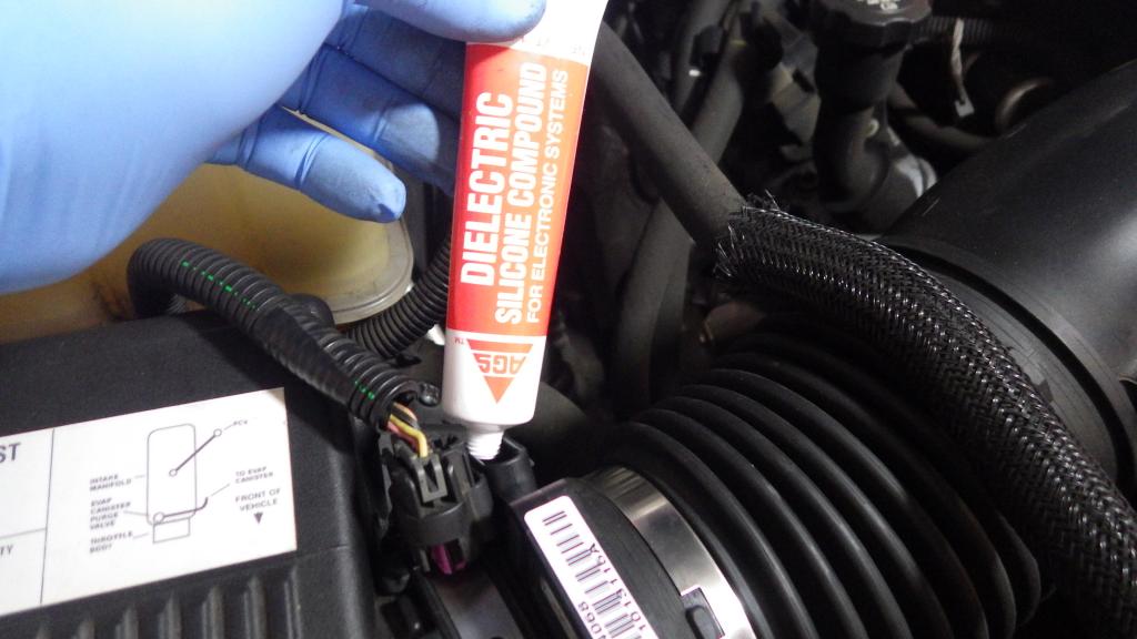

Swap out the MAFs and reassemble. Install your new air filter. Use some silicone grease on electrical connection. It keeps the connector from “freezing” together and it’s recommended for electrical connections.
Wipe down after finish the job.
