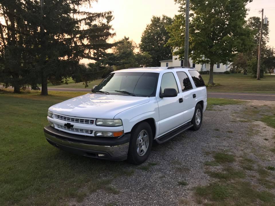

Recently purchased this 2004 Tahoe as a platform to start a new fun project with, and also to do truck stuff :-D.
I'm still learning about the truck, but this is what it has, to the best of my current understanding.

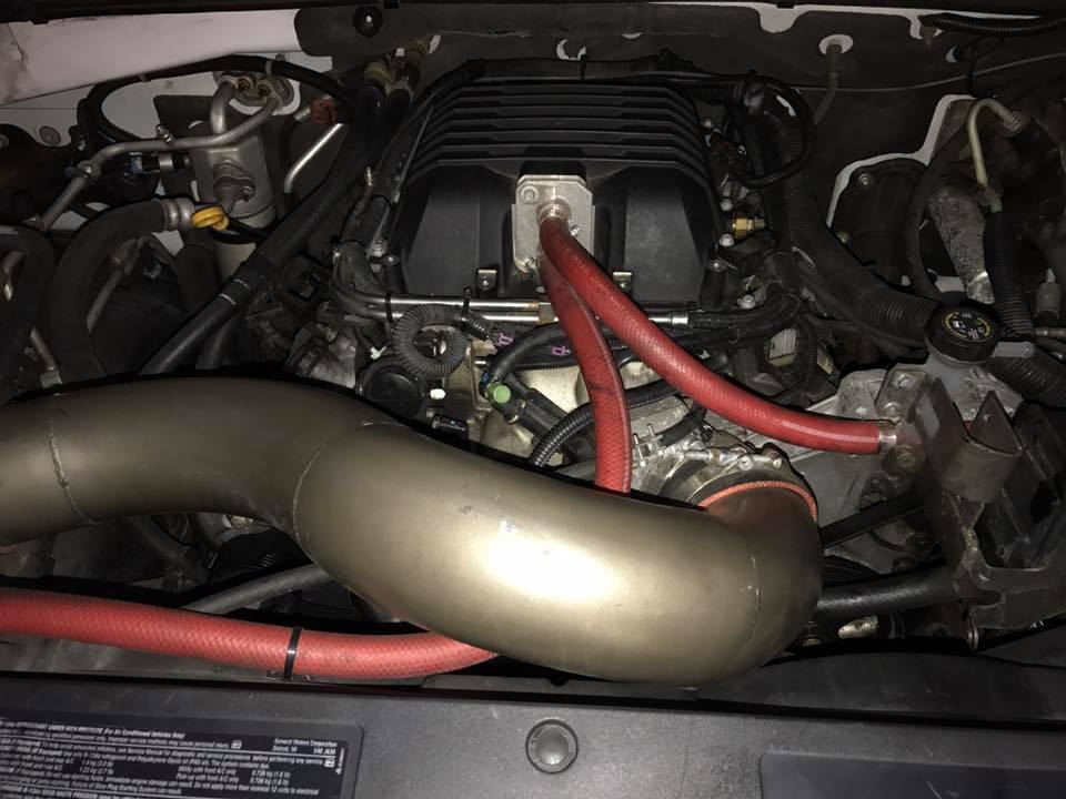

The motor has been swapped. there is a 6.0L out of a van, recently rebuilt. LS3 heads, LS9 injectors, LS9 supercharger with LSA lid and stock pulley. Stock PCM tuned with HP tuners. I have forgotten the cam specs, but I was told it was a Lingenfelter cam with specs very similar to a stock LS9 cam. Stock airbox is very quiet.
The truck has been lowered and has some stiffer shocks, but it all seems to work and nothing rubs or rattles.

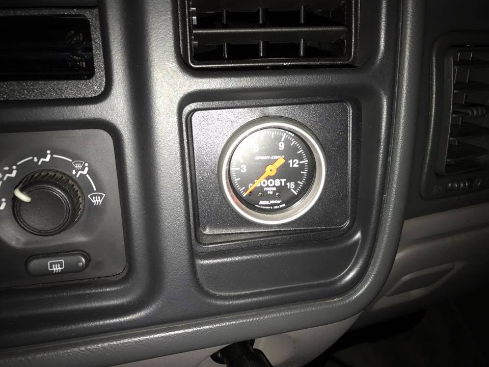

Motor is 9.6 to 1 and the stock pulley is only giving me 7 PSI. would like to see 10, but will be talking to Speed Inc to see what else I may need to do first since I will probably be taking it to them to tune.
Aftercooler is right in the front and works, but the tank is tiny, I may buy an aftermarket one or make one to fit in the second batter spot.
