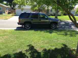

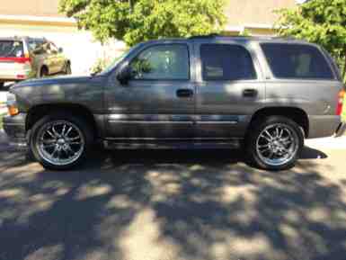

That's what I bought for my 06 2wd. The more you raise the torsion bars, the more it will directly affect the ride quality and the alignment being off. Post a picture of the Tahoe on level ground. A picture of the whole thing. If the tail end if up in the air and the front is low than its stock and you may have weak torsion bars. But if it is all low and pretty much even, than more than likely you have lowering springs in the rear and a lowering torsion key for the front.

ImageUploadedByTapatalk 21368465229.156736.jpgImageUploadedByTapatalk 21368465247.241786.jpg
