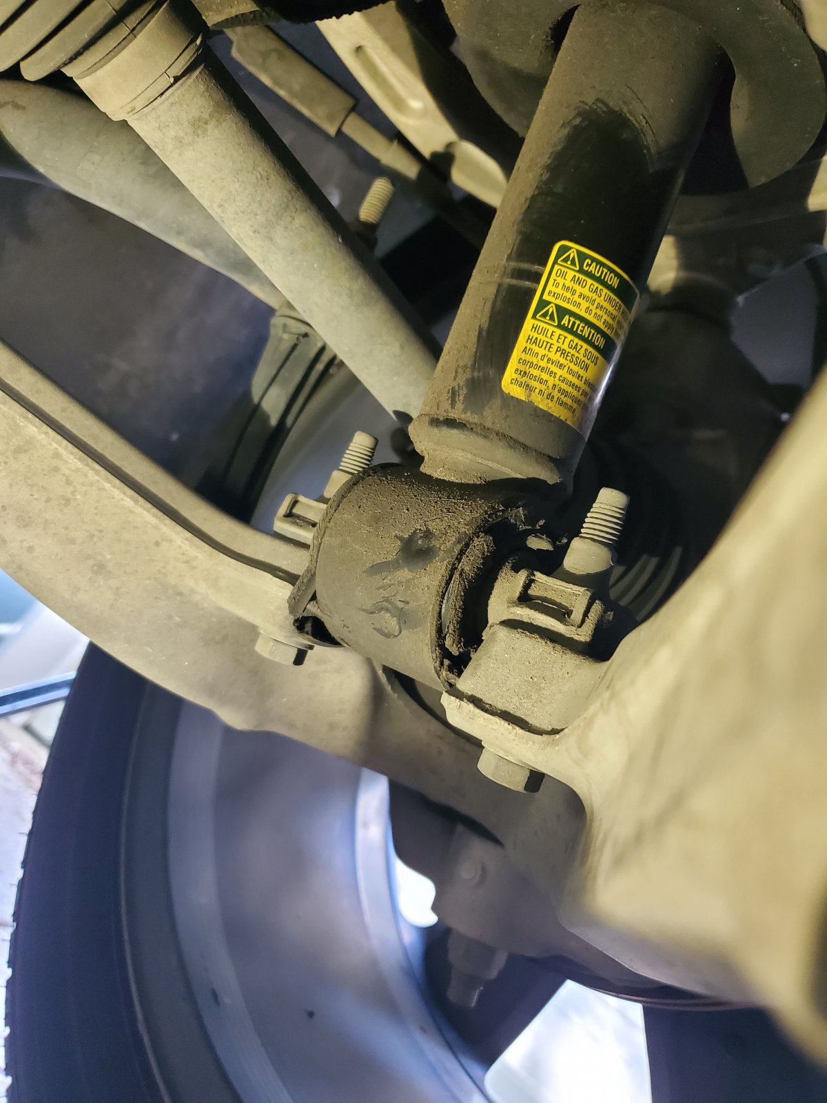

Good morning,
I have had a vibration/wobble in my front end for a while.i thought it was the tires. I needed new tires so i put on new tires but that didn't fix the issue. Its enough to be irritating, but not enough that it's wearing the tires uneven. Can this bushing be causing this(see pic if it will let me upload)? Can i replace just the bushing or do i ha e to replace the whole strut? Everything else on the front end is tight and looks good upon visual inspection. This is the only thing that looks/feels out of the norm. Thank you.

the "shock" portion of the strut can be replaced, no need to replace the entire strut. On the 07-14 they have been known to start going out around 80k-100k, on the 15+ they have been reported going out sooner I have seen some reports as low as 45k-65k

Ok great. Is that a hard job? Any videos on it? And is it hard to find the 'shock' from the part number on the strut
