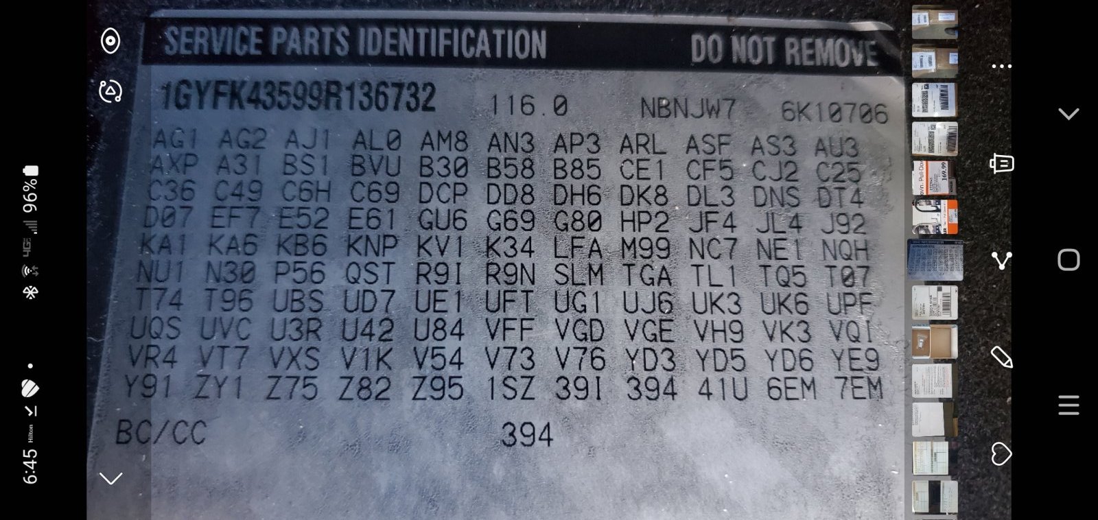

I found it! Problem is the service parts ID tag says is BC/CC but no numbers or letters after it. It's probably one of the many codes on the tag. Does anyone know how to read the tag for the paint code? The Escalade is black but there's likely several shades they used. Thanks for any help with this.

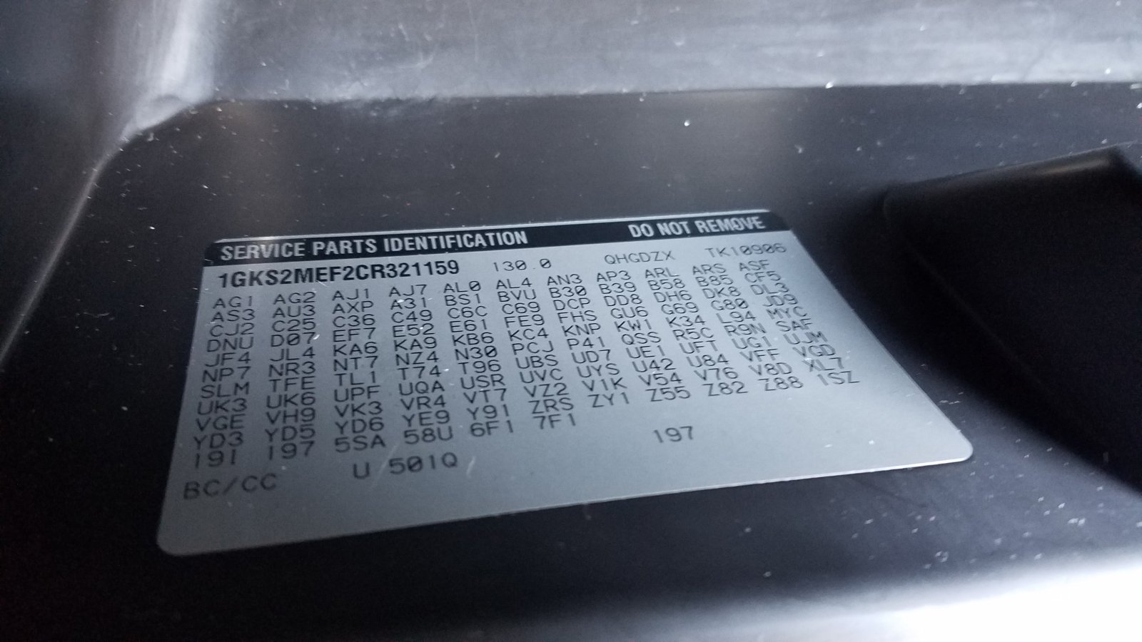

Usually one of the last codes near the bottom of the RPO sticker in the glove box.
Here's a pic of mine. Paint code is 501Q

Very helpful. Thanks. Finally figured out my paint code is U41. Took a bit of digging online but found an OEM site with it. The code is mixed in with all the others but finally confirmed that's it. Mine says BC/CC but nothing following that. Anyway, thanks for helping me with this.
Correction. The paint code is 41U.
