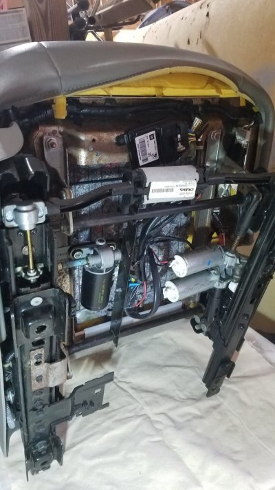

Pictures as I progressed along, as I was taking it apart it seemed like a lot of wires, when I put it all back together it felt like only a couple wires. It's like driving to a place you never been to, seems to take forever then on the way home it flies by.

Just disconnect everything and take your time, also the seat front was pulled off not sure if someone had replaced that seat bottom in the past or not.
