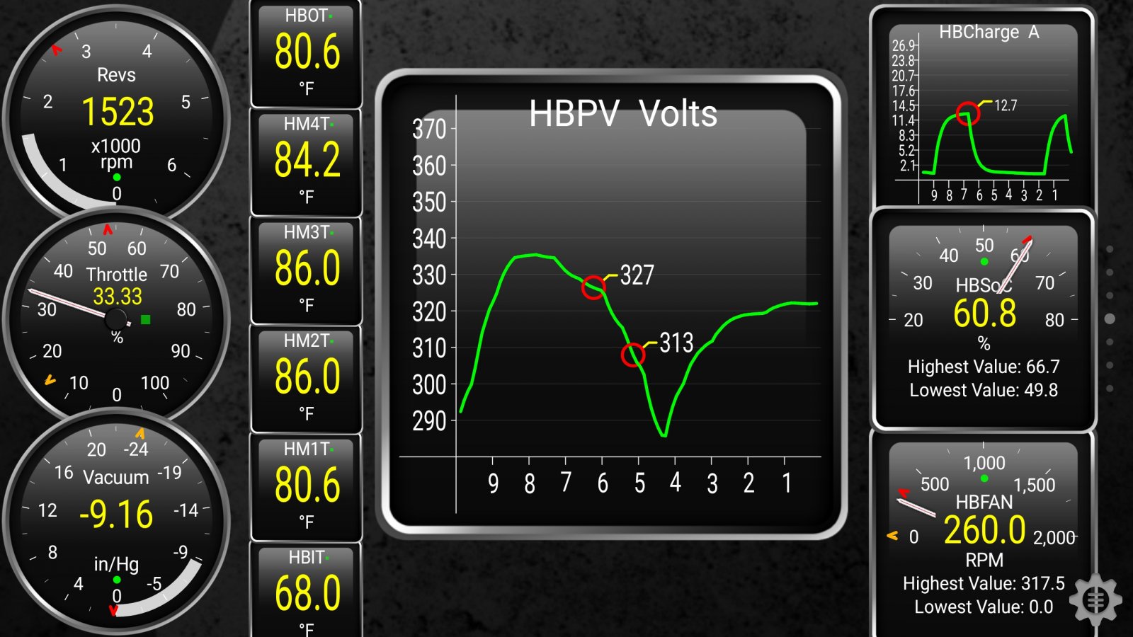

if you're into it, I really like having torque app on my phone to watch the hybrid data from time to time. it's just handy and only 5$ for the app, some manually entered PIDs and a 20$ dongle. you do need to be a non apple device for torque app. if you only have apple, there's others you can try and might have the data, but you can't add anything if they don't and of course nothing is cheap with them haha.
