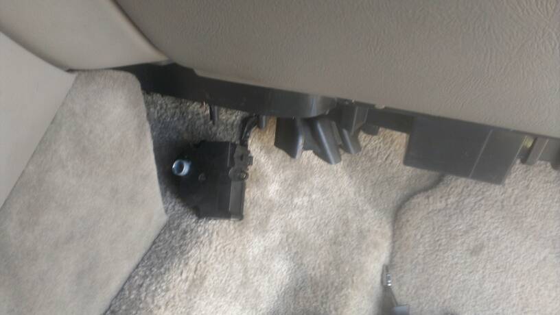

I took this actuator off. I can manually shift it from luke warm to damned hot.

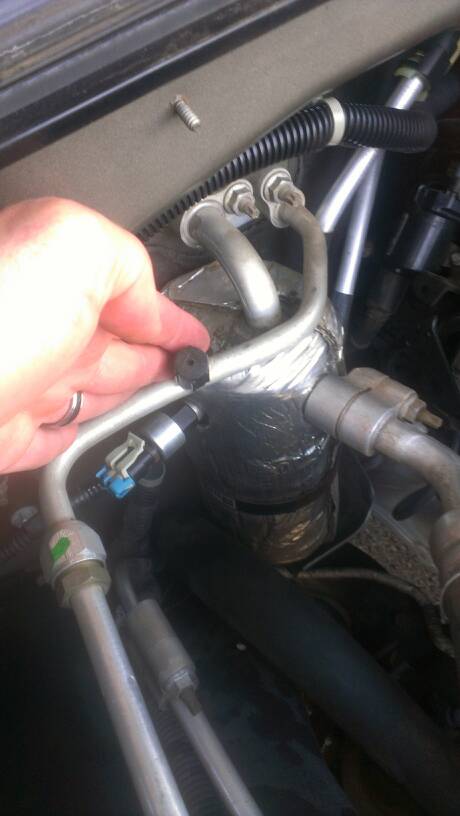

The compressor is working. The lines I'm pointing to are very cold.
What should I check next?

So when I manually move the blend door pictured above I can get 74F in the front and 50F coming out of my vents while it is 86F outside. What would cause a dramatic difference between front and back?
