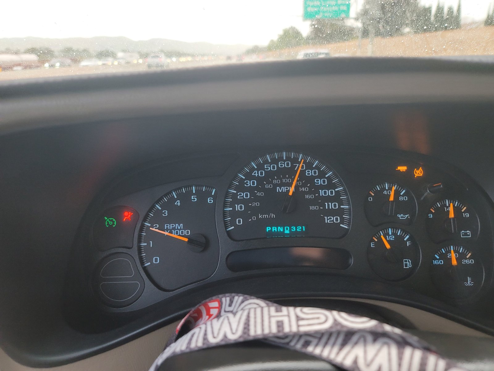

*Truck loses oil pressure, especially after light off roading or going up to mountains (heat?) 10psi
*Rattles on cold/sitting a while startup and takes 10 seconds to build pressure (and up to 30sec after an oil change)
*it will hold 45psi hot/idle for the first couple days after oil change
*valvetrain rattling when the pressure goes down NOT A SENDING UNIT DON'T GIVE ME THAT JUNK
*I KNOW the truck has good oil pressure in there somewhere, it truly runs awesome when I'm not getting whipped by oil pressure dilemmas
*checked with Guage everything is accurate
