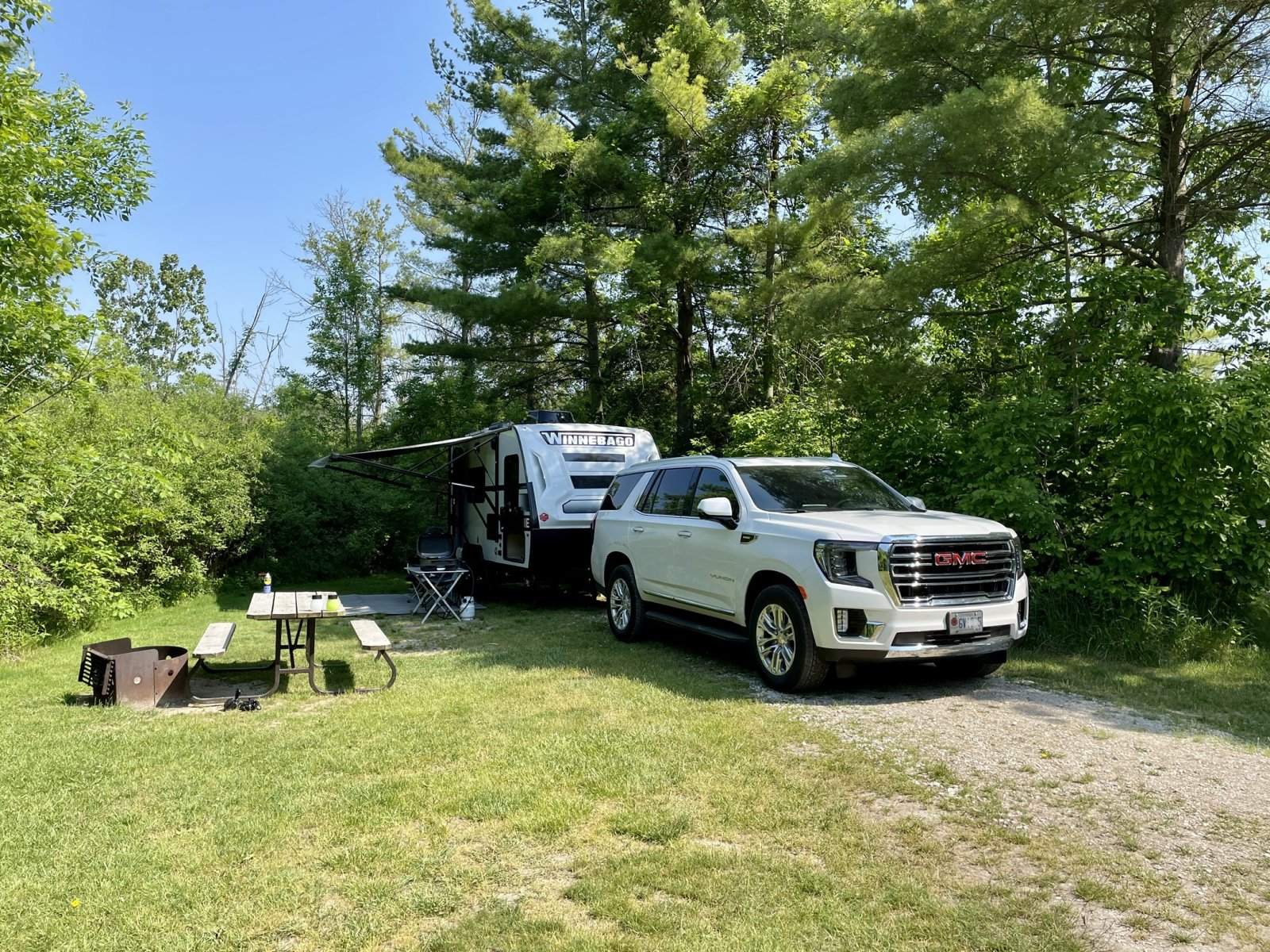

Hi Question about a message on the new truck that keeps popping up after each stop with trailer attached, pull away “Trailer connect” comes back on and then disconnects again at lower speeds.
“Check trailer wiring” did not get it with my 2023 5.3L and same trailer so new Yukon Duramax is suspect
First outing with Duramax/Winnebago.
Plug pinout I checked out, all working, could this be software?
Will drop at dealer somtime next week offcourse but pulled the TRL BATT fuse and seems to make a difference, connects right away in campground.
