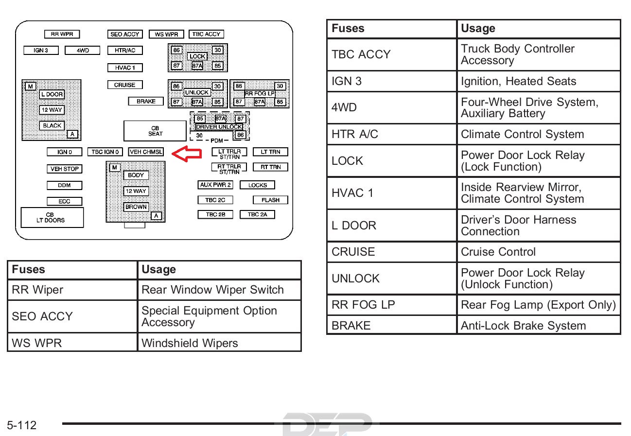

If the CHMSL stands for "Chassis mount stop light". Aren't they all chassis mount? Please break down the CHMSL, thanks.
