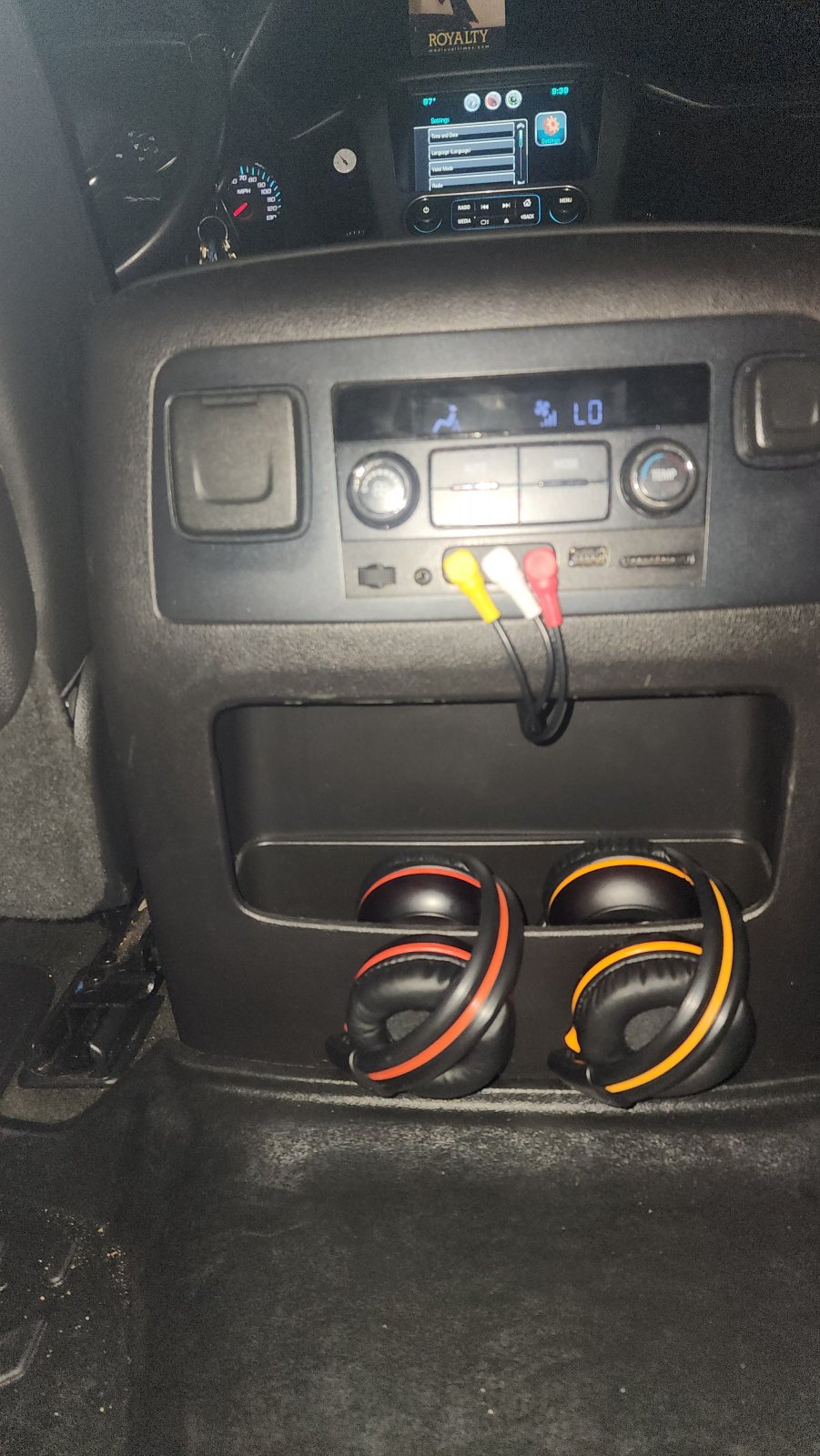

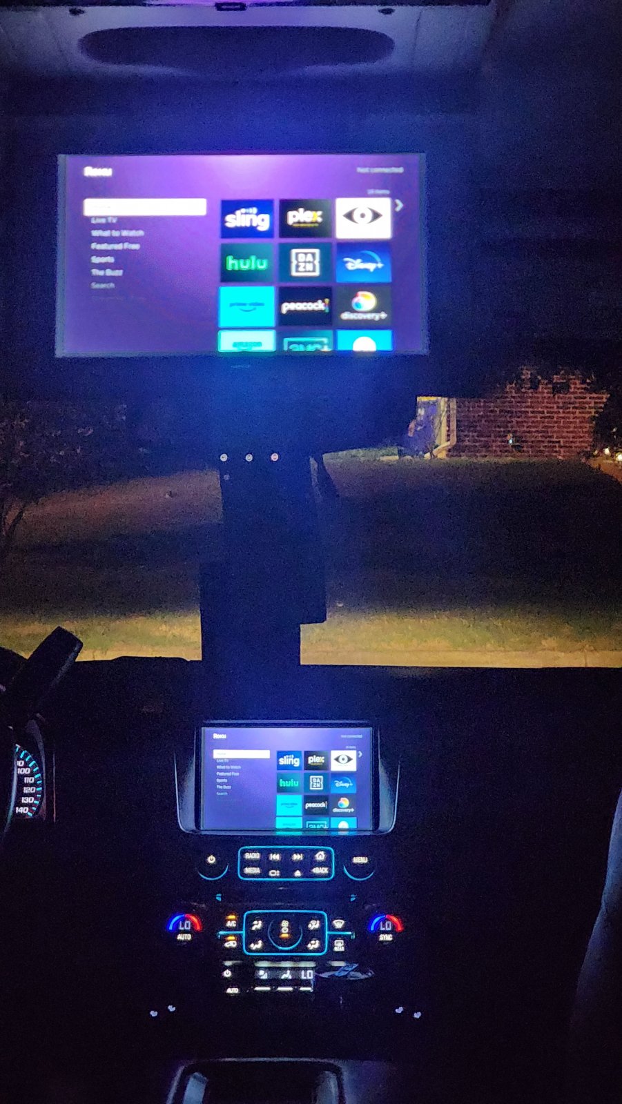

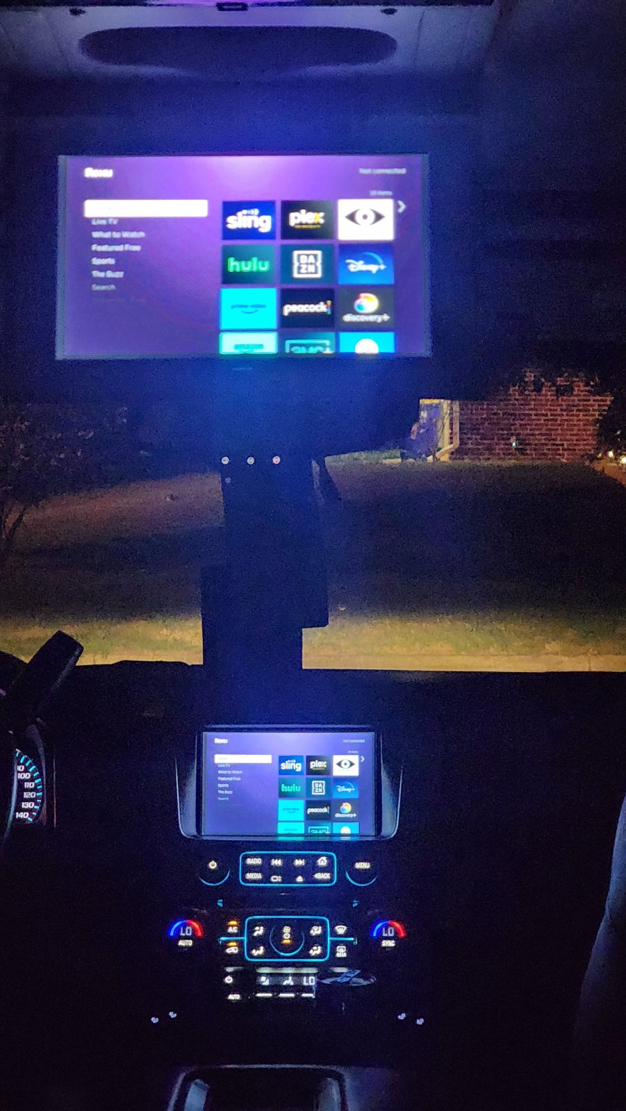

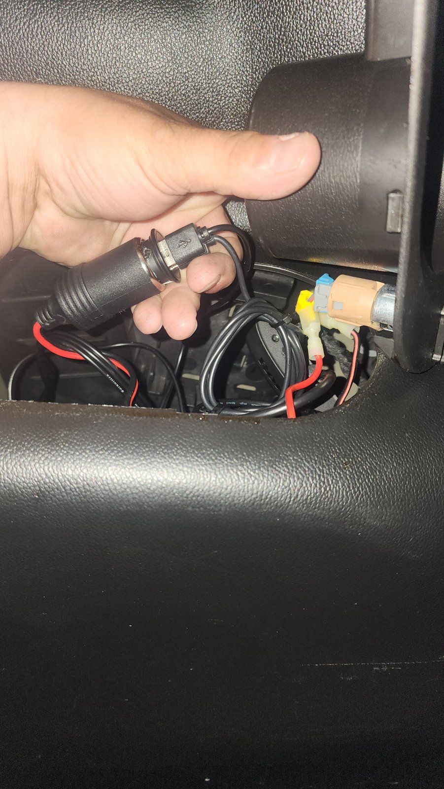

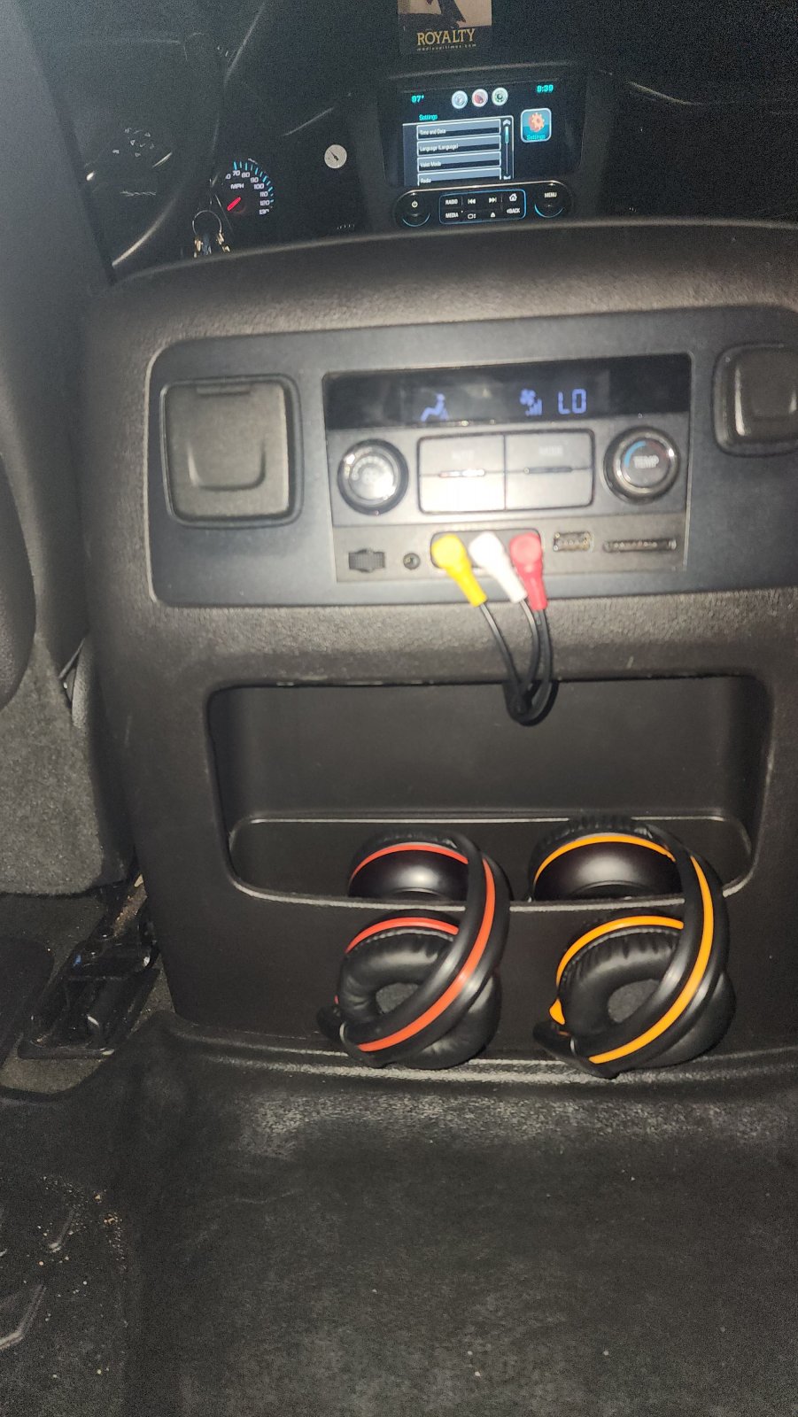

I ended up putting a Roku 4k with HDMI to component adapter in the rear. Drilled a hole at the top of the console pocket than ran component cable into and behind the rear console panel/pocket and under the carpet and back up the inside of the third row plastic panel where the cupholder is with the 12v cigarette plug. I wired an additional cigarette plug in to the wires of that plug but below the cupholder where I just plugged in a 12volt USB plug that the Roku and converter plug into.
Pretty clean install I think. Kid loves having the Roku in there. I also think it's pretty neat. It connects to my phones hotspot. I got the Roku 4k version that comes with the "point anywhere" remote so I could hide the Roku. Works pretty well over all. Only real complaint are the screens themselves seem fuzzy in general. Whether it's the Roku, backup camera or dvd. Definitely not the best of screens and how I found this post looking for an upgrade.
