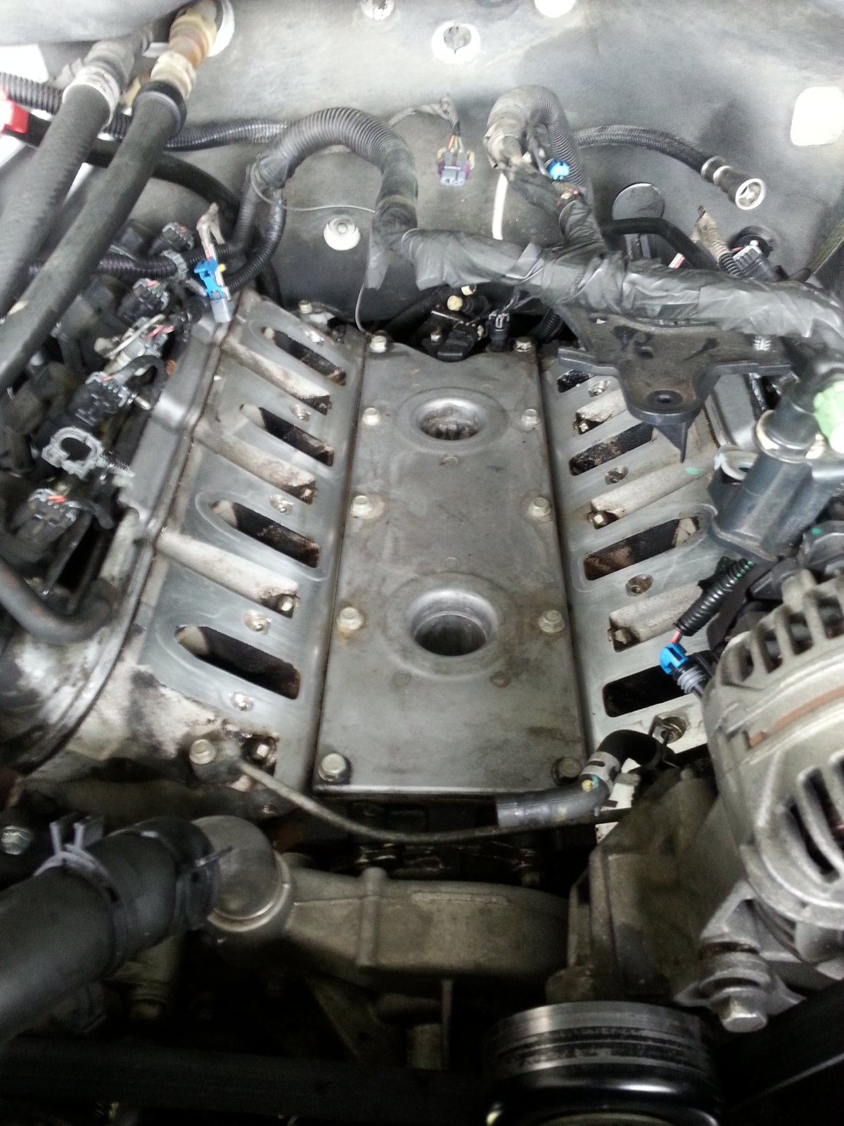

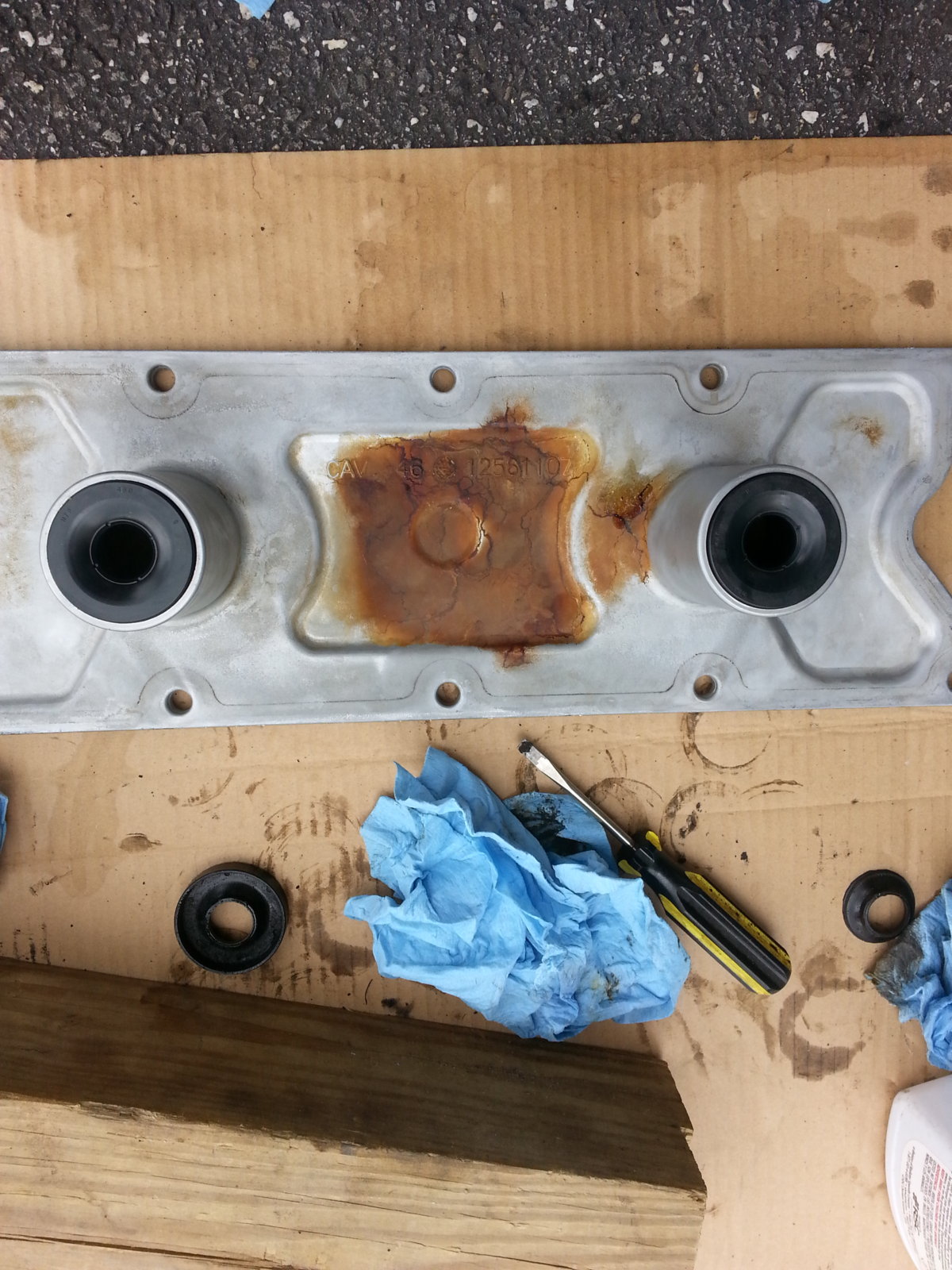

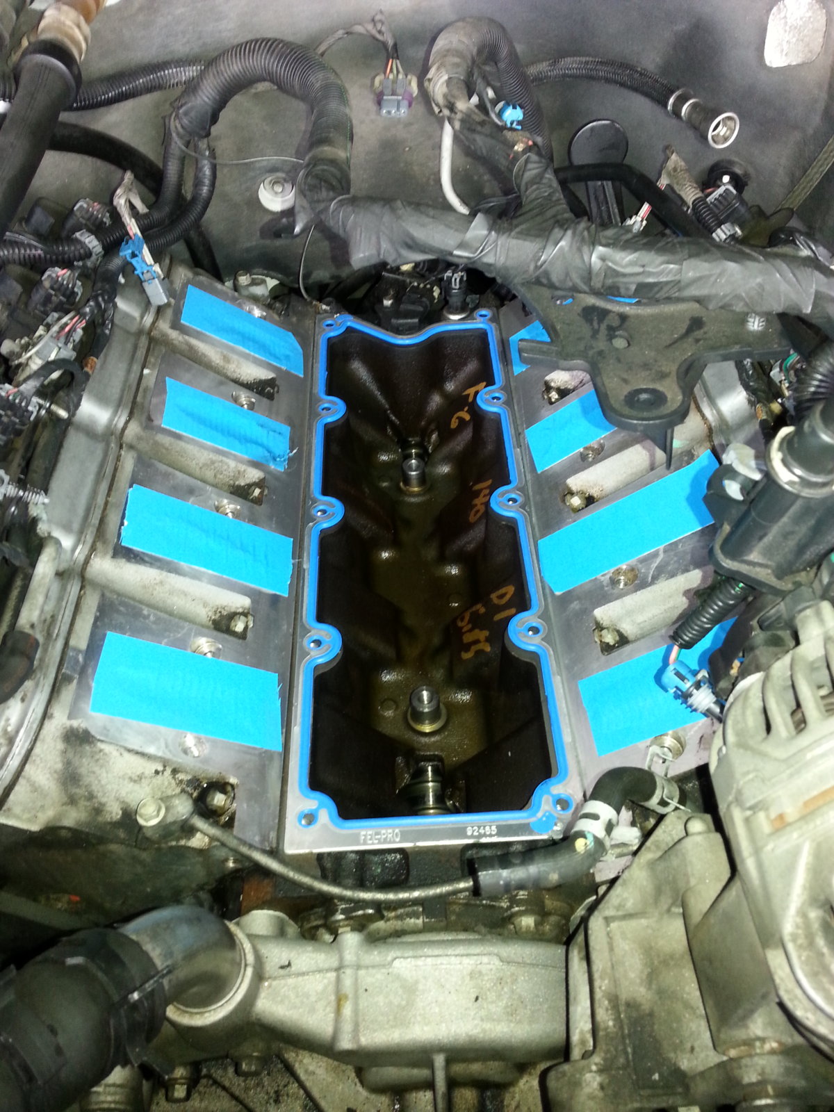

I replaced my knock sensors this spring. Not hard. The real culprit is the harness. The rubber boot shrinks and pops out, exposing the knock sensor to water. i found that out after i cleaned engine then got a ks cel that never goes away. Doh! Glue harness boots down with black rtv. sealing them permanently. Replaced img and removed tb for proper cleaning. Also did the valley pan gasket ang grommets not hard its right there why not
View attachment 184989 View attachment 184990 View attachment 184991
You don't really need to "seal" them with rtv, more like building a half moon "dam" to send water to the sides of the valley instead. Valley cover gasket is a good call.
