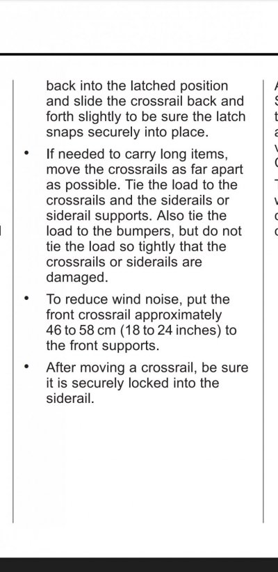

What positions are the cross bars in? The manual states that they may make noise from the wind if they're not positioned 18"-24" from the front/rear.

thats interesting. i think its in the farthest forward postion. as a temporary solution i actually have it latched crooked. one side farther forward than the other. it is then in a bit of a bind and does not rattle.
tommorow i have a road trip to go see a client. i will see how far back they are before i head out
