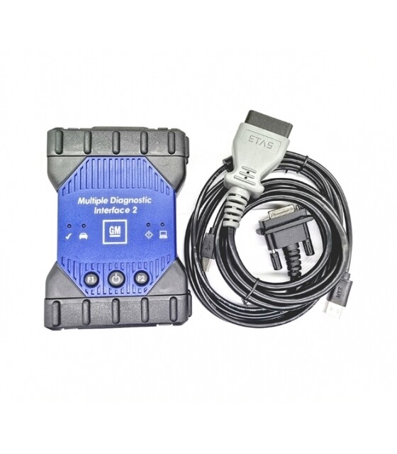

I actually did it l, it requires setup though techline connect, I bought a ACDELCO TDS SPS subscription for my vin for 2 years, you can get an MDI from Amazon but the Bosch one also works. A dealer should be able to do it if you pay there fee.

Awesome! Did you buy the MDI 2 for this job or already have one?

Awesome!! Bradac, did you buy MDI2? Because I am looking at that, and the price was $1,475:(
Clones are available - haven't dug into them too much. There's some videos of them on YouTube. When I get to the point that I really want/need one I will likely go the clone route.

Do you think you can purchase a used cluster and still complete the swap with the programming tools you purchased? Or do you have to get the new $750 cluster listed above?

Thank you for your kindly reply, Stephen.
I found this one way cheaper. I could go with that
