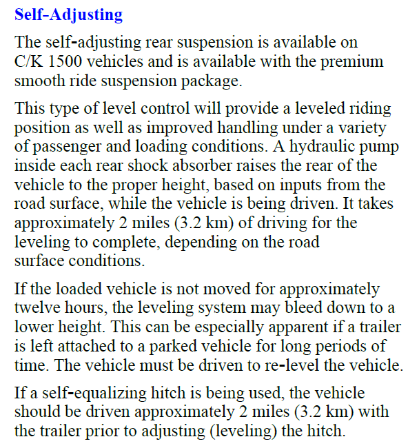

Thank you for the info ! Yes I wan to get rid of compressor and air ride. I think I would prefer option 1. So I do have some questions. The zw7 is a RPO code? The self leveling shocks will adjust by them selfs driving down the road a few miles? Nothing else is needing for them to do this?

You say that, but wait until you see the prices of those Nivomats. They are just as expensive, or more so, than the Z55/Z95 Air Ride.

I personally would go back to a Z55 shock, without the electric pieces in it. Than replace the Air Compressor with a Dorman 949-099 (one of the only time you will see a Dorman part being recommended).
