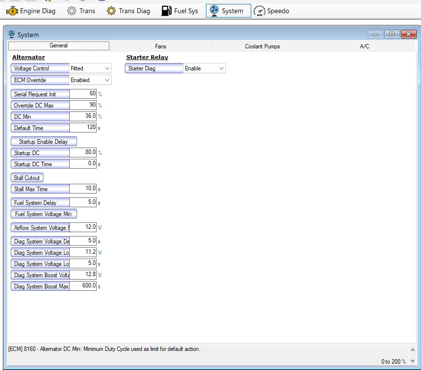

I see a document (MC-10113591-9999) showing "voltage reduction calibrations (to account for extra electronics)" for PPVs.
What do you PPV/SSV owners notice for minimum and maximum voltages?
For my standard non-PPV tahoe, the minimum alternator duty cycle is set to 36%.. ~12.5 volts.
Maximum set to 90% which should be 15.5V. There are a handful of other settings, like boost max time 600 seconds, and minimum voltage required to trigger diagnostic boost set to 11.2V, while minimum voltage required for diagnostic system is 12.8V.
Could be they have sensitive electronics and don't want such high voltages. Or they have so much electric load that a higher minimum will help with voltage drops as things are turned on?
