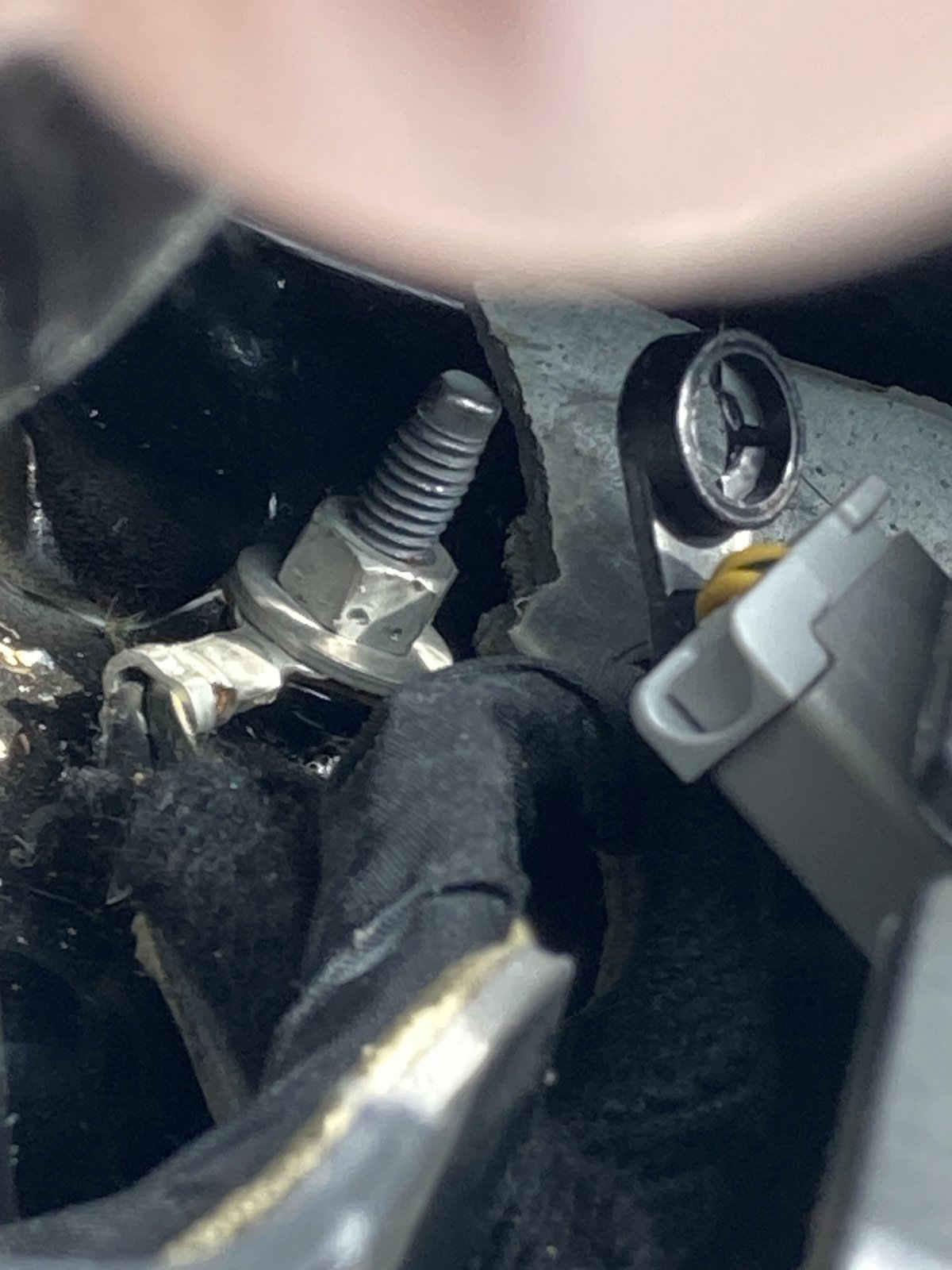

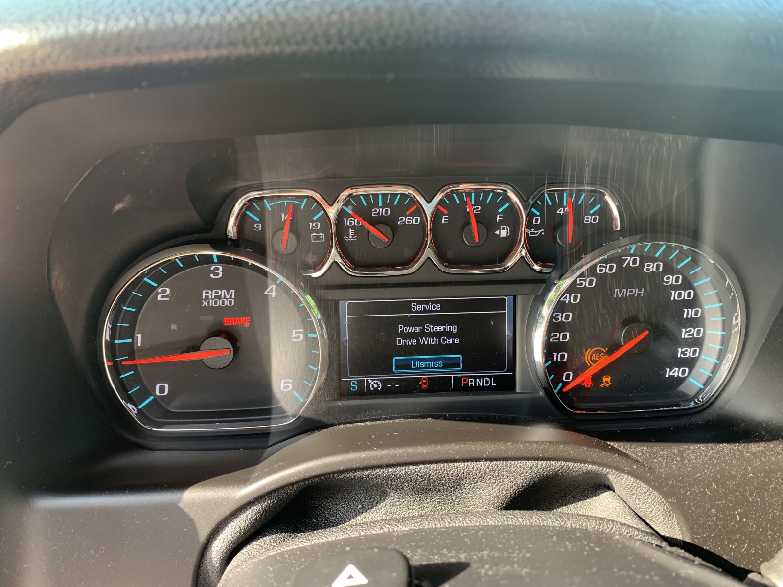

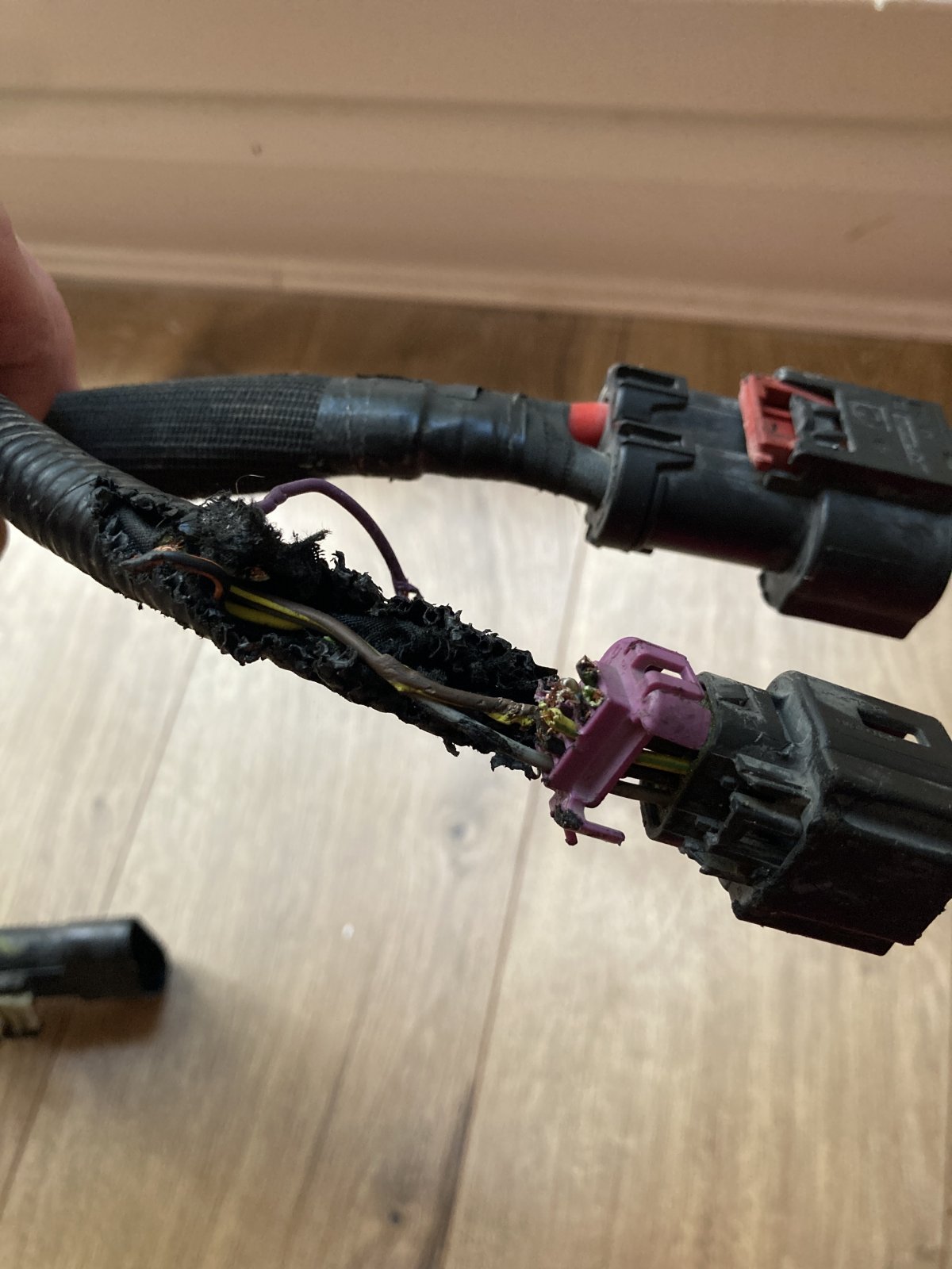

2017 Yukon SLT XL Drove to ocean with my family and after couple of days came back. It was heavy rain not sure if it matters. I recently replaced both tail lights and put new bearing on the driver side. And today this. Any thoughts? I checked ground under the dashboard and looks good to me.

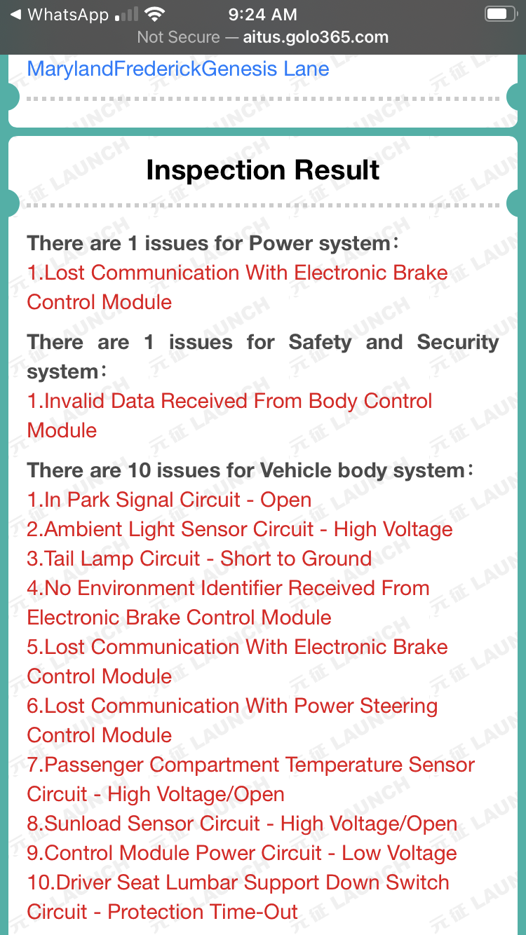

I got OBD2 and run diagnostic. No error codes.
