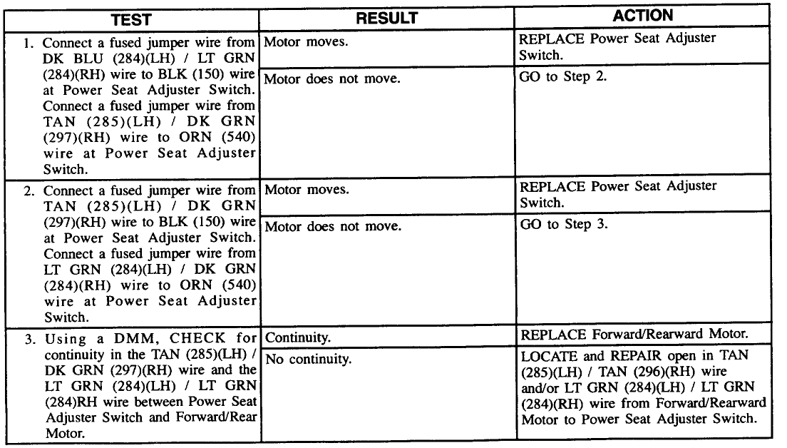

Here are the diagnostics for a 1998, it's probably the same for 1995, no guarantees though. Hope it helps.

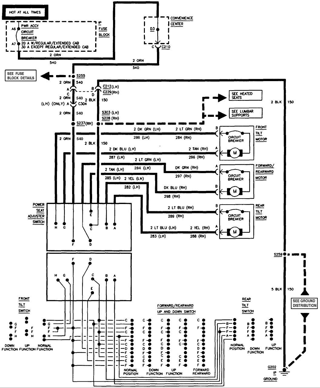

I did not switch the switches. I pulled the whole she-bang out of my truck and replaced it with a whole one pulled out of a 1996 K1500 extended cab. My passenger seat wasn't doing the easy entry and my Hoe had mismatched front seats so I got a matching set. Plus the tracks were wore out on the original set. I'll have the hubby get into this schematic and drag out the voltmeter and make sure everything is getting power. I can hear the motor try to engage and the up/down motor works for sure. I wonder if I can rob the old up/down motor out of my other seat and replace the front/back motor with it. It works by reverse polarity, correct? Thanks for the reply!

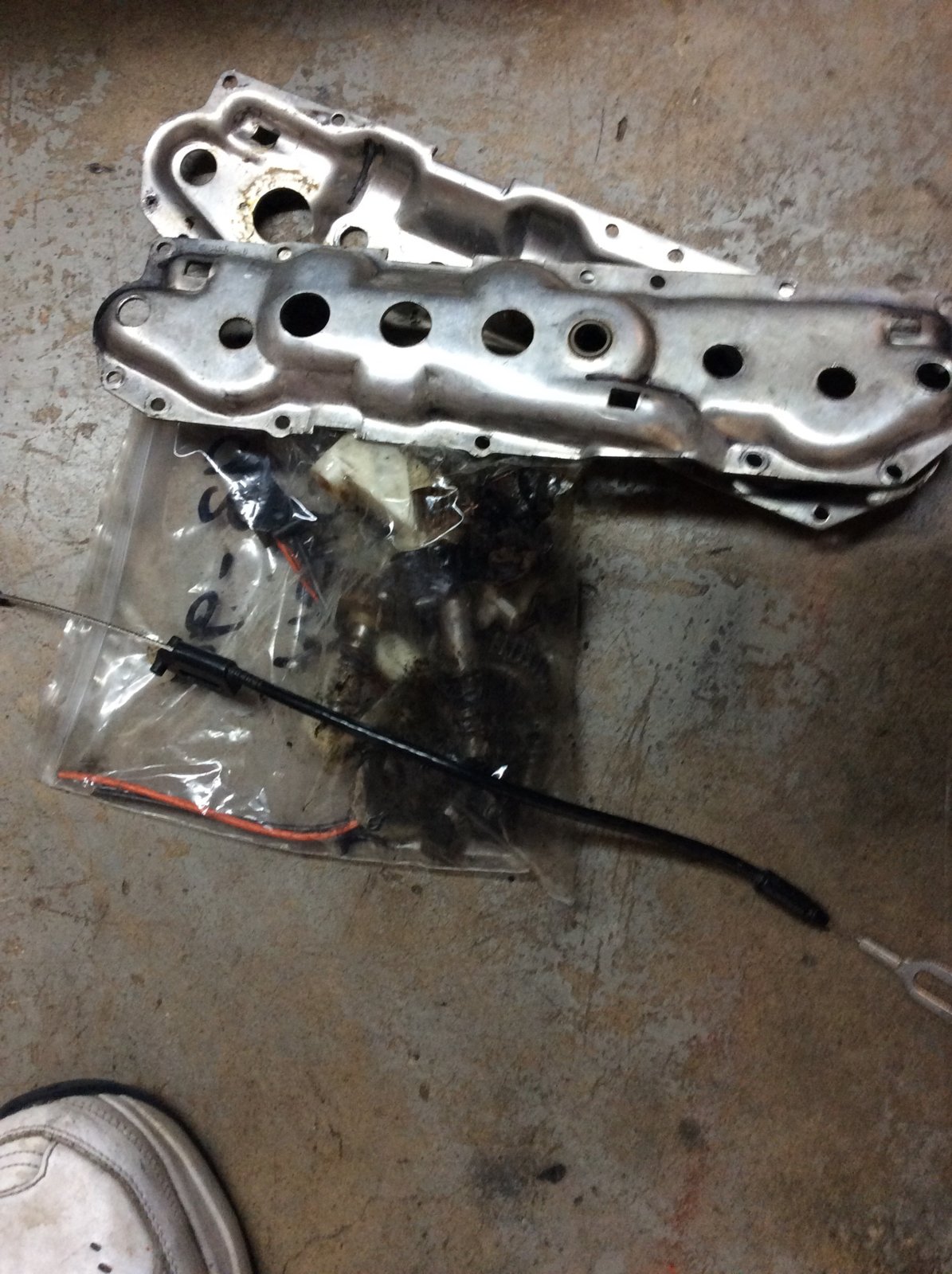

92-96 seat gearbox same also matches some corvettes. Plugs on motor different on some years whole seat had to come apart aluminum gear box drilled out rivets look in side plastic parts broken went to bone yard found another one put two together (caution) a lot of small parts inside. Pop rivet together,fixed it.The easy access seat needs a new cable also found in bone yard a lot of extended cab trucks have them paid 5 bucks for three of them common part to fail Now both seats fixed image.jpg
