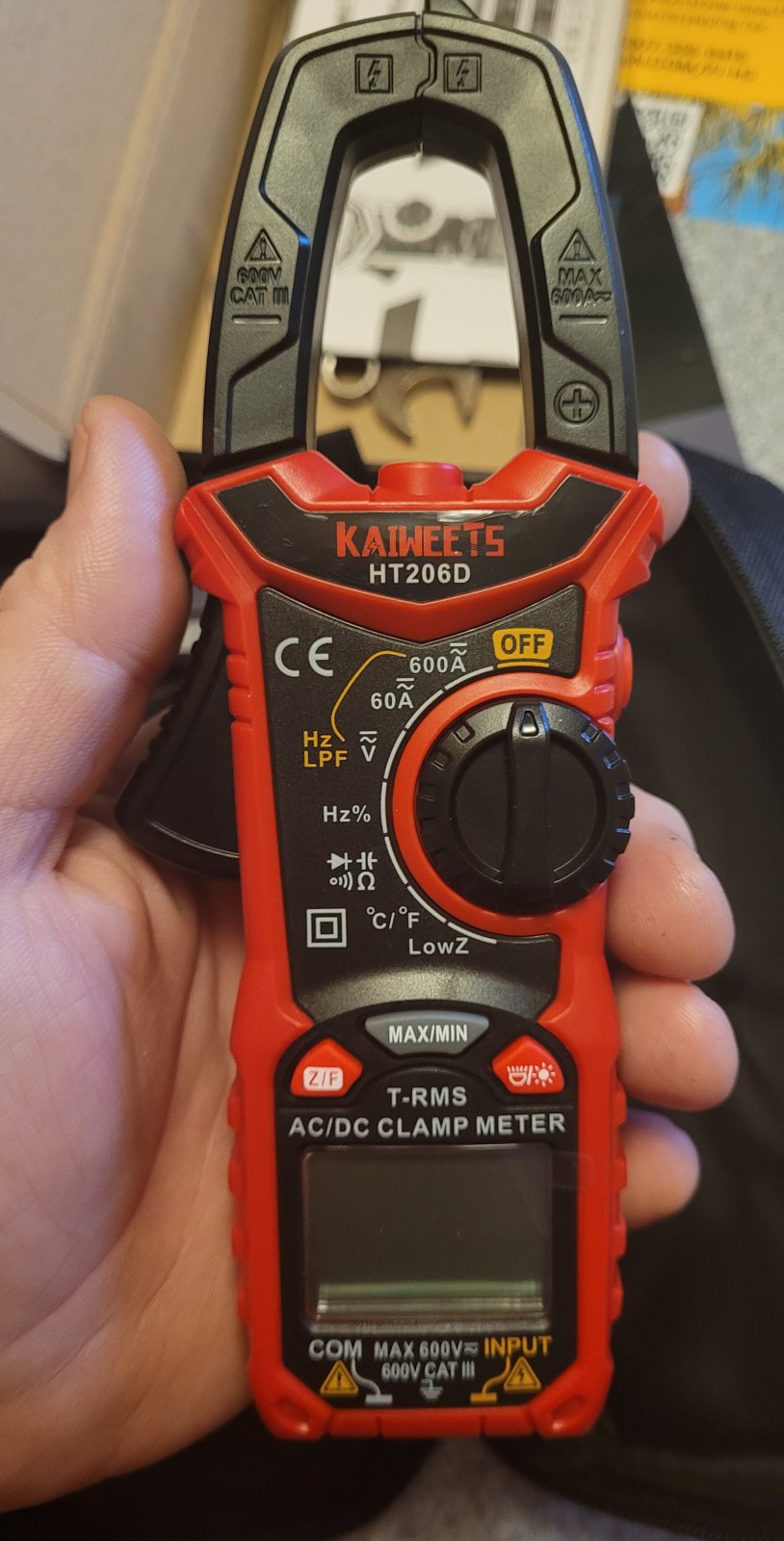

Kaiweets HT206D, I got it off Amazon $45
My knowledge of electrical is basic, power & ground and dose the test light light up lol.
I watched alot of YouTube videos, still not sure of it all.

I wouldn't trust a meter with that large of a jaw opening to be accurate for very low DC current measurements. If the expected current is less than the wired connections will allow (meters vary, usually 5A or 10A fused), using the wired connections would be most accurate. You could verify accuracy by making a wired vs. jaw comparison reading.
