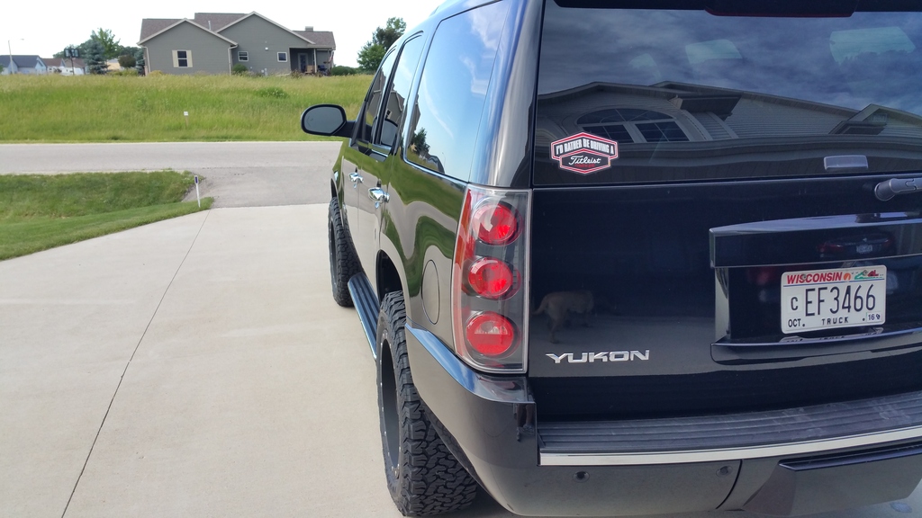

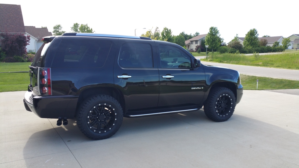

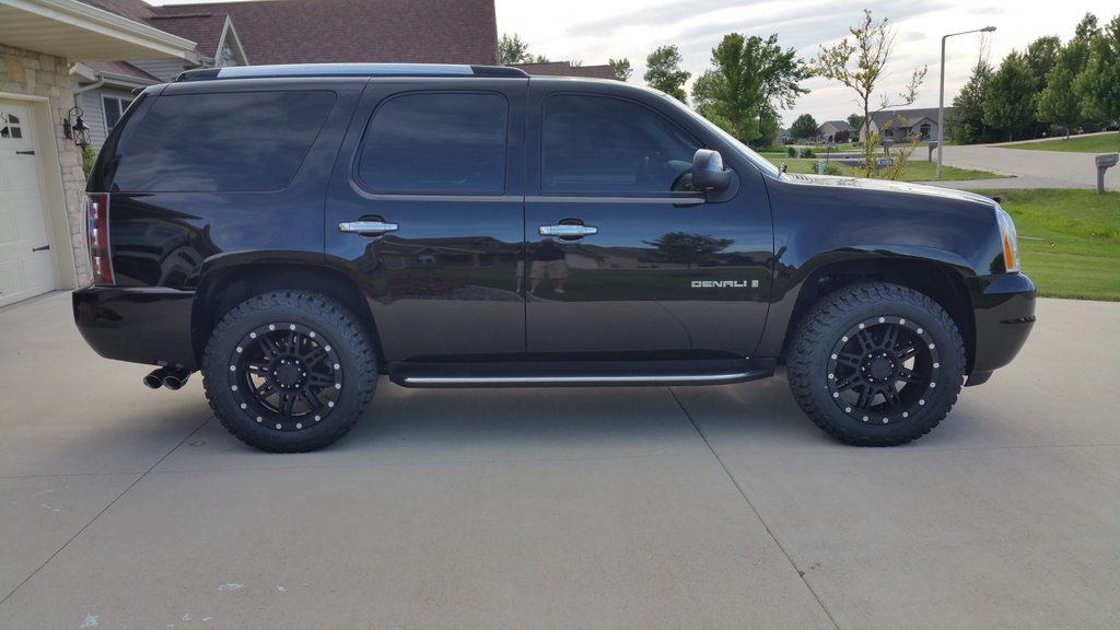

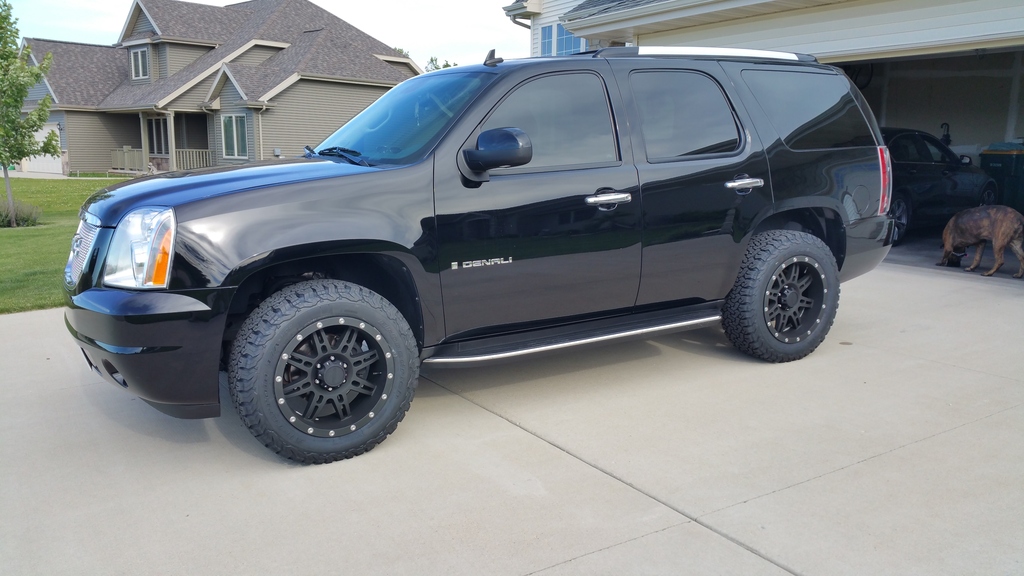

Well, got my wheels and tires on today. Got the front of the wheel wells trimmed up, may need to take off a little bit more towards the outside and have to paint the bolts yet or get some black ones, just used hardware that I had lying around. Ran out of time to do rear. I think the easiest way to get the metal trimmed on the front wheel wells closest to the cabin is to remove the running boards. Want to try to make it not look like a hack job. Tires definitely rub there too when not even turned the whole way. 2" lift installed in front and nothing else. Valance trim is coming too, but that's last, got an Arnott compressor on the way, that's definitely going in this weekend and so are longer rods on the front ride sensors.

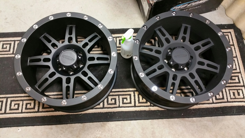

These are 20x9 ProComp 7031 with 0MM offset. They were flat black and a hell of a lot more dull when I pulled them out of the box vs all the pictures I found online. I had some Turtle Wax Ice wax sitting around, the liquid stuff, so I put it in a squirt bottle and gave them a mist and then wiped them down. We'll see how long it lasts, but it was the look I was expecting.
Tires are BFG TA KO2 275 60. Need to get some dressing on them!
Only picked my kid up from school and its been sitting at home, but definitely don't feel the bumps like I did with the 22" wheels, but ride is stiffer due to ride sensor rods not lengthened yet. I still need to discount double check the air pressure, no clue where the dealer set them at and they looked a little soft.
These are just phone pics.

Rims with and without polish:
