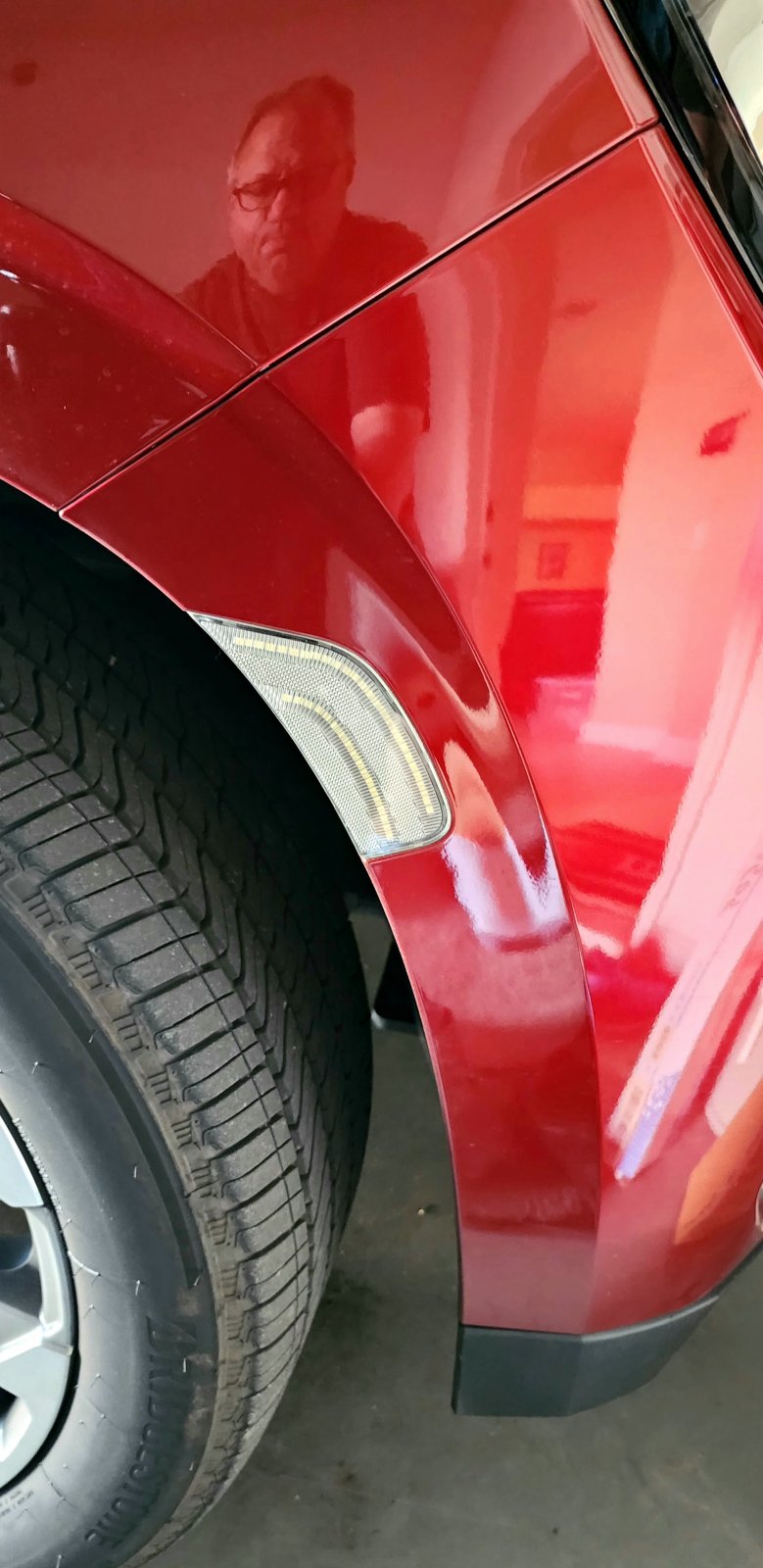

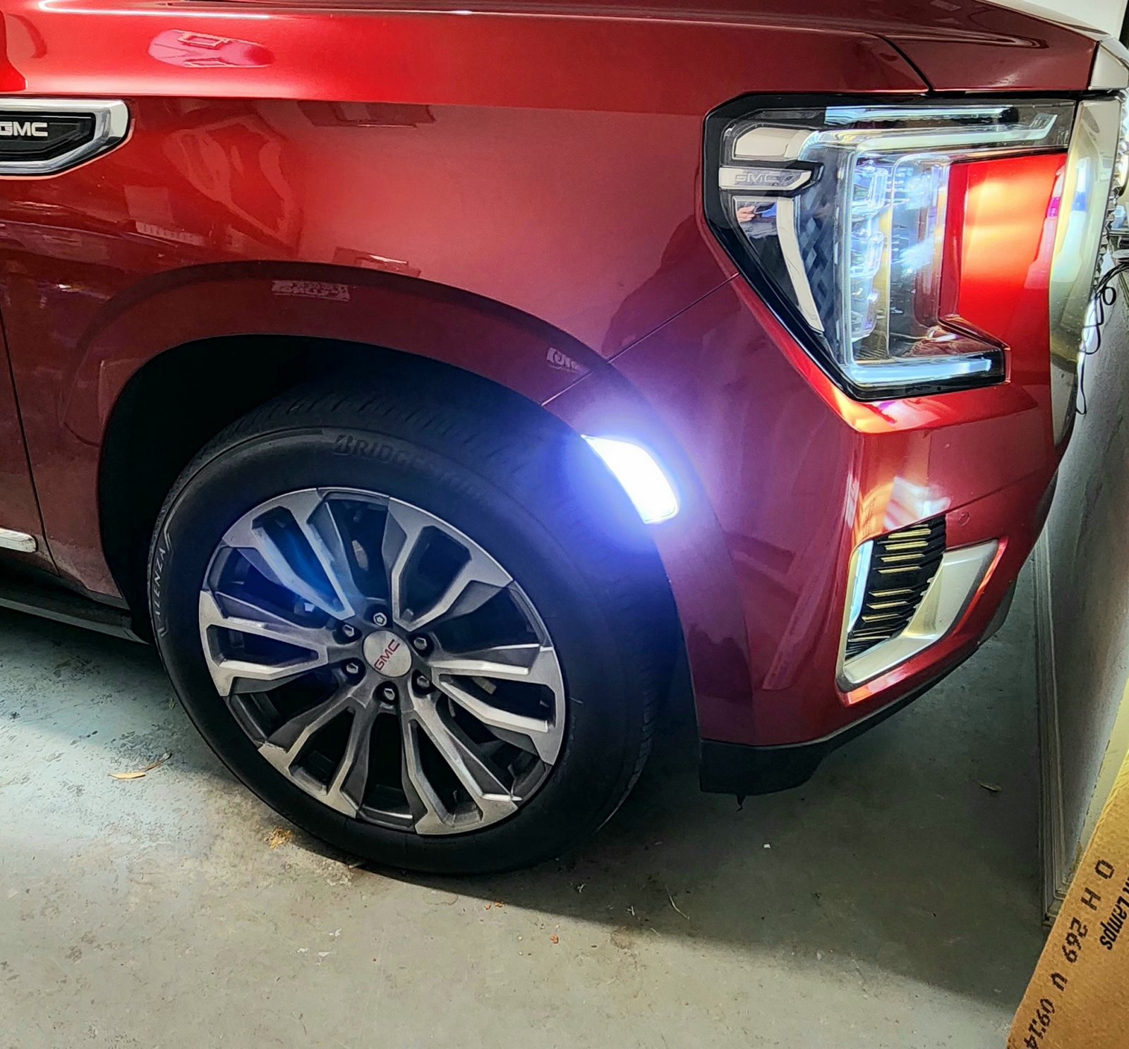

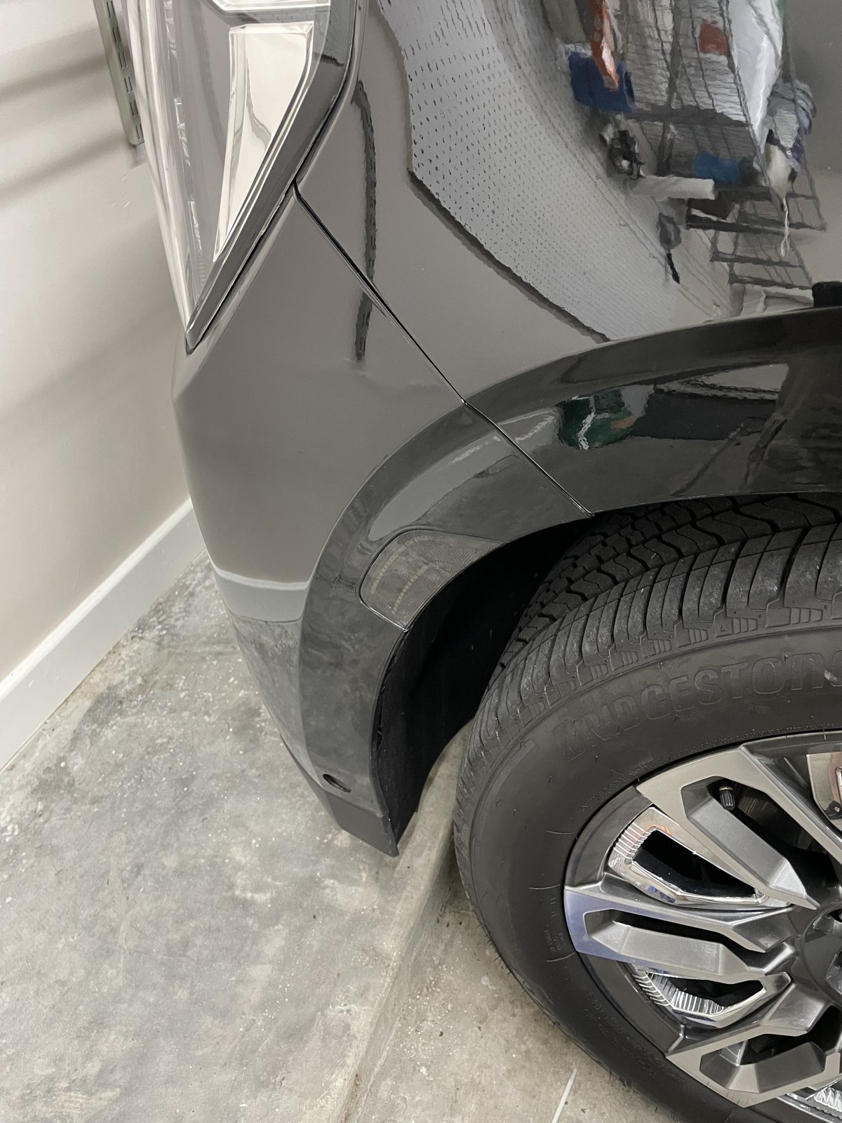

Illegal, at least in my state, and per federal motor vehicle safety standards...Side markers have to be Amber, and must have an ambe reflector in the front of the vehicle visible from the side.
Good job on the install.

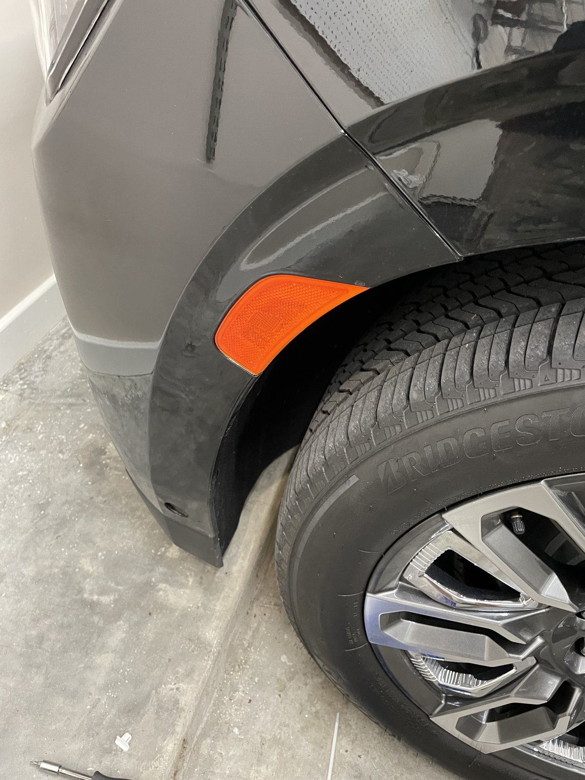

They are amber from the factory....to satisfy the federal motor vehicle safety requirement of an amber light and amber reflector up front on the side. It appears the OP wanted white...and accomplished tha
They are amber from the factory....to satisfy the federal motor vehicle safety requirement of an amber light and amber reflector up front on the side. It appears the OP wanted white...and accomplished that.
I know they're amber from the factory. I asked the OP if his were DIY or used a brand that offered amber.

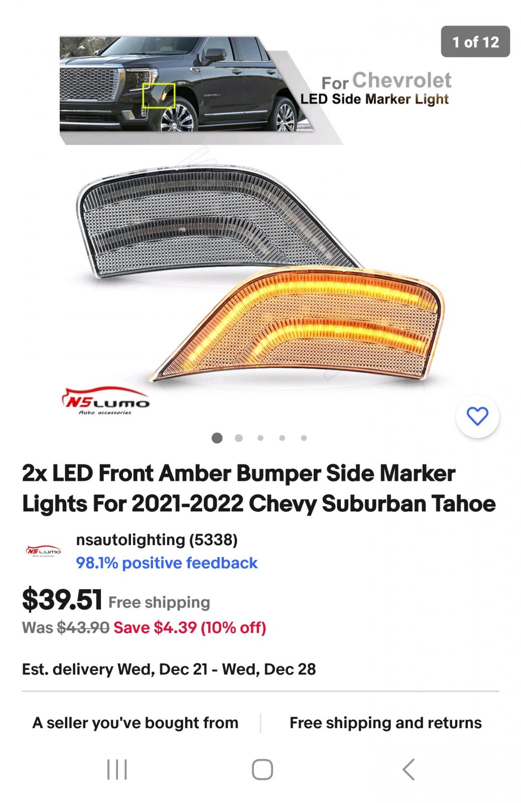

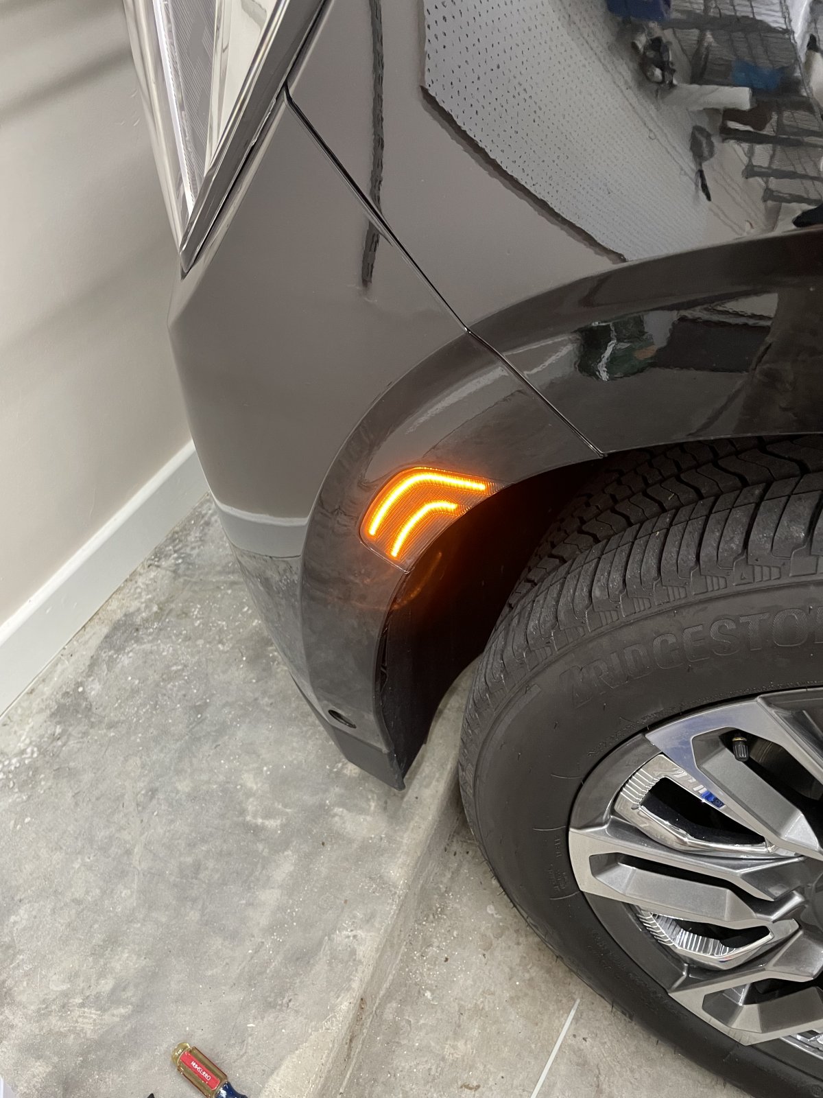

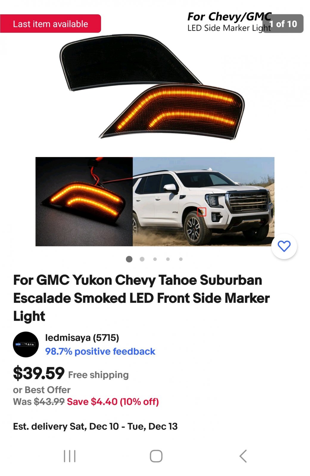

EBAY how ever you want them. They are so bright at night they are like side lights.

Based on my search, even the amber ones still run amok of Federal Motor Vehicle requirements, as they remove the required amber reflector which is mandated to be placed on each side of the vehicle as far forward as pratical...unless you install a different one somewhere meeting the requirements. That fact would also make them a violation in my state. The fact that they are bright may even be an additional issue, but I haven't studied that far into the lighting requirements yet.
That said, if I were passing a vehicle equipped w/ these at night on the freeway and I was in my wife's car, I might not appreciate the equivalent of a headlight shining in my side window...
All good till you get in a severe crash causing injury or worse...but man, they look cool...
