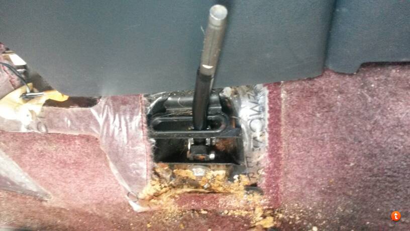

So i picked up a nbs console from a charcoal interior 99 nbs. I plan to clean it up and paint it before installing it in my 'Hoe but there's the ever present issue with the floor mounted 4wd lever... that isn't going to be nearly as much trouble as i originally thought. Here are the pictures with the old console removed and the new one test fit in it's place, no trimming has taken place as of this time. The plan is to use duplicolor NV110 Vinyl spray to match the original burgandy color we'll see how that goes...
Depending on how i mount the console I'm thinking i can swap out the shift arm for the NBS one that's straight, or turn this one 180* and i'll be able to mount the console and still shift, it would be similar to how the denali console fits with the floor shift.
Does anyone know what the part number is for that shifter?

Very nice... I think flipping the lever 180 would do the trick... Mayb even a custom lever longer in length and a greater bend to avoid busting ur knuckles on the nbs console...

I picked up the nbs shifter a few minutes ago I think once I get everything cleand up ill just heat it and bend it over a few degrees

lol Actual Souther Teir Brew is one of my customers and i have a few of their old tap levers sitting around, but i think that would probably send the wrong message to the police were i to be pulled over, I'm definately going to have to bend the 4WD shifter to the left a bit as it hits the console in 4lo, not bad but enough that it will ruin the paint job i'm going to do
