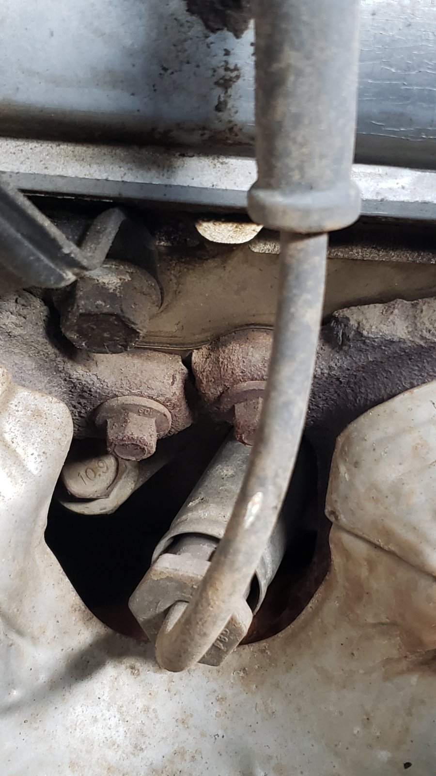

A little background. Yesterday after work I was crawling around under my hood looking for an oil leak since my engine has been kinda slobbering on itself and seemingly dripping a bit onto the exhaust (thinking valve cover gaskets right now). I noticed two broken exhaust manifold bolts on the drivers side (front and rear most) so started thinking that this may be a good time for exhaust upgrades. Today now I looked at the passenger side and the manifold is actually split right in the middle on the flange and looks like its been that way for a while. So I have more justification now for upgrades.
Here's where I'm at now. I know I can buy different style headers or stick with a stock exhaust manifold. I wouldn't mind squeezing a bit extra power out. But this vehicle is also a daily driver so not looking to go crazy. And completely understand that the transmission is likely going to need some work since they don't seem like much power over stock. Regarding exhaust headers, shorties seem like an good upgrade since they would fit in place of the stock manifolds. Long tubes would be better performing but won't be a drop in replacement. I'd do a tune at some point. Maybe a cam swap. And probably not much more than that.

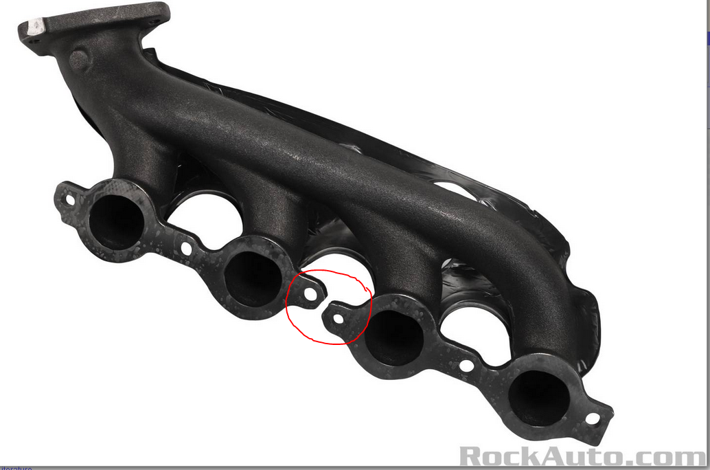

Got news for you, they're made with the split. Not tryin' to ruin your justification, though.
Well look at that :D. I guess this isn't as serious as I was thinking then. Still got broken manifold bolts but since I couldn't see a split on drivers side I figured something was wrong with the passenger side.
