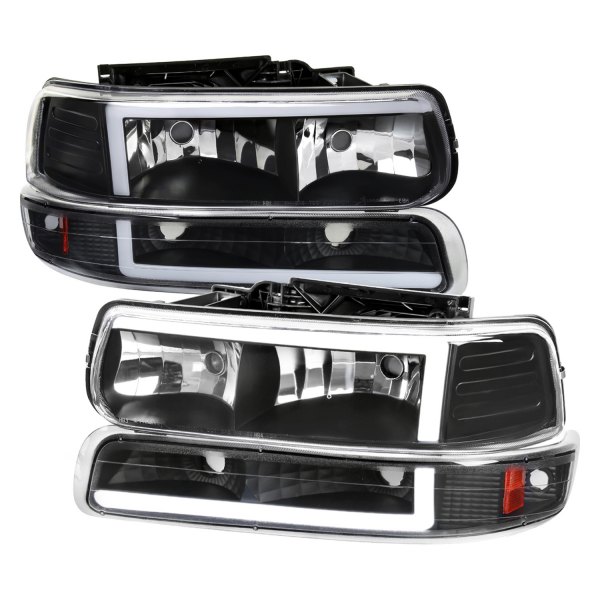

I just purchased a set of Spec-D headlights with the DRL LED fiber optic bar for my 2003 Tahoe. The way they're meant to be installed is tapping into the DRL wiring, but I want the bars to illuminate when the parking lights are on too. Basically I'm looking to have them act as DRL, but also be on at night when the headlights and/or parking lights are on. My initial thought was to tap off both the DRL and parking light wiring and putting a diode on both wires to prevent them from backfeeding each other. Can anyone confirm if this is the correct way to go about it? Or better yet, if someone has a wiring diagram detailing the entire front lighting harness/BCM, I would be able to work it out on my own. Thanks!
