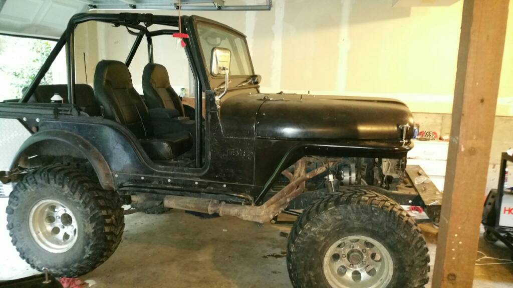

Ok I just changed the oil a few days ago so I will wait to do the sea foam trick till I'm ready to change it again and If never messed with newer motor stuff at all so how hard is it to remove the intake manifold? This is me and my wife's 1 and only car at the moment as I messed up my jeep a bit ago (mangled the cross member that hold trans up) and so the revised valve cover is only one side? and I need it to put the oil catch on? here's a pic of the jeep just cause I think its cool
