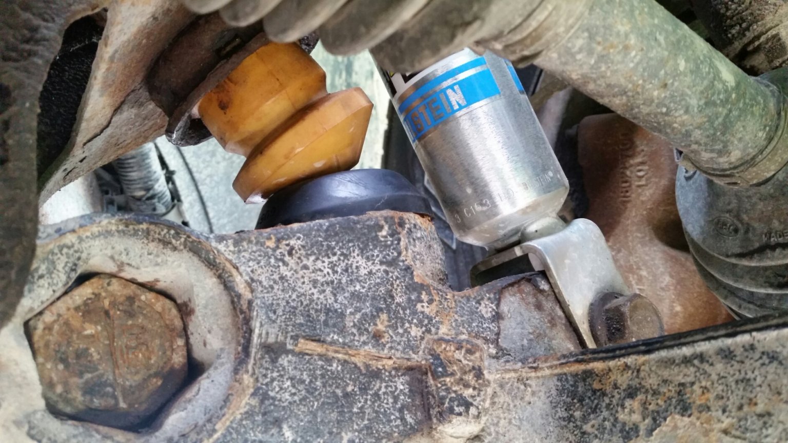

I used the z71 jounce bumpers and am mounting these on the lower control arms to compensate for the lift.
Energy Suspension 9.9117G Universal Bump Stop Black Flat Head Style Polyurethane.

Photo of how I shimmed my jounce bumpers with leveling keys.
I have 8" between the top of the tire and wheelwell (265/75/16's)..with plenty of adjustment left in the keys.

So, I'm taking that the LCA is supposed to be in constant contact with those stops? I thought they wereonly there to basically stop travel but didn't matter that the never touch on my truck. Someone explain pls, and if them being in constant contact would give a softer or firmer ride. I'm pretty new to all this suspension stuff, but do know my way around the shop as I've done ALL of my work myself except for the knock sensors.

Yes the lower control arms are supposed to be in contact with the jounce bumpers, they are "not" bump stops , they work in conjunction with the torsion bars..
Mine had been missing and I went threw 2 sets of end links on my front sway bar, finally I researched the suspension design and realized they needed to be there to operate as designed....

Wondering if the jounce bumpers you have will work with a 2000 yukon XL?

The ones I have in the photo are in a 2000 yukon xl.
If your xl is stock (non lifted keys) I would order the stock ones or have your torsion bar keys turned up a bit...
