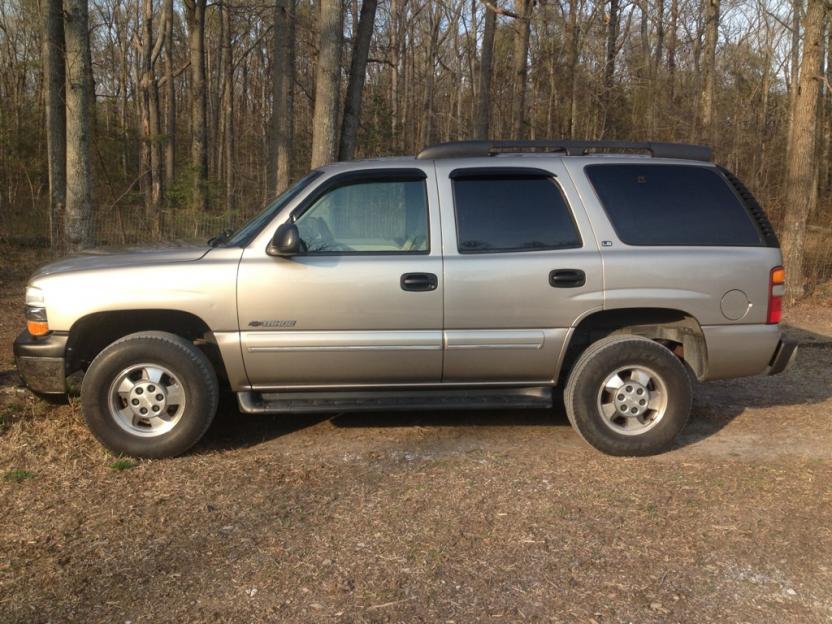

top before sorry about the pic angle like i said it was snowing when i started so it was hard plus i was as far as i could get away due to all the cars in the driveway that day.
fenders start : LR 35in RR 35.5in
LF 34.75in RF 35in
bottom is after my fenders are just above where most stock z's sit before i get tires so im ok with it now i guess
Fenders finish : LR 37.25in RR 37.75in
LF 35.75in RF 35.75in

Yes you are correct no spacers but to help the rear there is two rubber coil insulators under the driver side to level with passenger side due to weight of fuel tank. I think the are on 1/4in think not much. But I plan on making another post this evening hopefully because Sunday I put new torsion bars in and another new set of keys because I was unhappy with the first set

The front is another 1/2in higher with a lot of thread left to keep going up on the adj bolt. But you have it easy on 2wd. The coils or nice I picked them up from a junk yard $20 for both so very happy and I don't notice any ride quality diff with the springs since the shocks are amazing but I need to decide on spacers and if I will raise the front.
