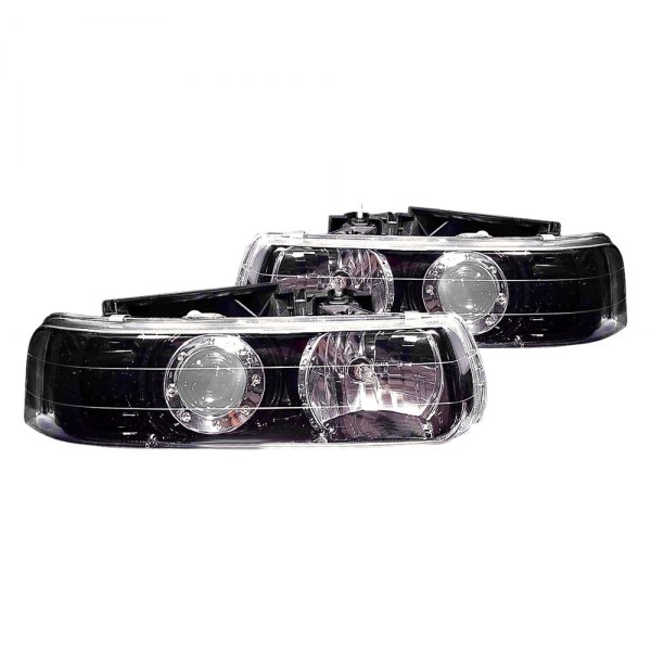

Here is a housing

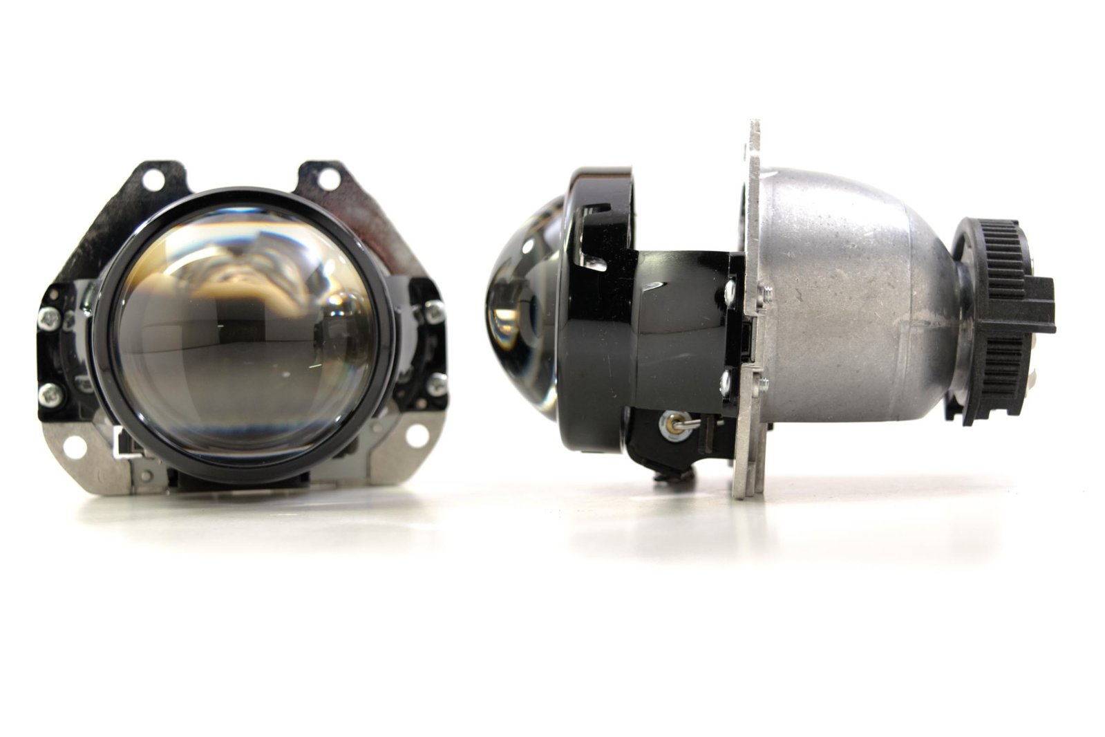

Inside the housing is the projector, Here is the projector,
Retrofitting would technically be putting projectors into a non-projector housing. You can put high quality projectors into the factory housing, but its difficult to make it look clean, and to do it right. People were trying for years, they didn't come out perfect, and those who knew what they were doing were charging hundred for this service if you were lucky. What the depos (and other projector housings) do is allow you to use a projector housing that swaps right over, no fuss, with a simple remove and replace (R&R) so you can use HIDs or LEDS (without blinding people)...
This is (from what I have read) about 75-90% as good as it will get (without moving your washer fluid bottle, cutting your fenders up, and all sorts of other unnecessary ridiculous to even talk about fabricating to use the perfect projector). To get the best (realistic) projector option is to MODIFY the depo housings by swapping in the Moshimoto mini H1 7.0 projectors (shouldn't be much if any more than $100, and THEY ARE A SITE SPONSOR). Then there are several companies that make a bracket ($55-$70) you can swap the mini HI right over into the DEPO housings to replace the DEPO projectors. There are threads on this, (same as 99-02 silverado might help your search). It is hands down the best lighting upgrade we can do and the extra bracket makes it as simple as a few screws.
