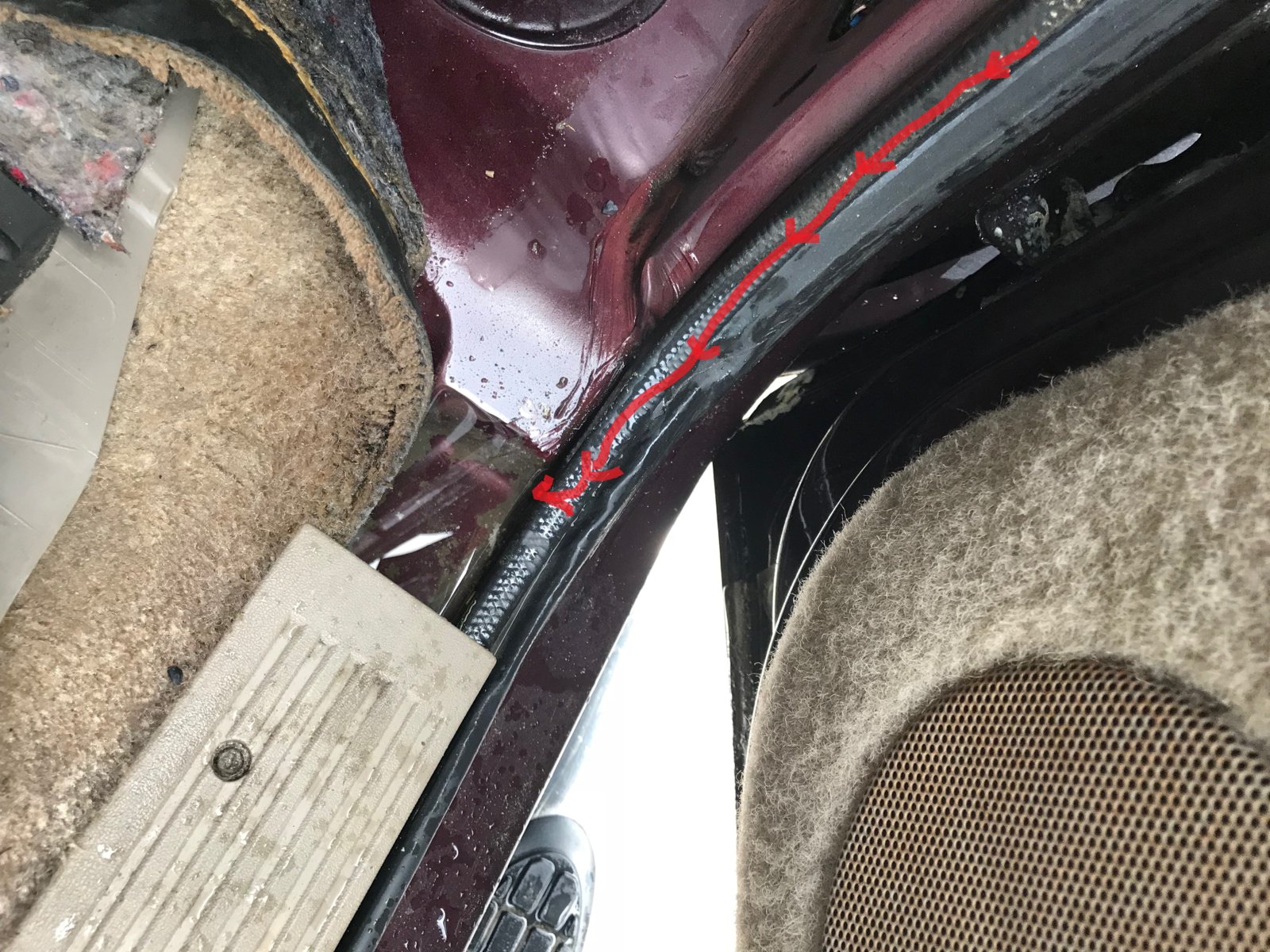

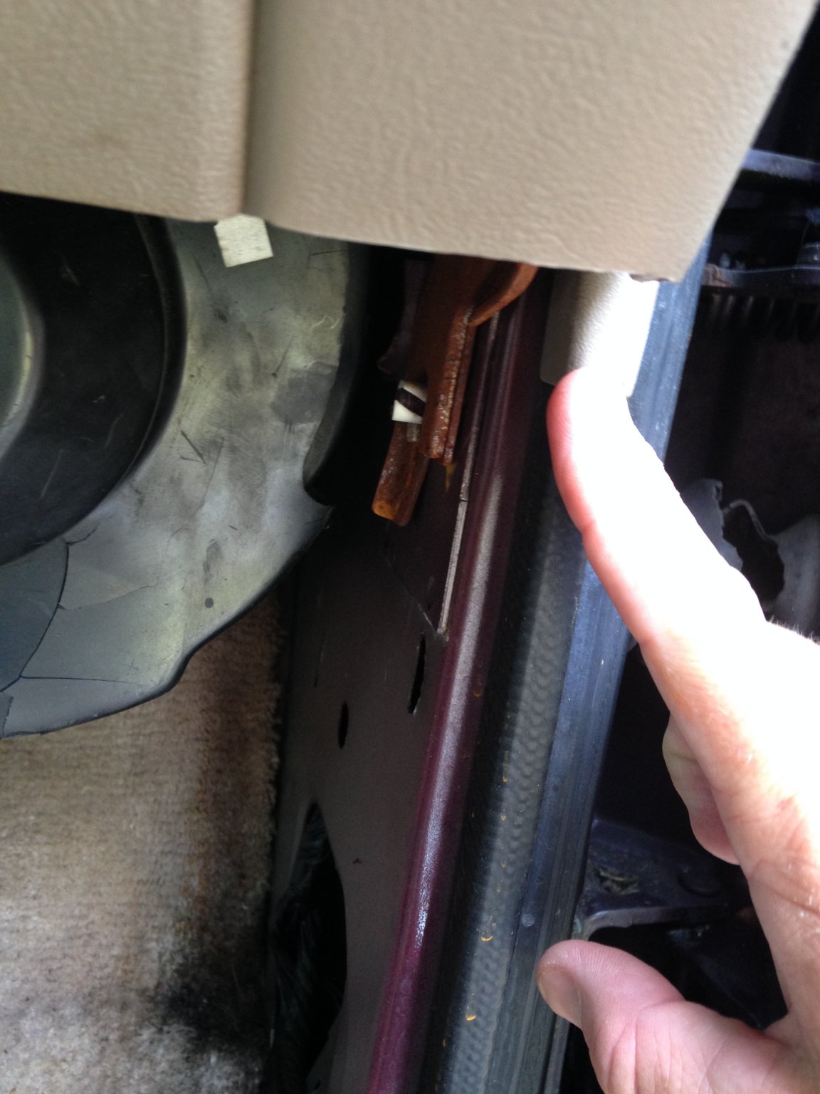

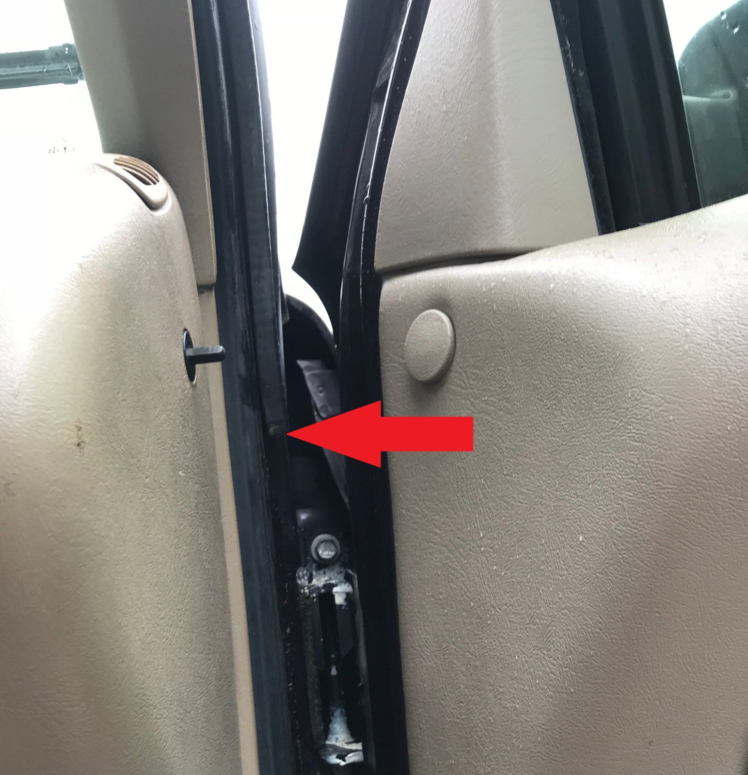

Let me start out by saying i have read at least 3 other posts on this common leak problem. I have had water on floor board for years. My cowl was dingy and cracked so i took care of 2 things at once by sealing the 2 screws and replacing all the cowl parts. It stopped majority of water but i still have water getting in on the right side. It runs down right of the blower cover on top of the beige panel i am pointing at. It runs down to the side door step area and fills up till it touches carpet and carpet absorbes it and brings it in. I trimmed back some of the carpet and thought about drilling weep holes but wanted to show this pic to see if anyone else had this exact area issue.
