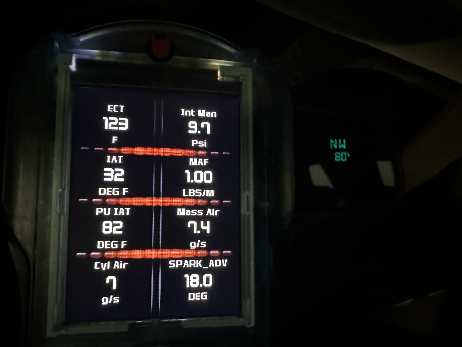

Earlier this year, I solved a cold start issue with my 2008 Yukon XL (5.3 LMG) by replacing my ECT sensor. I discovered a few other issues along the way to that fix and one of those issues is that my intake air temperature consistently reads 32°, regardless of environmental conditions or engine temperature. Installing a new MAF sensor did not fix this reading, so I’m presuming this is a problem in the connection between the MAF and ECU/PCM. No CEL, trouble codes, or obvious (to me) operational issues, but I imagine my engine would benefit from an accurate IAT read. The last thing I tried was a cheap cable tracer from Harbor Freight and that did not pan out for me.
Does anyone have any advice or experience with diagnosing/solving this problem?
