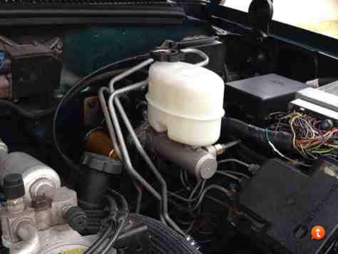

4 hours into my Hydroboost upgrade on my 1997 2 door.
What's the trick to getting access to the nut and bolt on top of the brake pedal??
Old MC is off, Vaccuum booster off, new MC bench bled and ready to go in, new hydroboost ready to go in......WTF is with this old pedal.
I have column down and can see/capture the nut but can't contort my hand to get the bolt.
Any tricks??
8 PM update; 6 hours in.
Old pedal is out and new one in; That was the toughest part of this whole upgrade. I replaced the offset mounting plate on the HB unit with a centered one and mounted to firewall; MC is on.
Plumbing lines and bleeding brakes in the AM.

3 additional hours on Saturday and I'm done; hydroboost upgrade is complete.
Initial impressions are that the braking performance is definitively improved; ie shorter distance required to stop.
I am a little disappointed in the pedal though, its not "instantly" firm at its uppermost location as I expected(maybe erroneously expected). It does firm up about a quarter way down and system is capable of locking brakes up with ABS pulsing.
1st cold start on Sunday am had a fairly soft pedal, pumped up fine after about two,three or four pumps; thinking a re-bleed is in my immediate future
