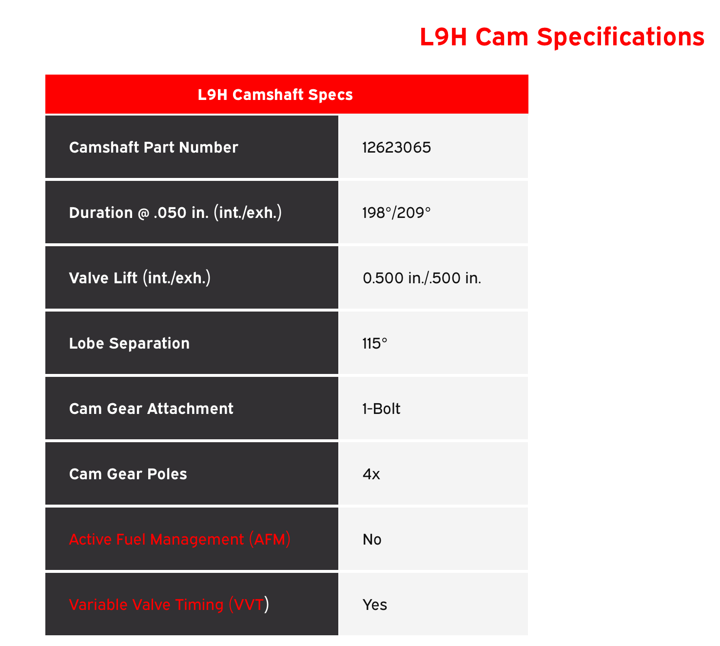

The original engine in the '09 should be the L9H (flex fuel + VVT but no DoD) with essentially the same larger injectors as those in the '13 6.2. Since the '13 6.2 has a non-DoD cam in it already that retains VVT, it shouldn't *need* a tune to run. But it will need a tune to run smoothly and get the most from that cam.
