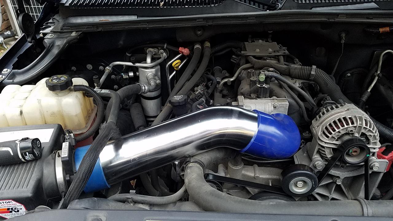

anyway so i did a test fit and the pipe itself looks horrid IMO in the bright aluminum.
to my surprise though, it did fit just fine. the couplers are pretty crappy if i am honest and are just straight silicon with no reinforcement (dont use them for boost!) but they do the job.

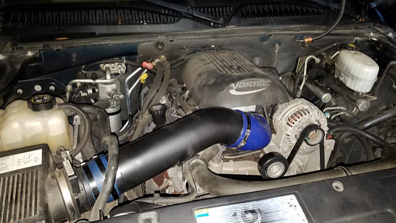

i decided to spray it with some plastidip to get it to a color that i felt fit the daily driver nature of the vehicle.
i think it turned out fairly well.
no modifications were needed just fitting the pipe. upside is now i have some extra heat shield stock and cone filter leftover from this kit to use on other projects later.
