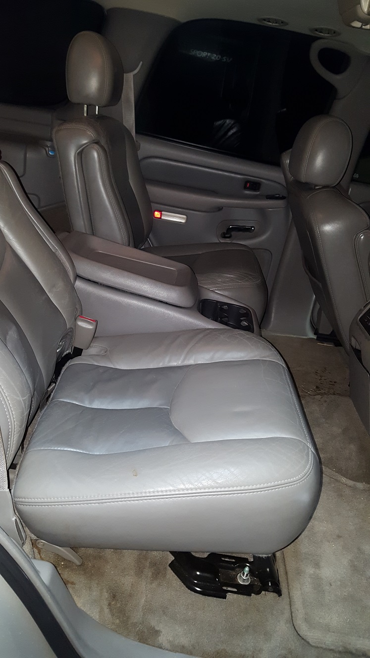

I'm thinking of putting a center console in between my sencond roll buckets seats.

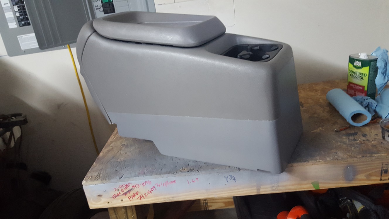

ivin74
ivin74
05 NBS Nali
Aug 3, 2014
2,271
2,325
Htown, Texas

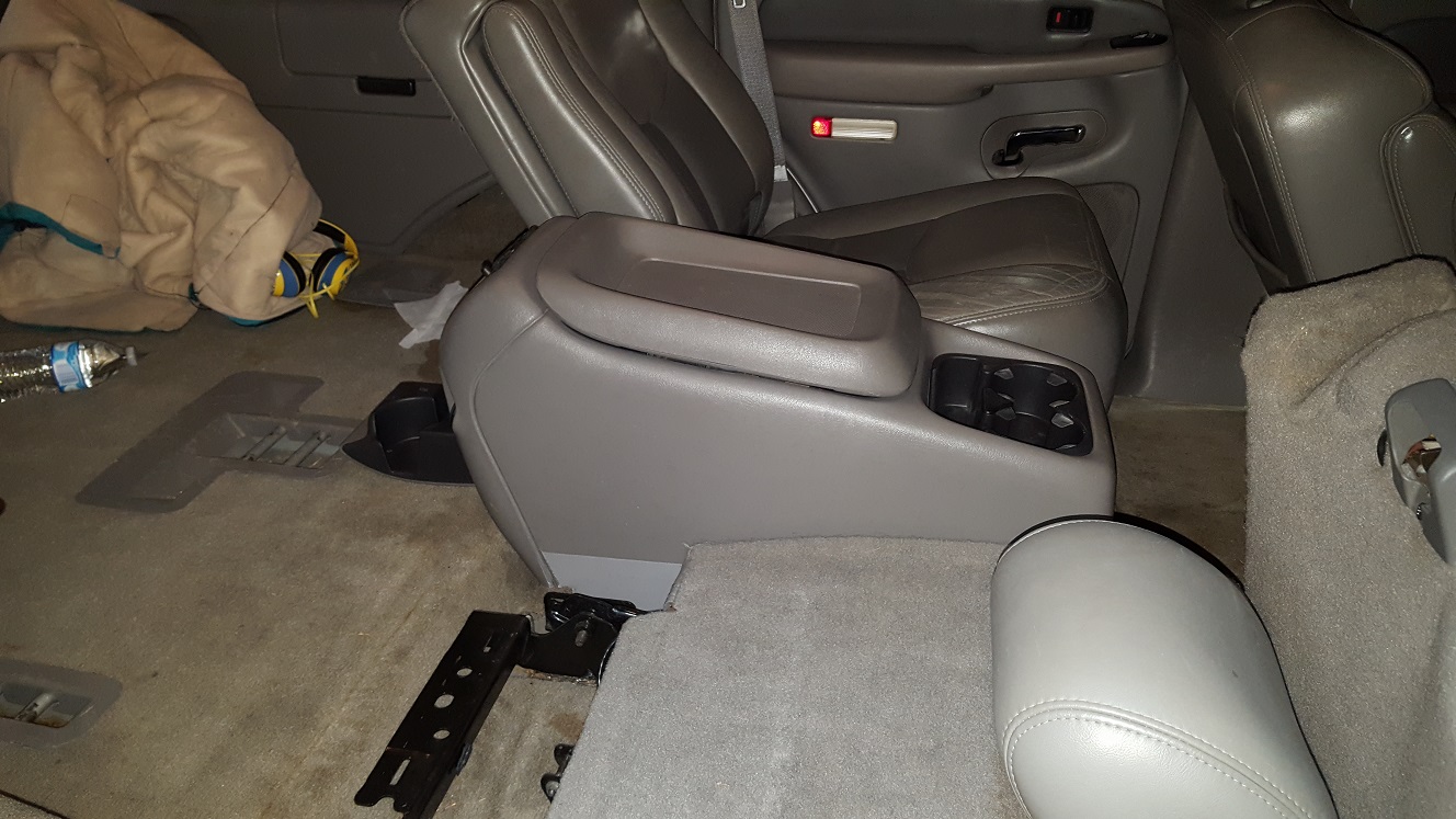

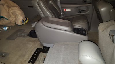

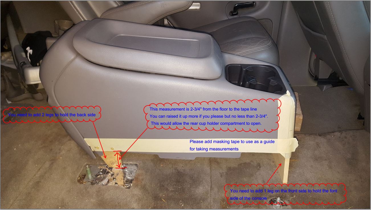

I found this image on the net, this center console looks great. I'm sold, doing the conversion

This conversion was done on a crew cab using the Tahoe second roll captain seats
30,993
45,168

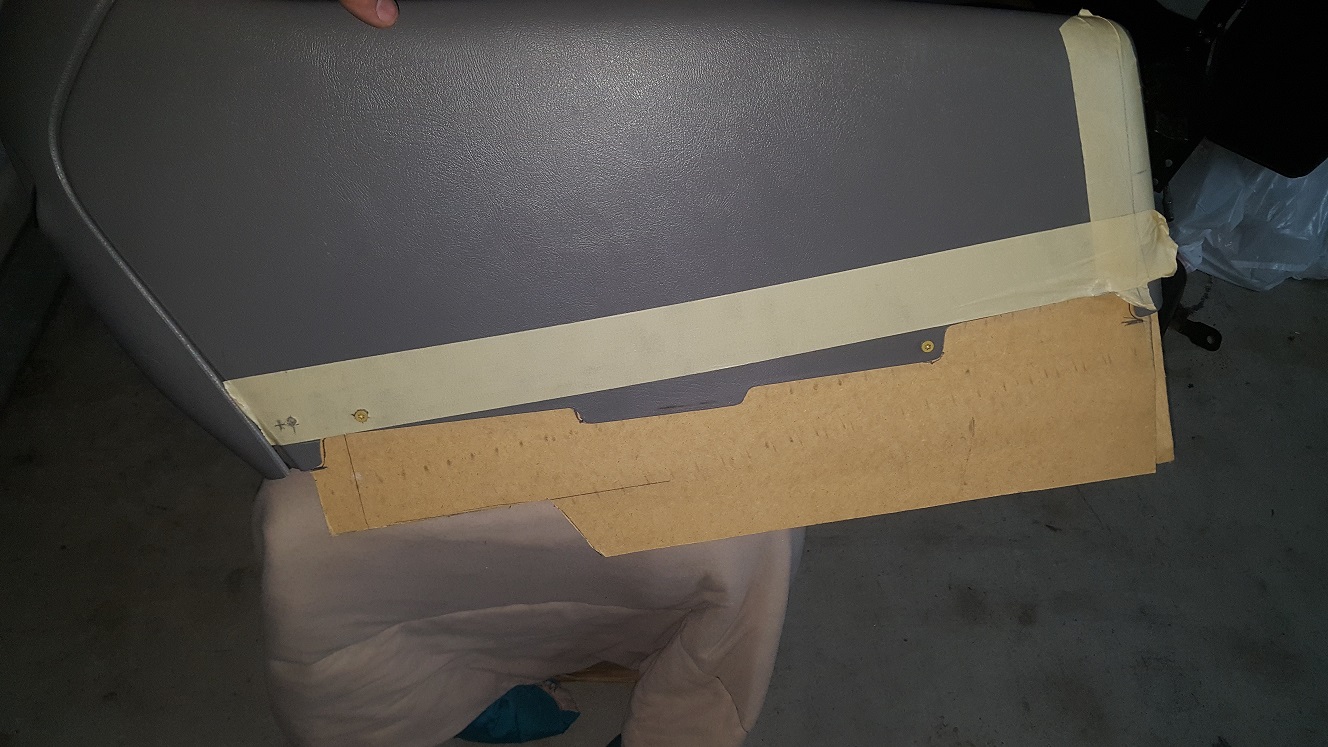

That looks pretty good. Only thing, I think, that's a front center console so isn't there a cutout in the front of it for something? Like to lock it into the front of the dash? If there is, there'll be a big hole in the front of it. If I'm wrong please let me know.
ivin74
ivin74
05 NBS Nali
Aug 3, 2014
2,271
2,325
Htown, Texas

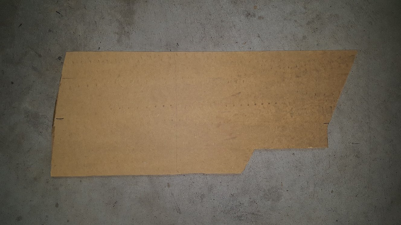

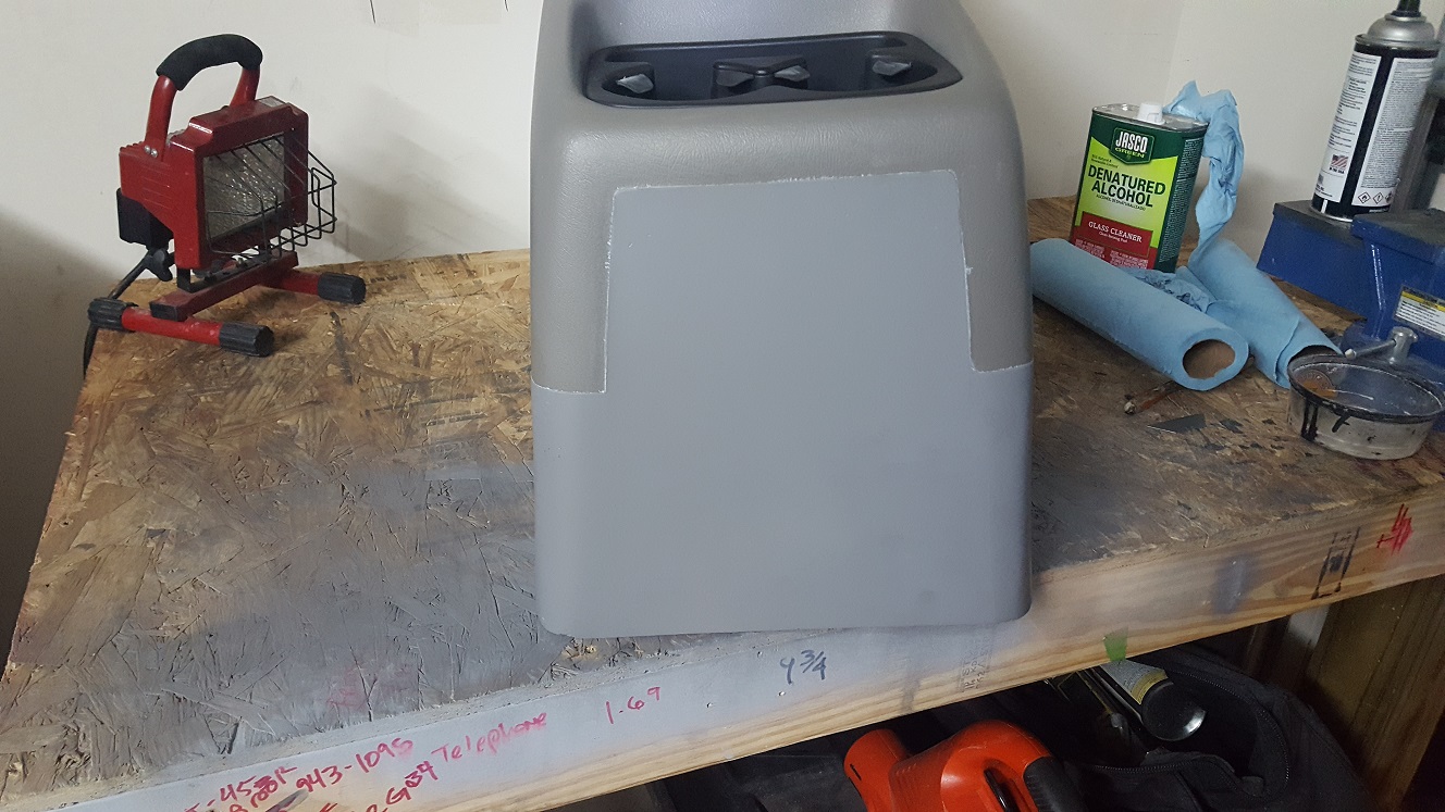

You are correct there is a cut out, but it's easy to cover it up with a piece of 1/8" plywood wrapped in color matching vinyl.
