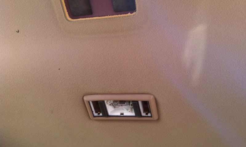

H]oly jebus! My interior lights decided to not work, checked the fuse and it was blown..
Since I was running my amp wires I figred i disconnected something. Checked everything and found nothing. Put another fuse in and popped instantly. Hours of tracking and tracing wires is so frustrating. Something was grounding out and I had everything apart.
So, I finaly figured out the problem after testing ALL of the interior lighting wires. As luck would have it, it was the last thing I expected. One of the on/off switches on the dome light was faulty.
The switch itself was grounding out. I never even use those switches.
Reason im posting is incase someone runs into this problem.. I eliminated the switch, problem solved.
