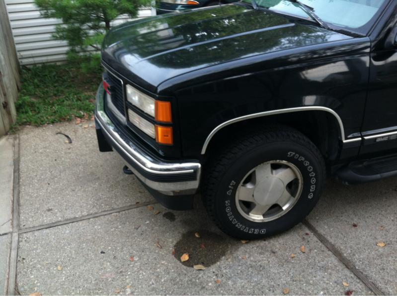

So my 1997 Yukon has been been losing coolant lately and I'm not sure where. Today I noticed spots in the driveway in two different places so I checked the coolant again and for a second time the coolant overflow is completely empty. I've never had any overheating issues and I just towed my camper 200 miles no problem. Temp gauge never gets hot. I checked the oil too, not a problem there either. Only the small spot could possibly be coming from the bottom of the radiator and I have no idea about the big one. I let it run till it got up to temp and couldn't spot any leaks or drips. Any ideas on where my coolant is going?

Mine was actually leaking out of the water pump. I never overheated or ran up the temp gauge. But my overflow bottle was always empty. New water pump for me, no issues since.

Well, just going off of the picture alone, you probably have a crack in the plastic jug(s) on the radiator. They are notorious for cracking. From my past experience, you probably have a small crack on the backside of the jug, the pressure is spraying your radiator support and its running down and draining on the floor.
Testing your pressure is a good idea, but sadly I think your going to find that you've got a crack or its leaking where the jug meets the core on the radiator. Now remember I'm going off your picture alone but if you had any of the other issues, your leak would be more centralized under the truck and not dropping from under the bumper.
