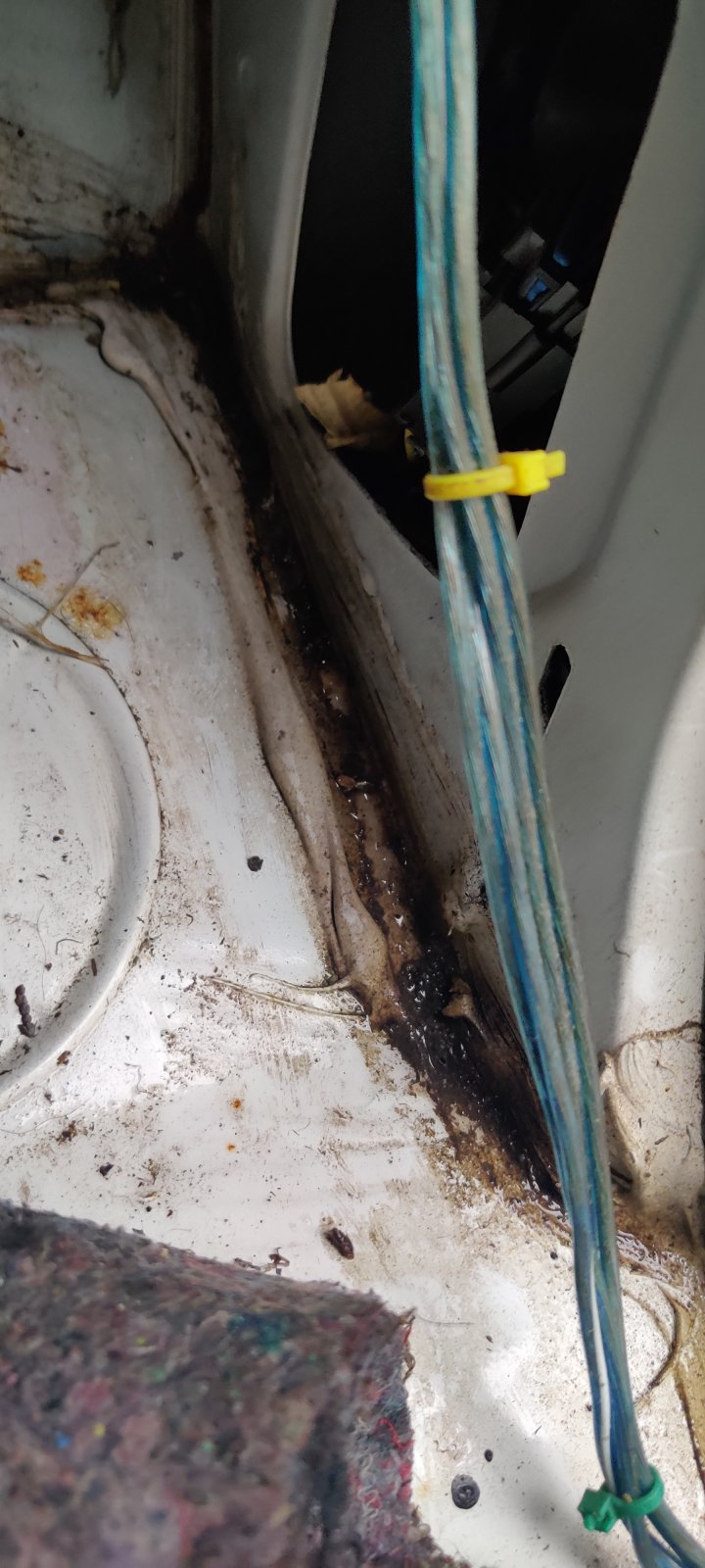

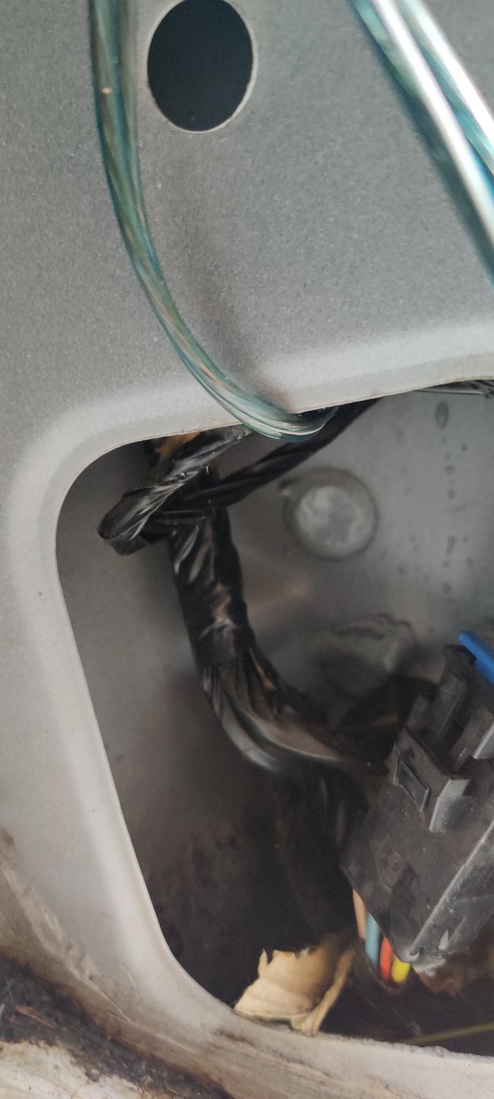

Yeah I have done the above in the past and it got better, but is still leaking into that hole in kick panel. I guess I will have to take another look.Look at the cowl area around wiper arms, sometimes there are loose mount screws for that cover, RTV or urethane the screws and re-install. Look at seam sealer around the hood arm areas while cover off also.
