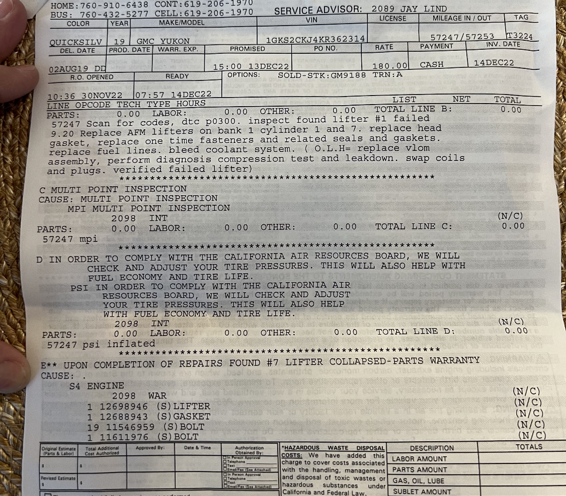

Hey, I’m looking at buying a 2019 Denali with about 53k on the clock. The original owner said he had a lifter go out and got it repaired under warranty - I asked him for the paperwork and I’ll share that here when I get it - but has anyone experienced this ?
Hey you said it has 53K on the clock but the dealer paperwork from last year shows shows 57K.

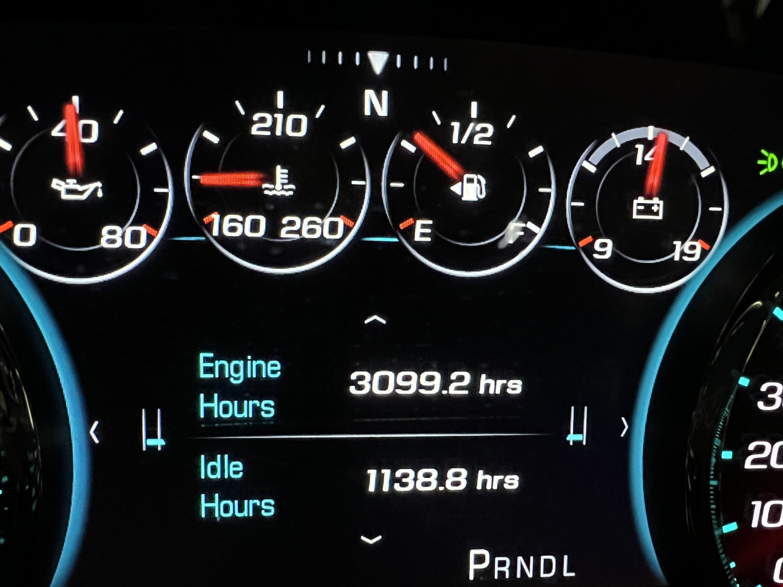

Here is the hours for the car. I just got off the phone with him. I’m going to at least look at it with cash in hand and if it doesn’t work then so be it.
He’s selling it because his wife wanted a BMW (this is her car). Only one bank of lifters was replaced . The service gap was because his wife took it to Jiffy Lube (double I used to work at jiffy lube hopefully they’ve gotten better). I feel pretty good about it.

Update : engine hours and idle hours seem on par for a vehicle with almost 60k…. Checking it out on Friday. We agreed on $42,000 cash. Which looking around seems like a pretty fair deal - after all private party is a big advantage for taxes and all that other crap.
Any opinions are welcome - obviously I’m not going to get a feel for the car until I’m there in person.

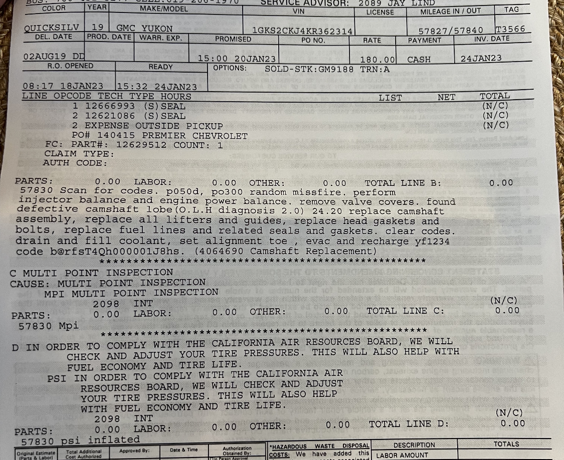

Another update!!!! Just spoke with the service advisor at the GMC dealer who dealt with the customer in buying it from. He said all lifters were replaced along with the cam shaft. And has a 2 year/unlimited mile warranty for the work he did.
Put the work orders in safe place in case.
