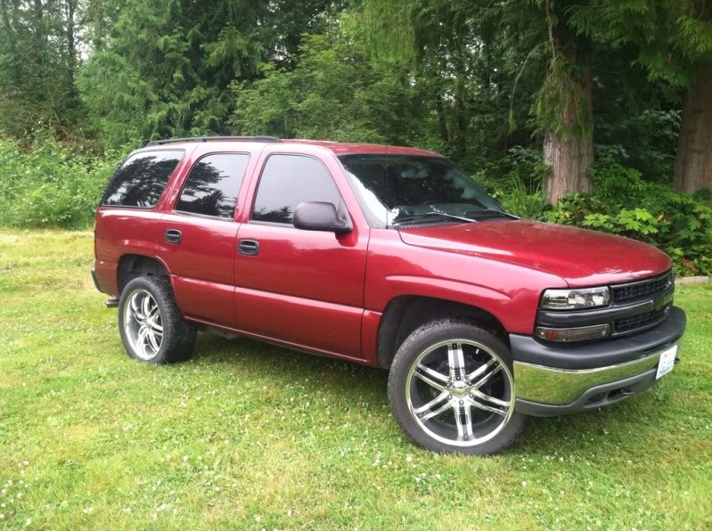

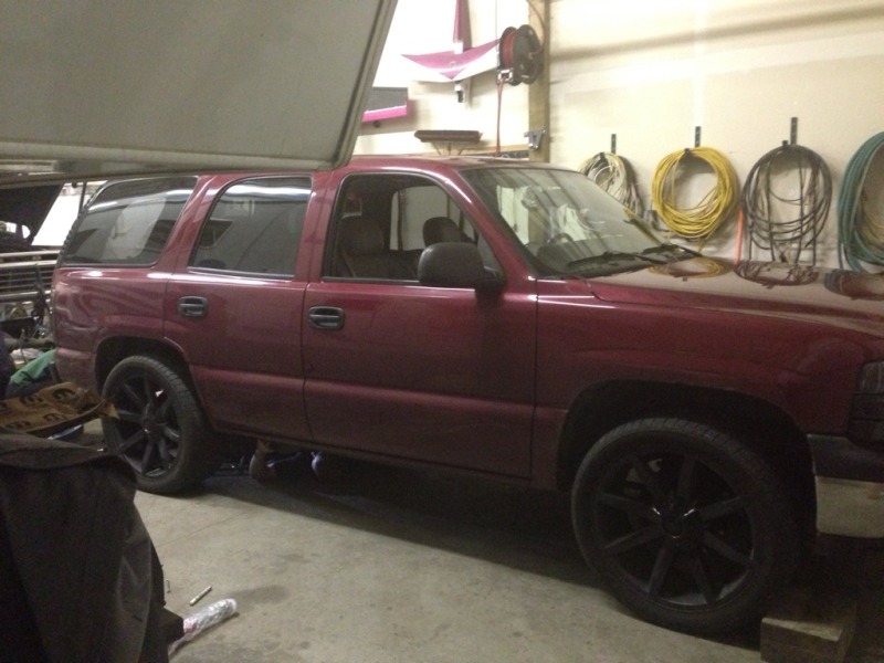

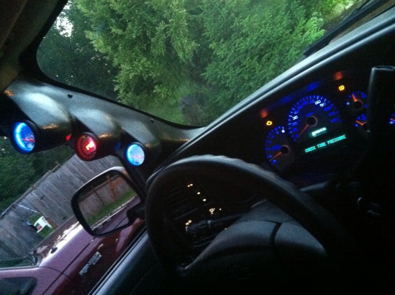

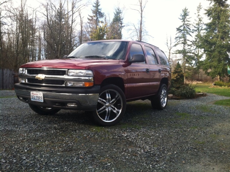

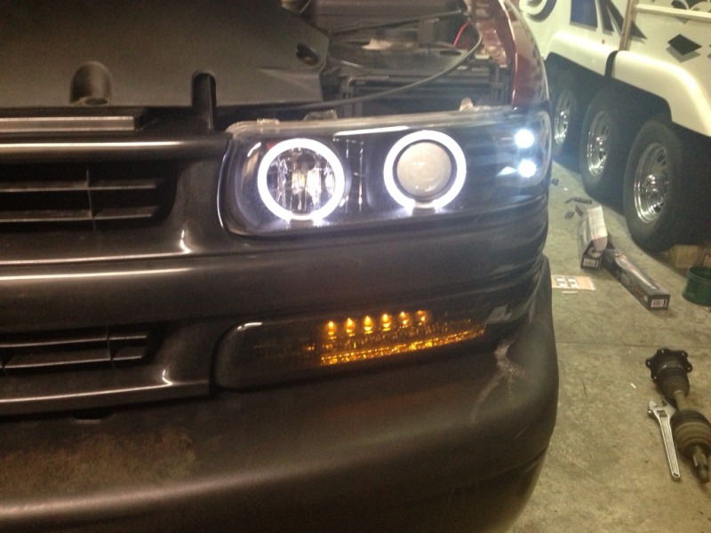

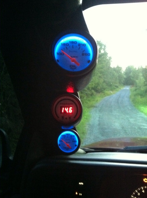

Well I figured its time I started a build thread. I started with s 2004 tahoe base modle with an LM7 and 22" rims and stock height. Been doing a lot of work to it so ill play catch up to where I am today. First thing we did is put in some pillar gauges, oil and trans temp and a wide band air to fuel, auto meter phantoms, ad the next thing we did was halos, LED bumper lights and 8k HIDs an fogs.
Heres when I got it.
First few things i did to it were smoked headlights and gauges.

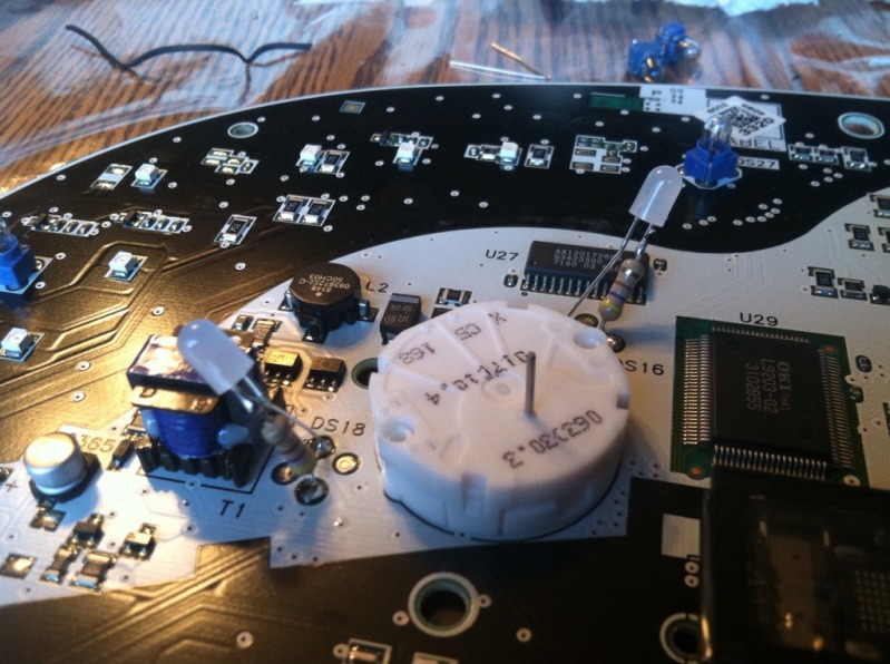

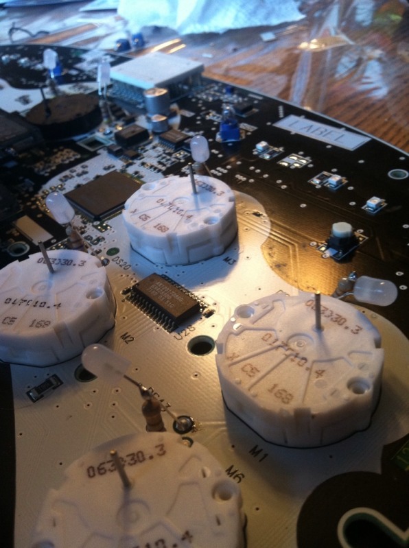

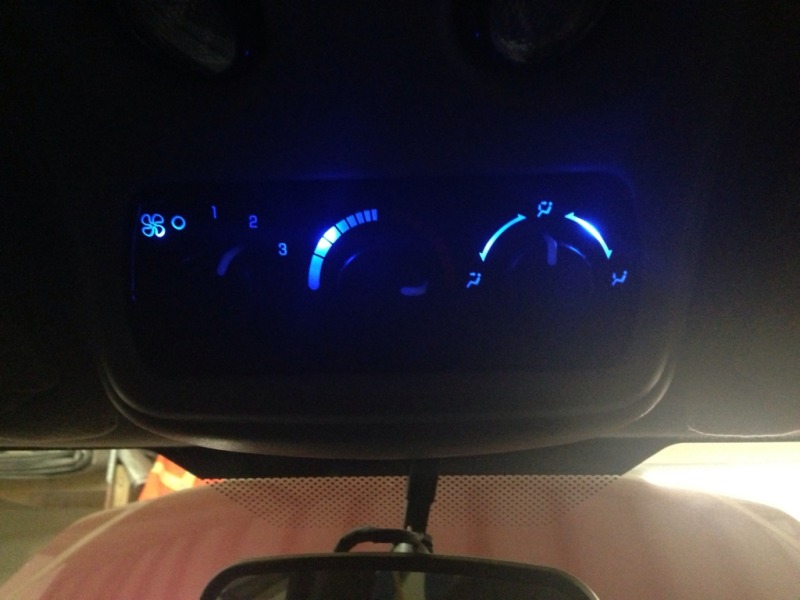

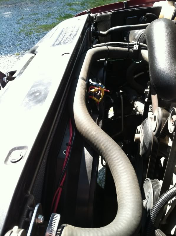

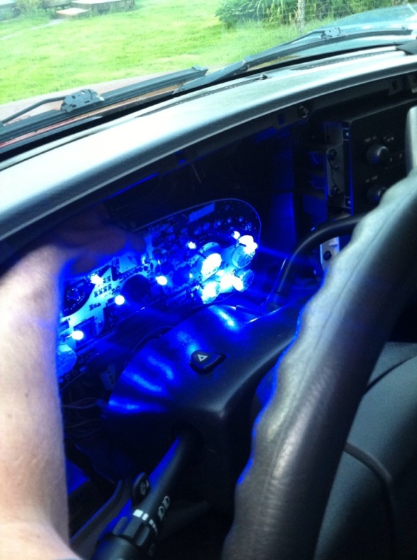

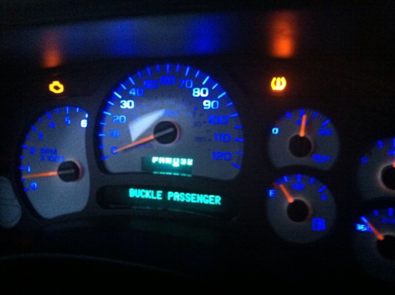

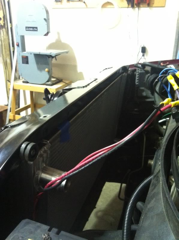

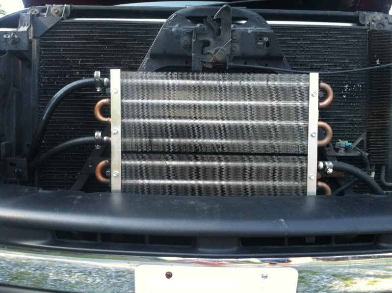

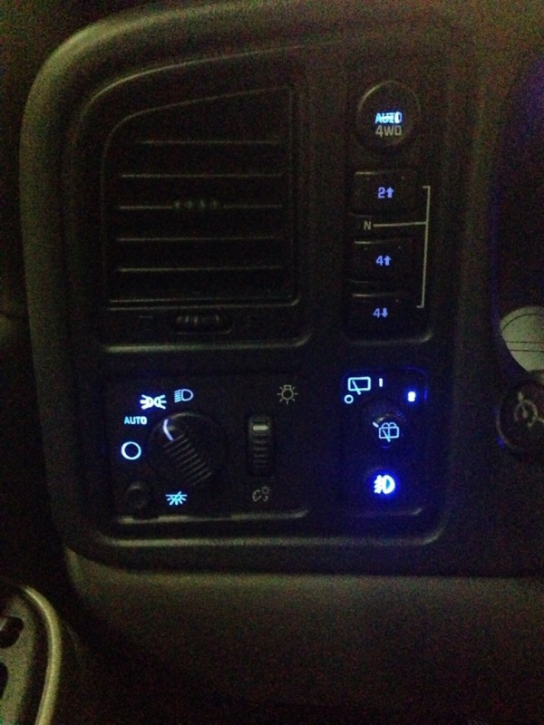

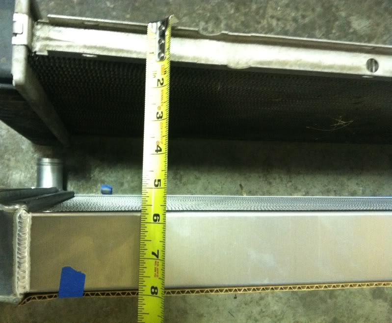

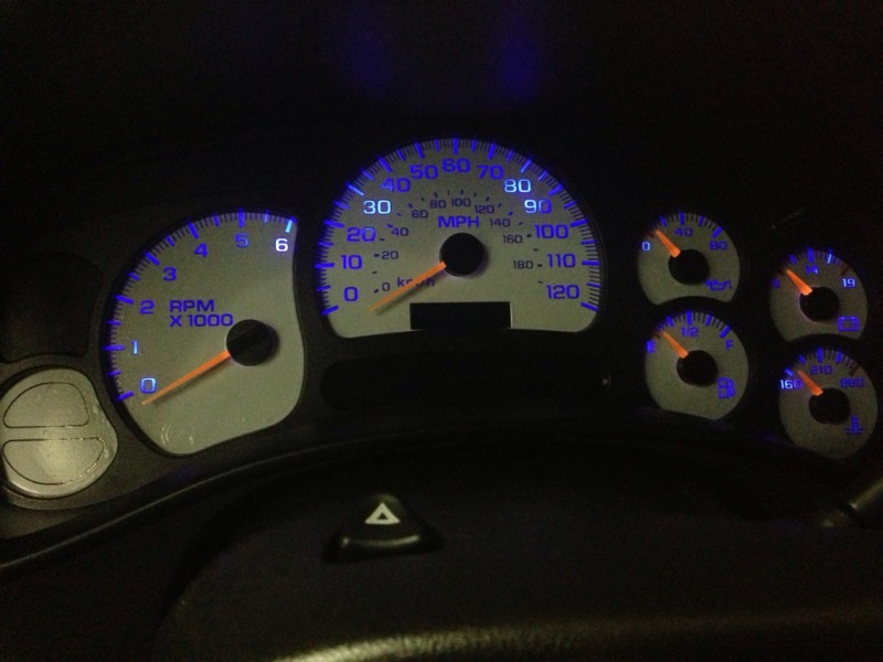

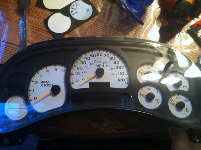

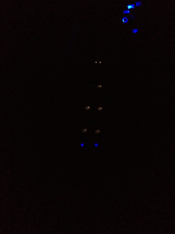

Next we fixed my stepper motor in the dash, added blue leds and a white overlay. More recently started putting leds in the headlight switch, 4x4, fog light, and over head heater control, and working on the window switches. Then put a custom Flex-a-lite aluminum radiator with dual 16" s blade fans and a trans and oil cooler

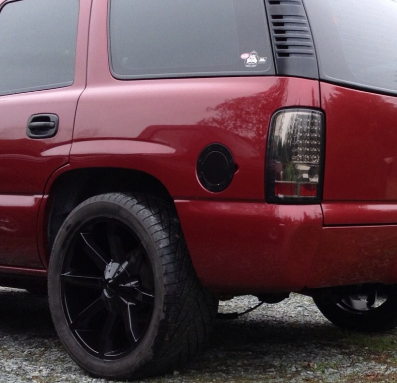

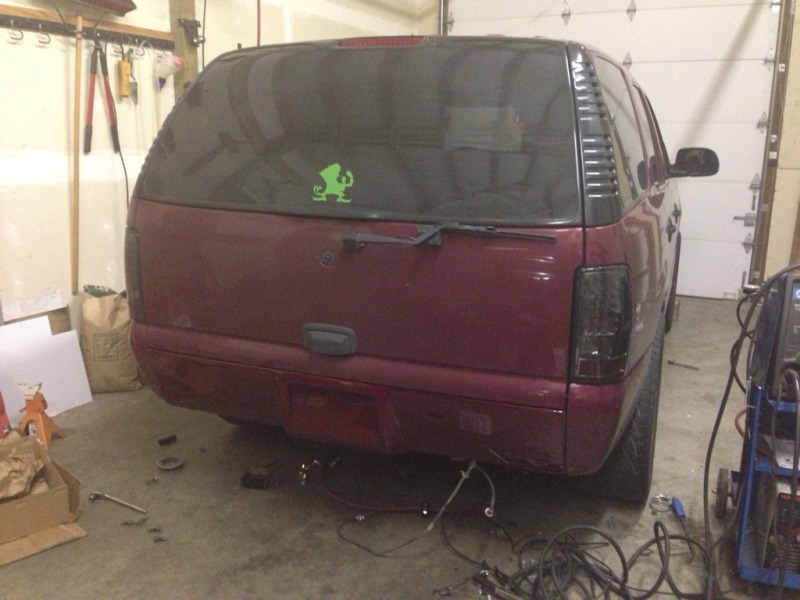

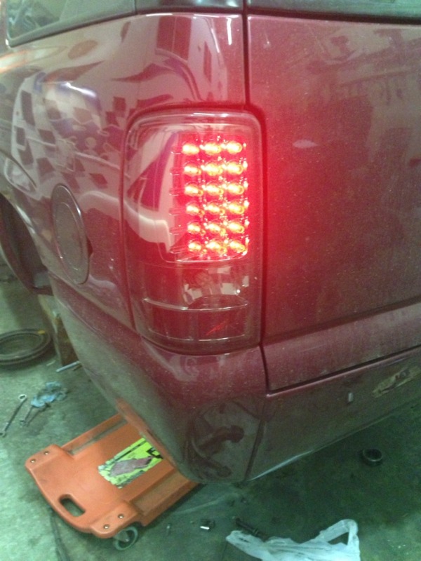

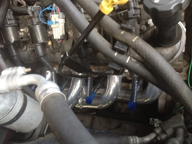

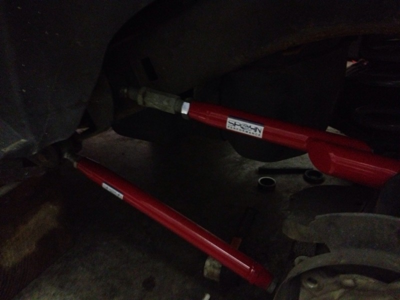

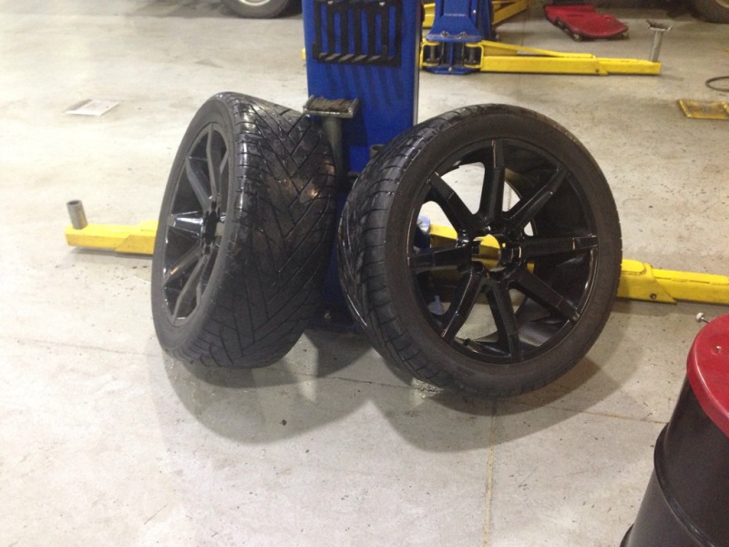

Next up we did 22" KMC Slides, belltech 3/4 drop in the rear, spohn control arms, fiberglass roll pan and LED tail lights, and Doug Thorley headers with no cats and DUI livewires.

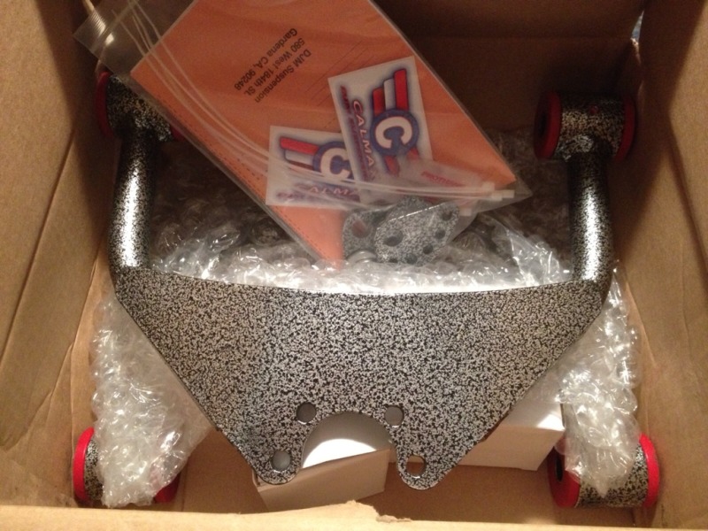

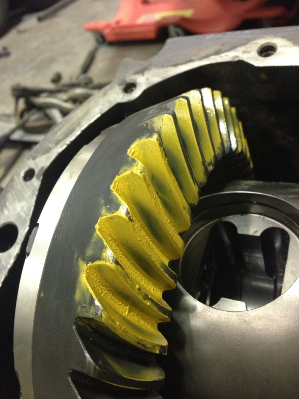

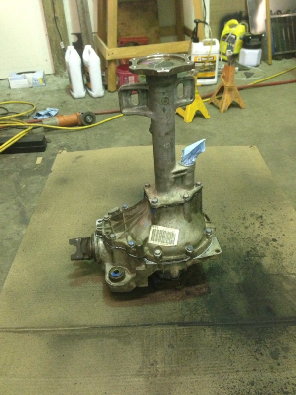

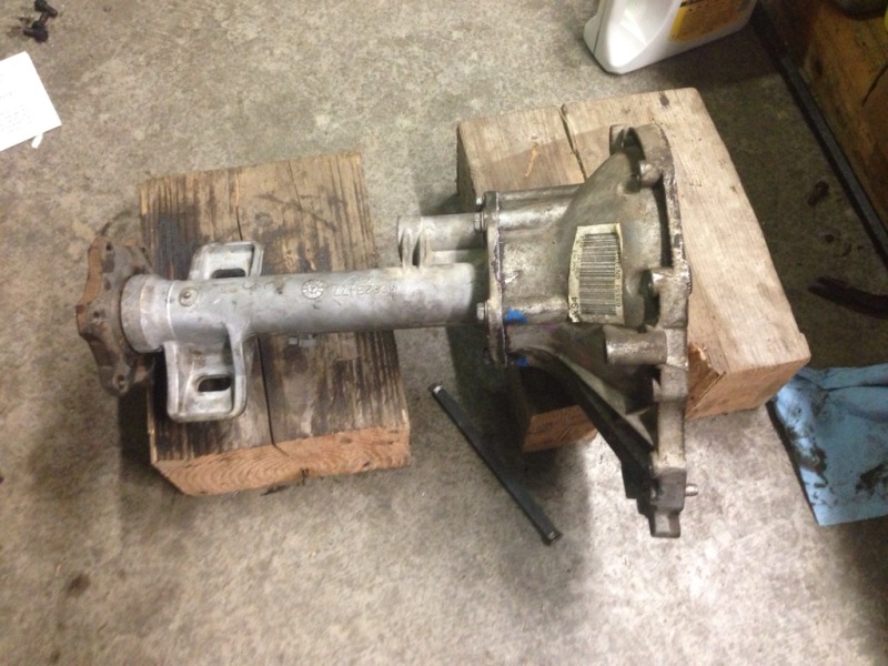

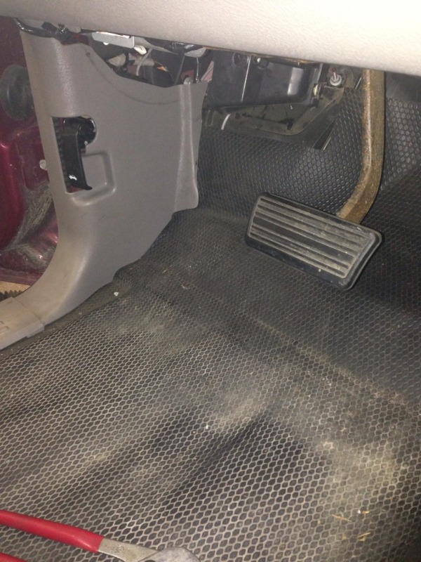

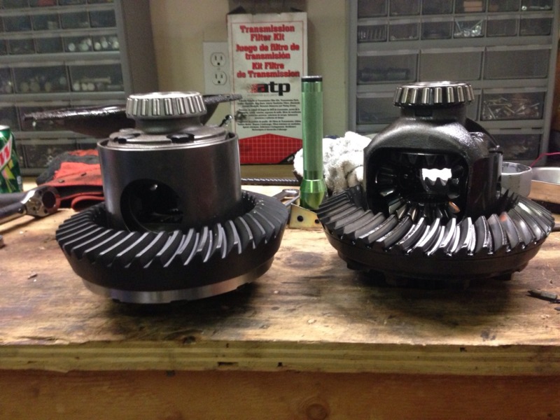

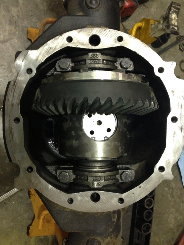

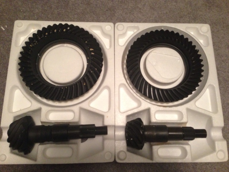

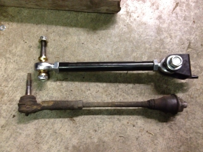

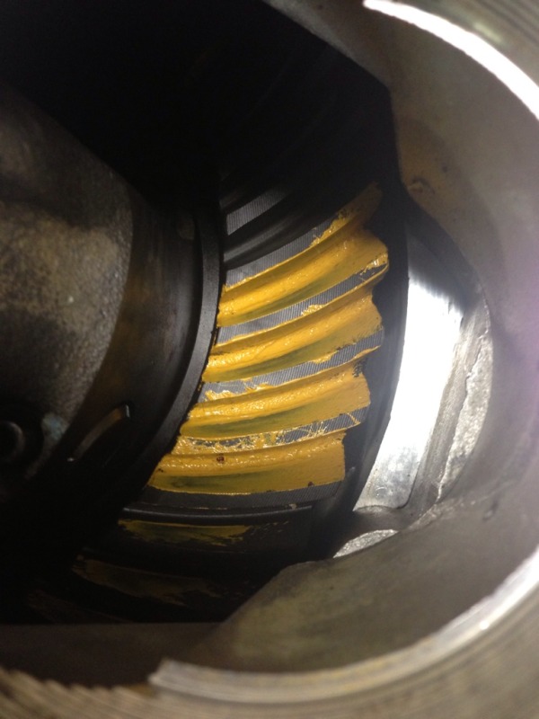

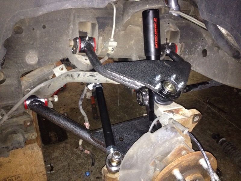

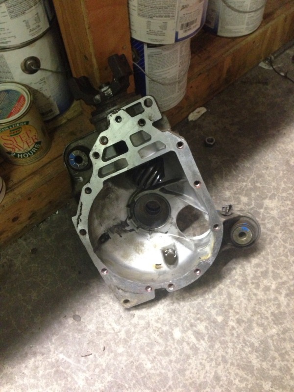

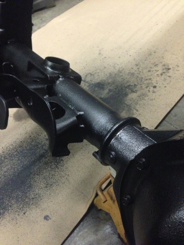

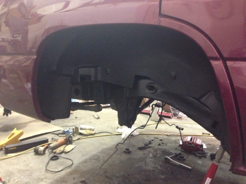

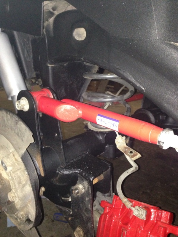

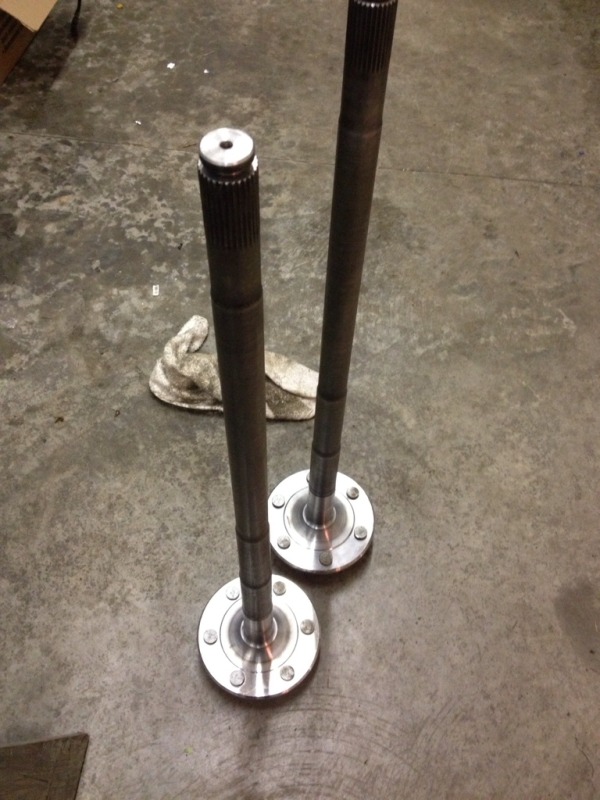

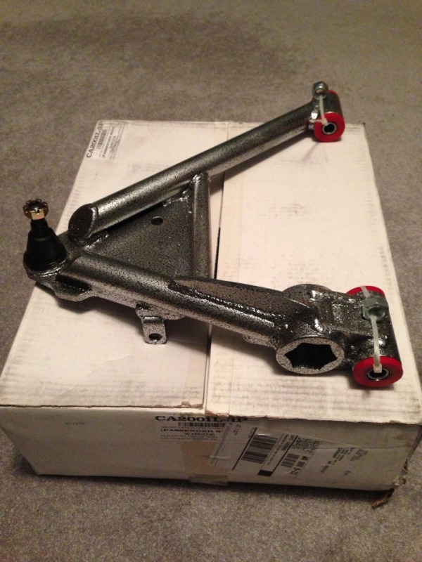

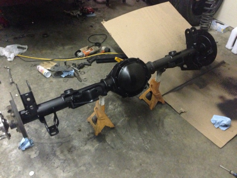

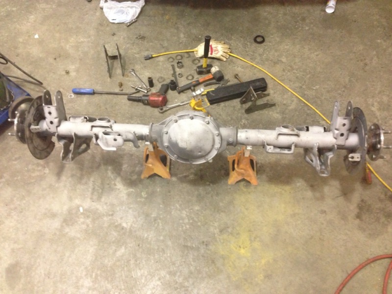

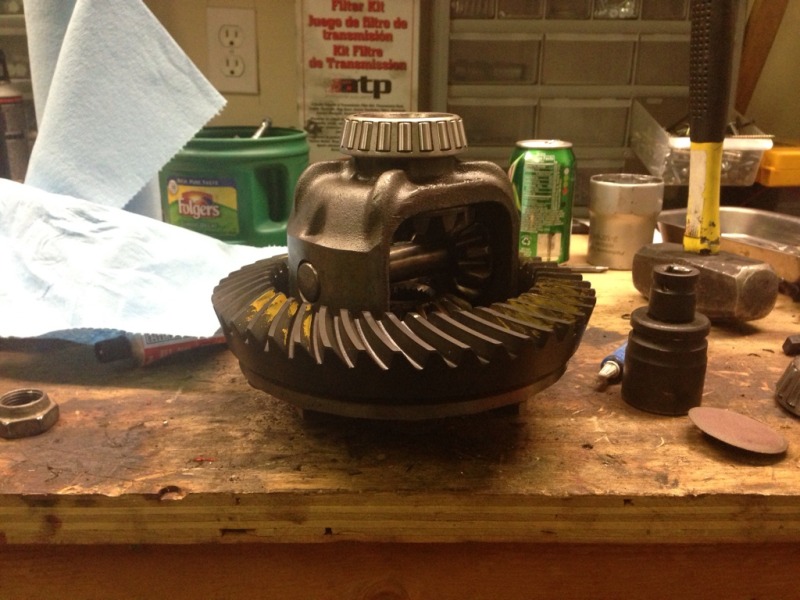

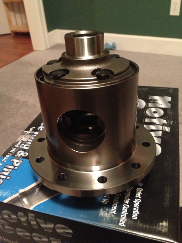

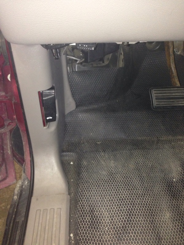

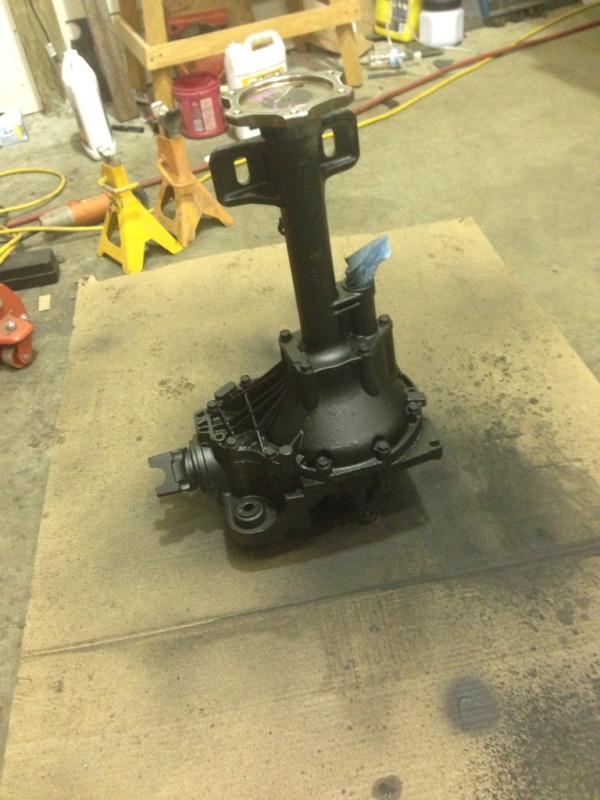

Onto what were currently working on. Rebuilt both diffs and put in 4.30 gears, true trac and yukon shafts in the rear, DJM 3" drop control arms in the front along with DJM uppers. Also FFR Fab custom chromoly/hiem joint tie rods. And took the park brake pedal out since we took it out.

More pics

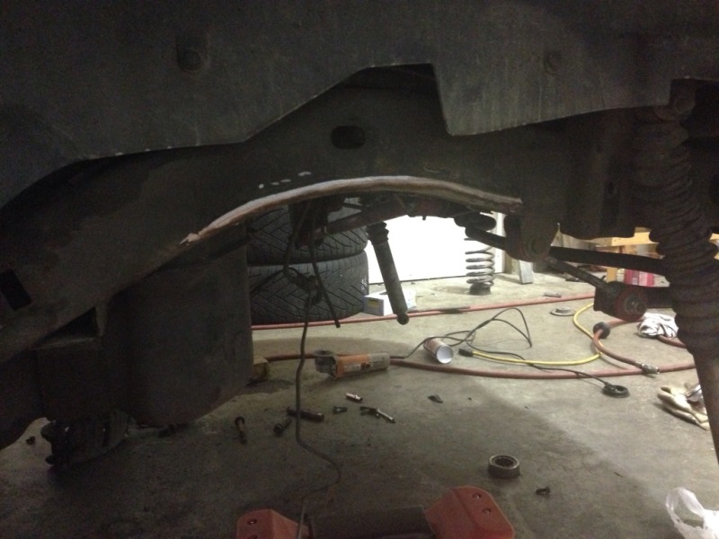

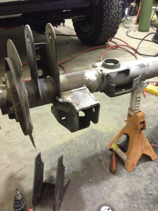

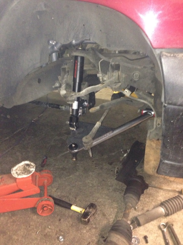

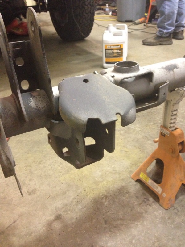

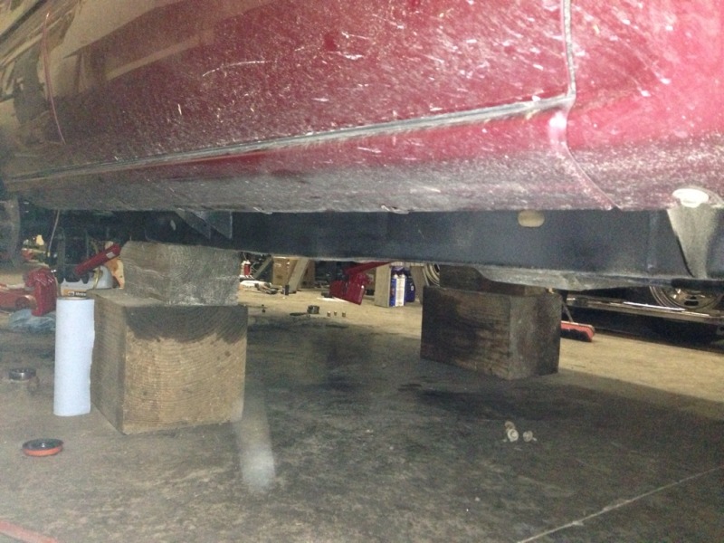

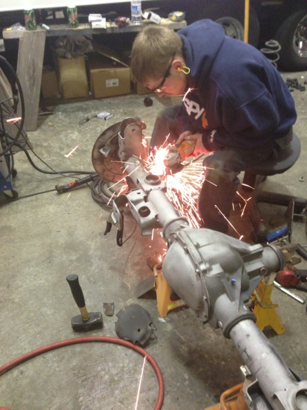

cut this off
---------- Post added at 02:32 PM ---------- Previous post was at 02:28 PM ----------

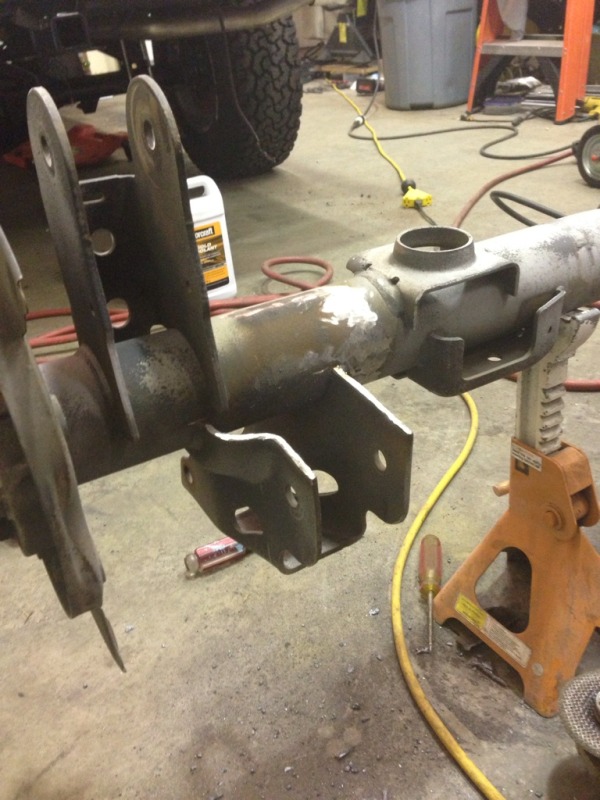

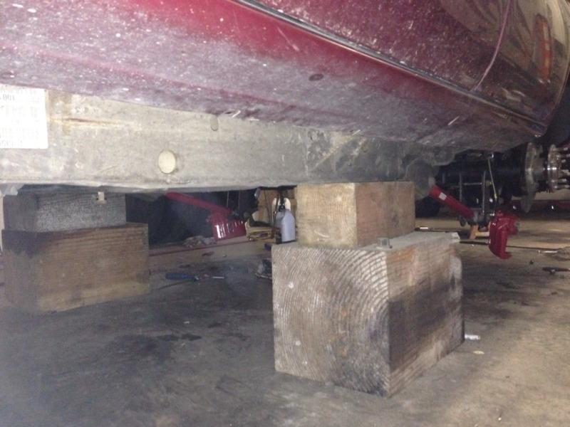

this is the frame side where we cut the bumpstop off the axle.
front diff

hey man looking good, and now you got me quite curious, two things that i have in my mind,
1. why did you get rid of the parking brake ?
2. What this mod you did to get rid of the bump stop? any more details on this..
Looking good man, what's your set back on
Gears, True-Trac, Yukon shafts ? and where did you get them from...

i've done the free travel mod what he removed was the one on the axle...
After I wrote that, I looked at your truck and figured you'd done it and knew what it meant. But you didn't specify "on the axle" when you said
I got rid of the park brake because the cables themselves hung below the axle and were ziptied to my sway bar and they looked terrible and didn't want them to hook anything. Plus I didn't use it anyways so we took the whole foot pedal out and cleaned it up. There is lots more room now.
Yes as Nathan said it was the free travel mod that I did. We cut the bumpstop on the frame side off with a plasma cutter and while the axle was out getting geared we took off the axle side bumpstop so it cleaned the axle up and I won't have to worry about it hitting my frame since I took my rear puck out and lowered it more.
As far as the gears, bearings, true trac, axles I'm just under $1500. I ordered the gears, true trac and bearings from Drivetrain America. They had the best prices. And the axles I ordered off Summit Racing

So we got the front axle all buttoned back up for the last time. Rear stainless lines are on and now waiting for brakes to show up this week.
And this is the suspension at full extend. There was enough room with just cutting the bumpstop off the frame now there is plenty of room without the axle bumpstop perch.

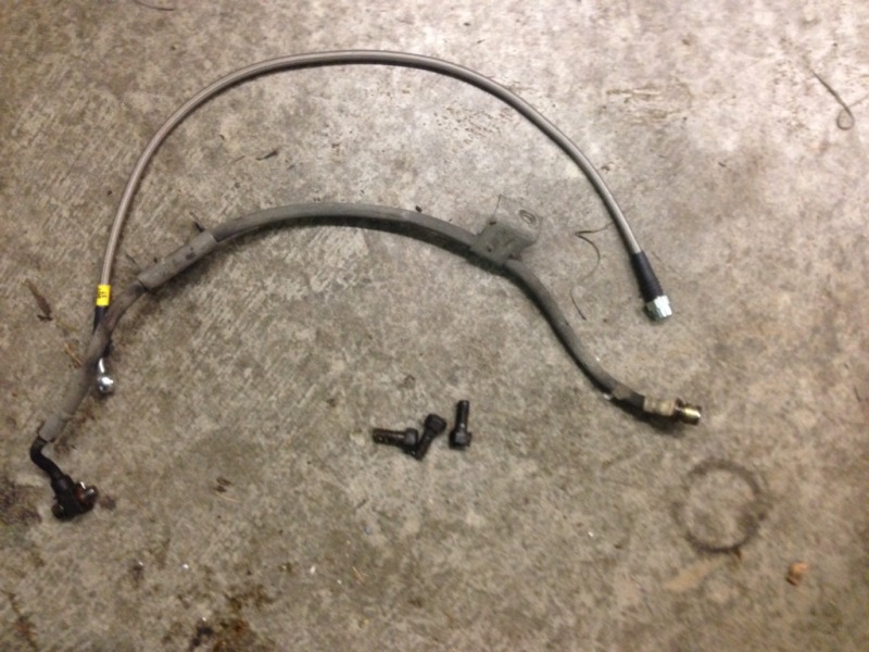

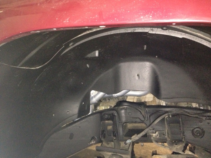

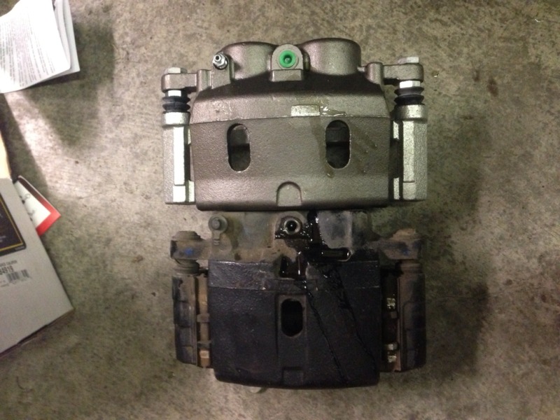

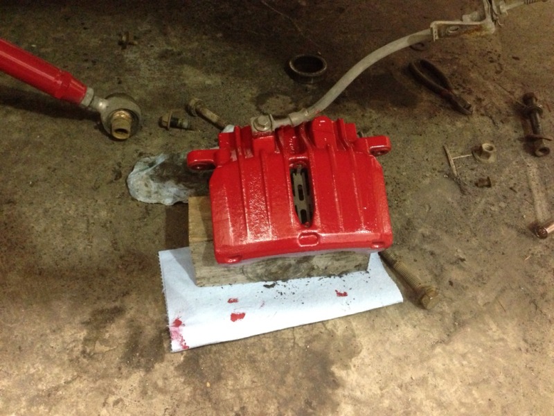

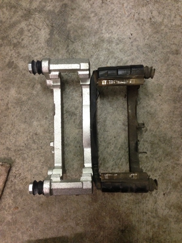

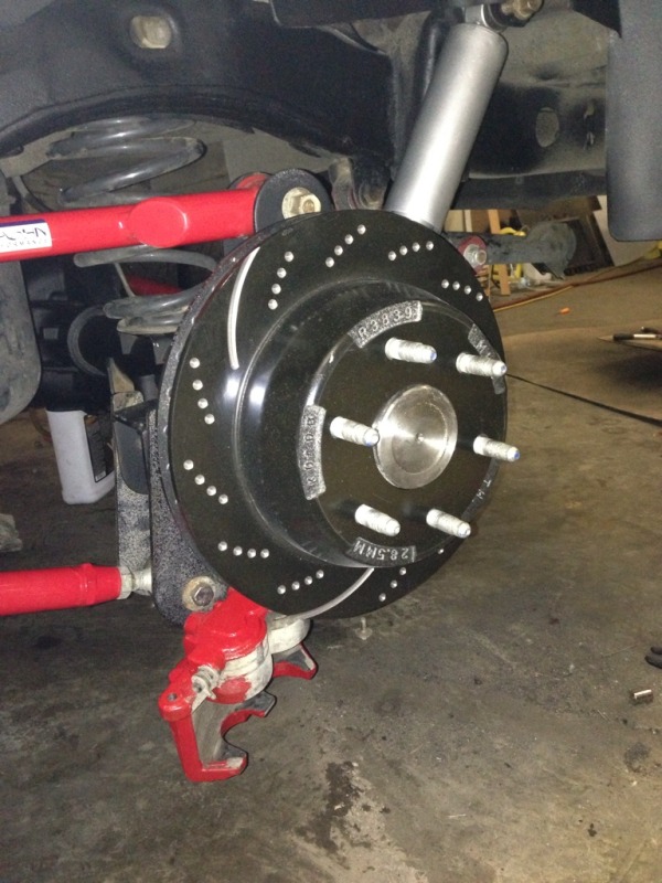

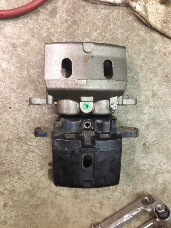

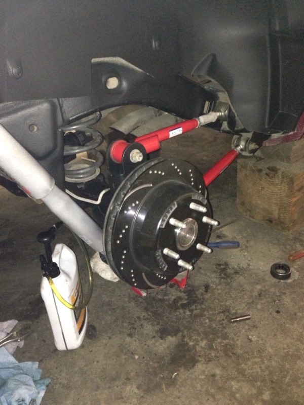

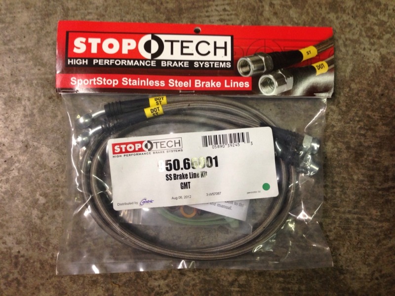

Got rear rotors and new front calipers the other day. Upgrading to GMT900 front calipers pads and rotors. Undercoated the front inner fenders and frame rails. Got StopTech SS front brake lines for the front. Also the next step will be installing Corbeau CR1 race seats along with a full roll cage.

Awesome build man Looking good!
Your LED dash has some Hot spots though Did you use the correct Beam angle for the LEDs?
Blacked-out-Tahoe
Blacked-out-Tahoe
Dec 5, 2012
93
Washington
Thanks, the dash has 5mm LEDs in it. And I'm not sure of the beam angle. The picture does make it look a little worse than it actually is but it does have hot spots ya. It was tough keeping the LED from the face of the cluster
Donnie Yukonie
Yates Caretaker
Jul 31, 2011
5,127
164
If it doesn't bother you than I wouldn't worry about it but normally that is caused by a concentrated Beam angle I.E 45 degrees ect. the wider the beam angle the less hot spots just a FYI for the future , can't wait to see more progress tho
Blacked-out-Tahoe
Blacked-out-Tahoe
Dec 5, 2012
93
Washington
Ya I get what your saying. I didn't look to much before I bought them. They don't bother me I don't look down at it to much while I'm getting on it. I'm waiting for more parts to show up next week so hopefully next weekend it will be most of the way back together

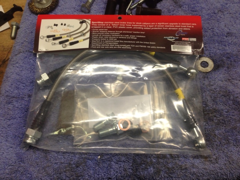

Heres some more pics of the new front cailpers. The 07+ GMT900 setup has 13" front rotors and almost 1" more of surface touching on the brake pads. So it will be an upgrade all by itself but we are putting EBC 3GD slotted rotors and Yellow stuff 4000 kevlar pads on it.
and StopTech SS front lines

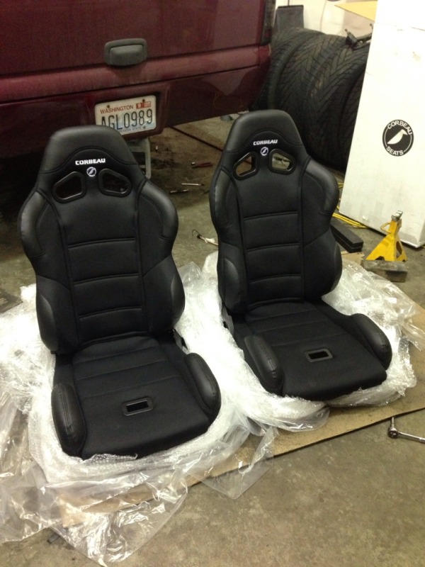

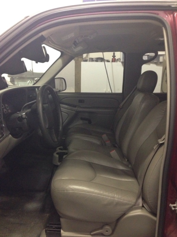

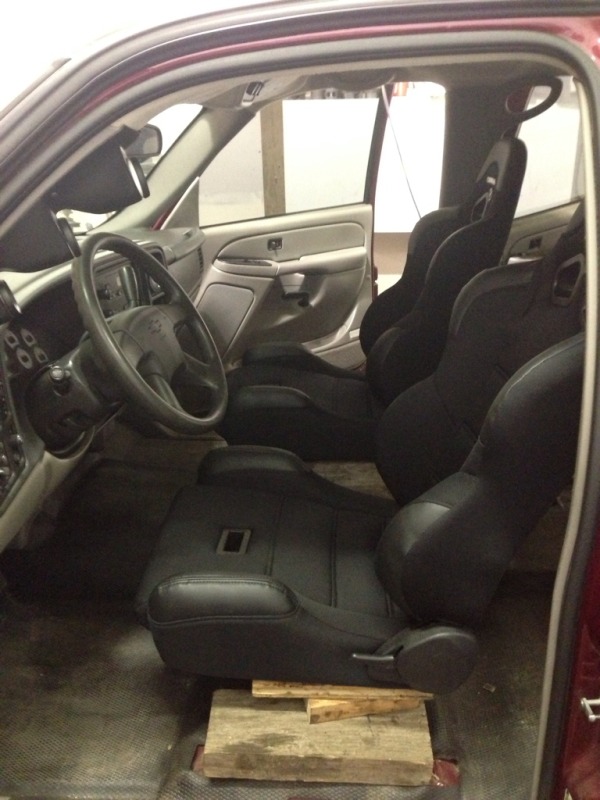

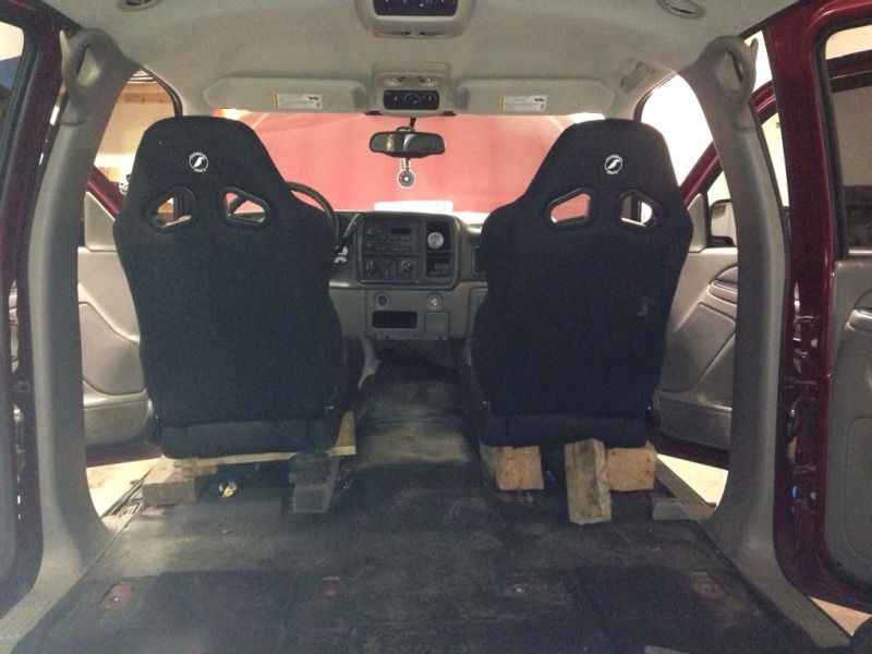

Have to wait until next week for seat brackets but in the mean time we test fitted the seats. Race mode anyone?
