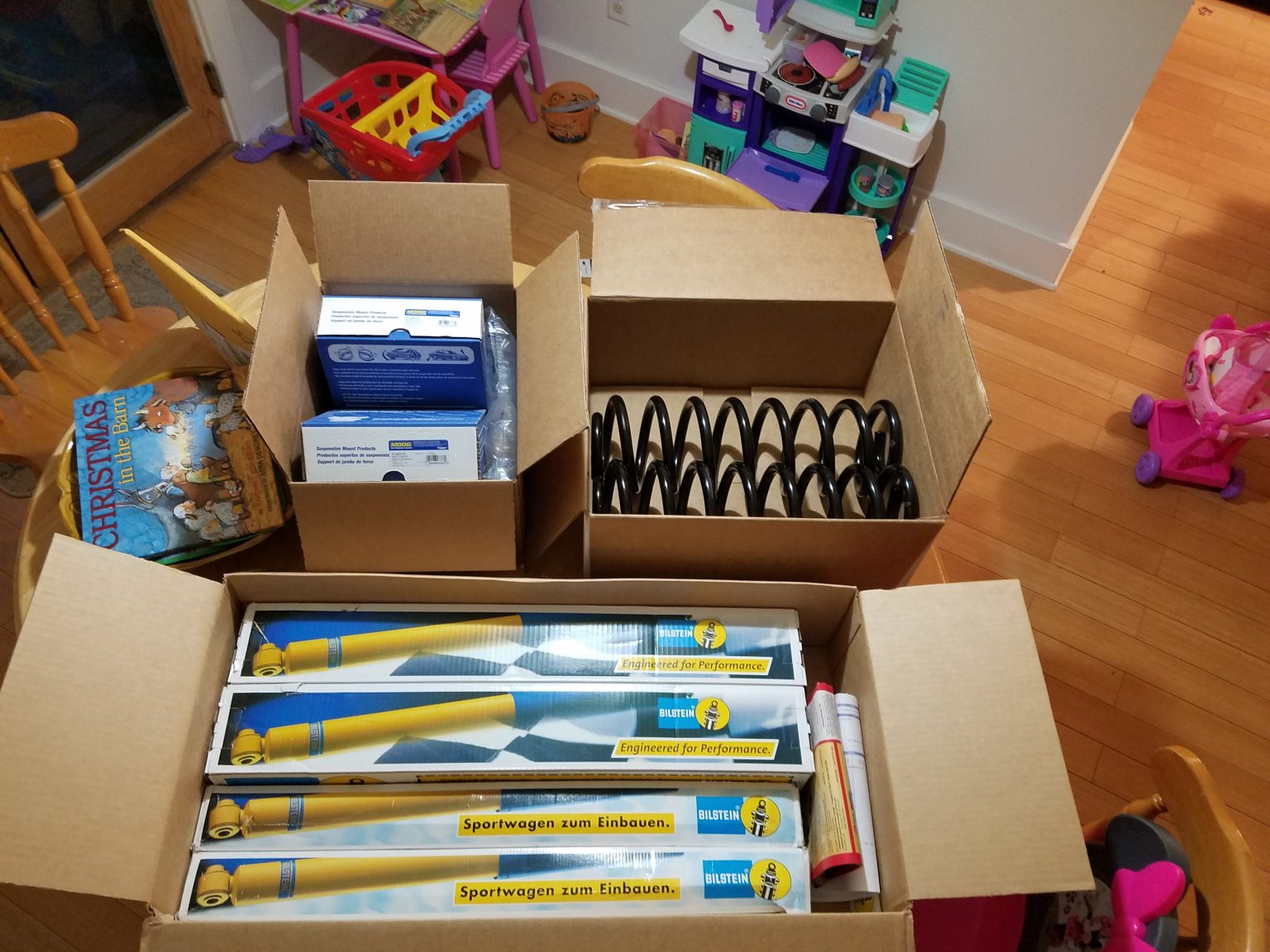

Just got all the parts in! I'll do the install early next week. (excuse my daughter's mess)
