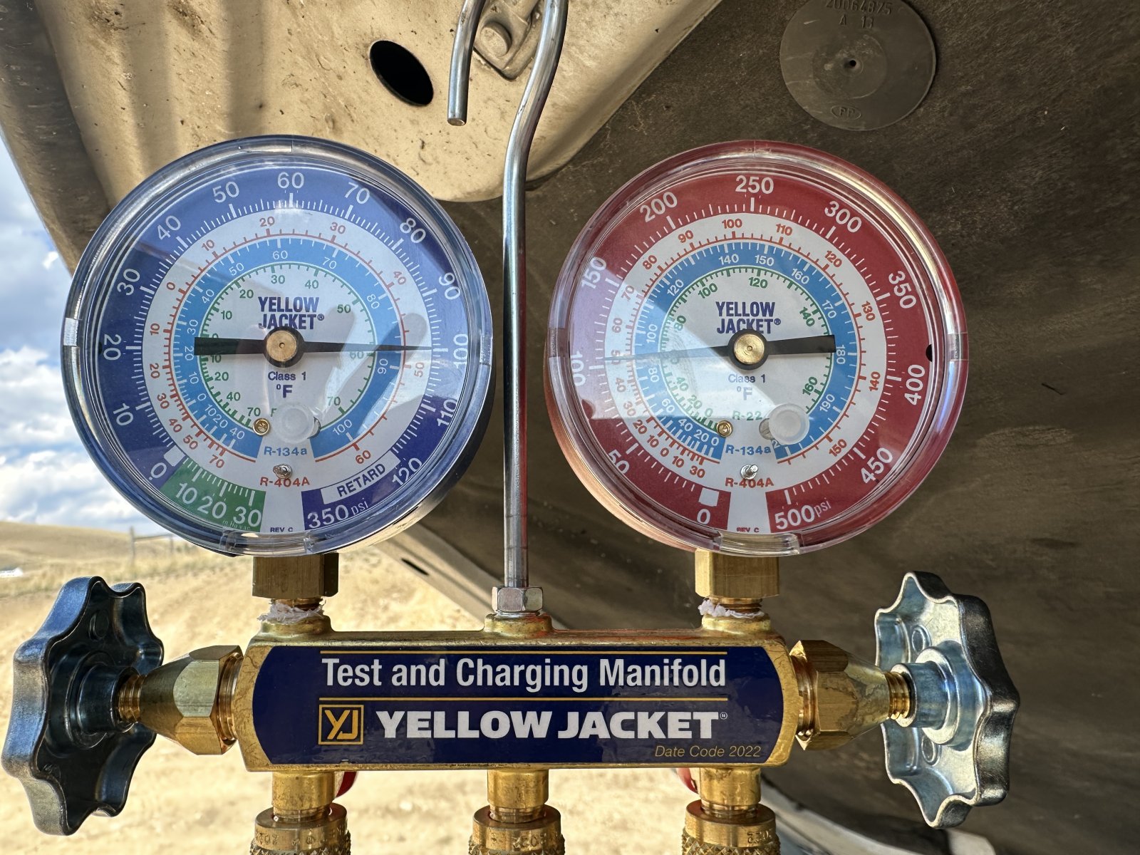

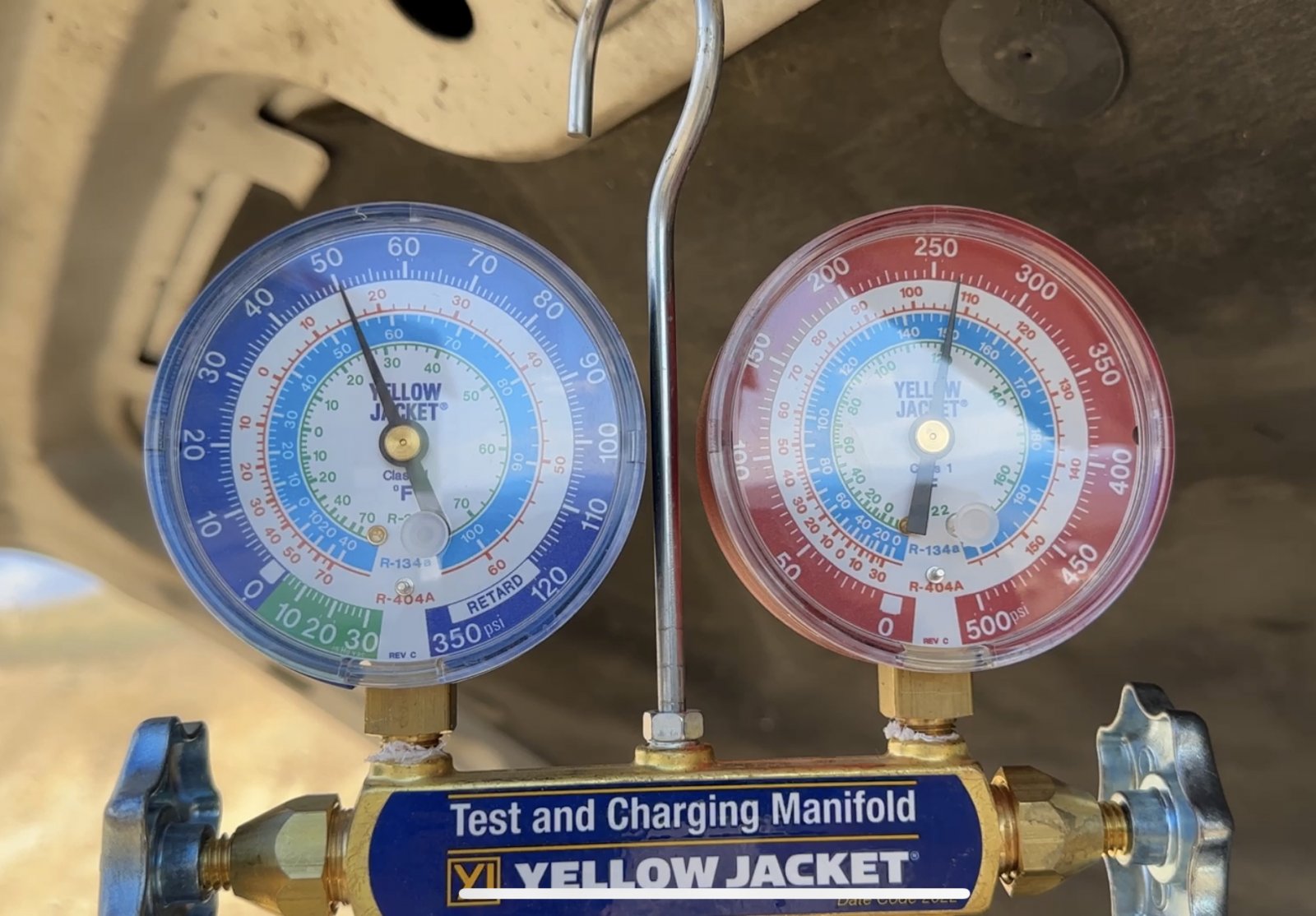

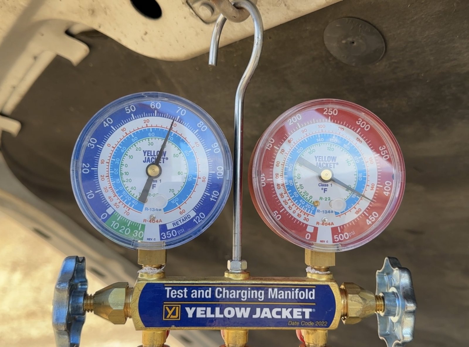

AC was working fine then wife said “AC is broken”. Okay. Gauges on. About 100 PSI not running.
Signal PCM for AC, low pressure drops to about 45 and high starts climbing. Low pressure side of orifice tube gets cold and high side gets hot. All good.
Shortly after - low side starts warming up and high side gets really hot. Look at the gauges and it’s pushing 350 PSI and keeps climbing. Naturally I turn compressor signal off before it blows o rings or hoses.
I repeat the same process and get the same results.
My first thought is plugged orifice tube but why isn’t the compressor shutting down at the high pressure limit? My only guess is either the previous owner put some great AC Stop Leak in it and plugged up the orifice and the high pressure sensor (assuming it has one?) or the compressor is about the grenadine and I’m going to find a mess.
I have to run it by a shop and get the refrigerant evacuated so looking for options before I get started.
Thanks in advance!
(Below image was third cycle of the AC button so it had not completely equalized so low side has already claimed a bit. )

Nice to know if you are just running the front, or front and rear.
Agree with 90 F static pressures, and the 3rd run pressure appears normal, suggesting a sticky expansion valve (running the rear at the same time should reduce the effect due to a parallel system).
Also suspect that it might be a bit overcharged with the pressures you provided. I would drain it (legally) until you got a 35 psi low side pressure.

Thanks for the reply.
I tried all three situations. Front only, rear only and both. The only change with both running was an increase in time to build the higher pressure.
I took it to a friends shop and had them pull out two oz on refrigerant. Suddenly… it is back to working normally although cycle a bit more often.
Ambient temp was about 82-85F that day.
I’m guessing the drop in refrigerant is causing the low pressure switch to trigger now even if the high pressure switch may not be working correctly. I’ll continue to monitor it. Thanks for the advice.
