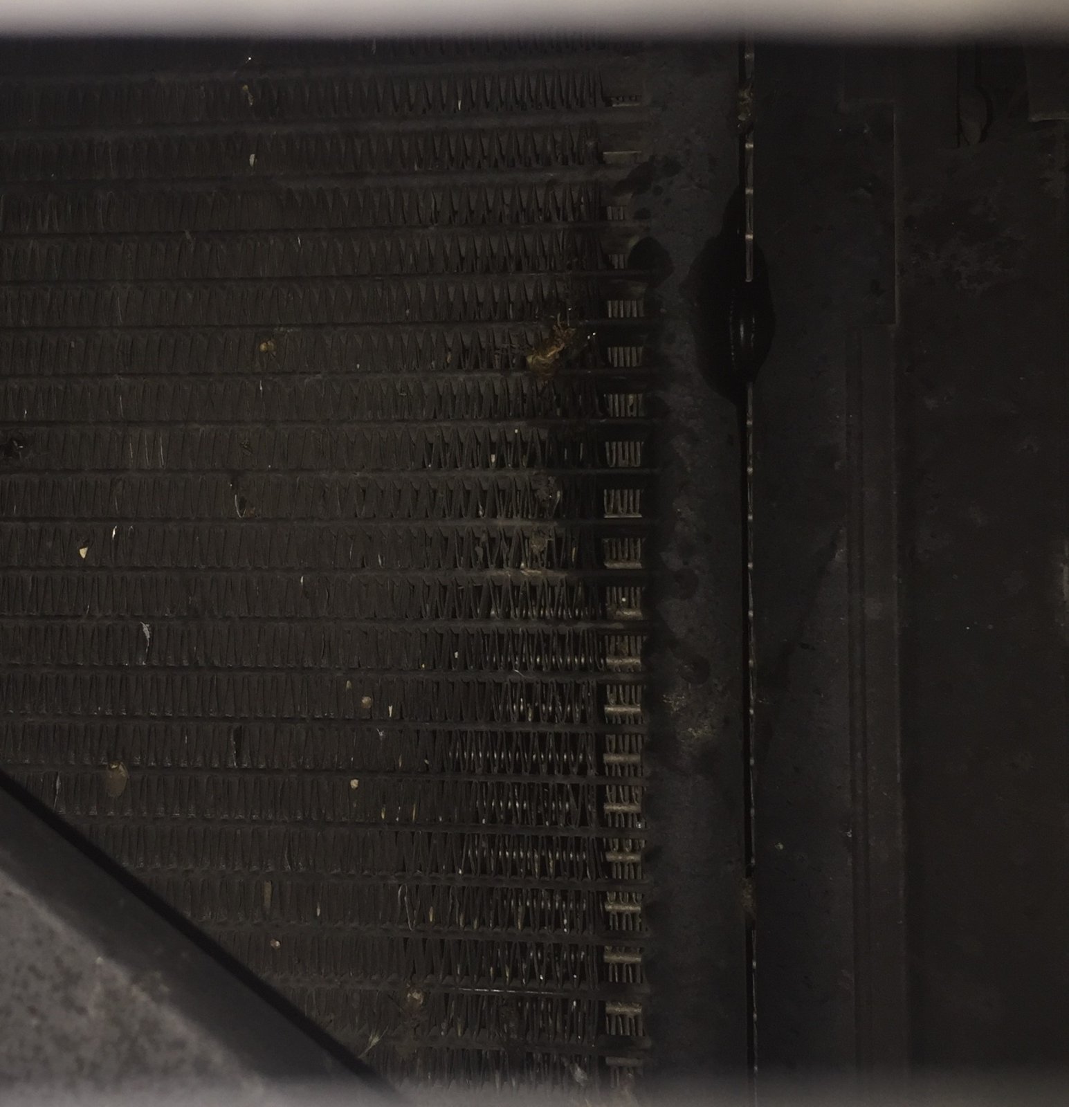

I looked at the coupling where the bulletin notes there could be a crack, and mine has a slight oily deposit around the area. Since I don't have a black light, I can't check for the fluorescence.
Looking for any advice and help you guys may have. I'm 1200 miles away from the 60k cutoff so I'm going to take it in to the dealer anyway BUT I wanted to be armed with your collective experience before I do.
