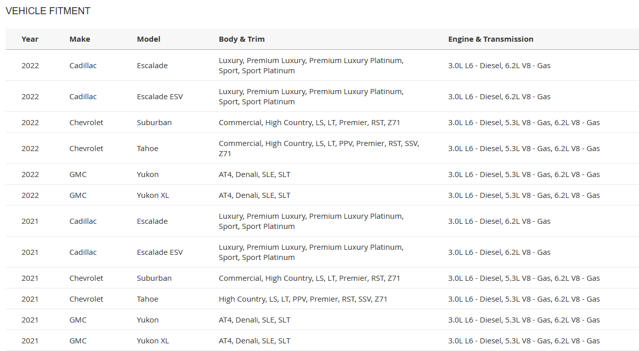

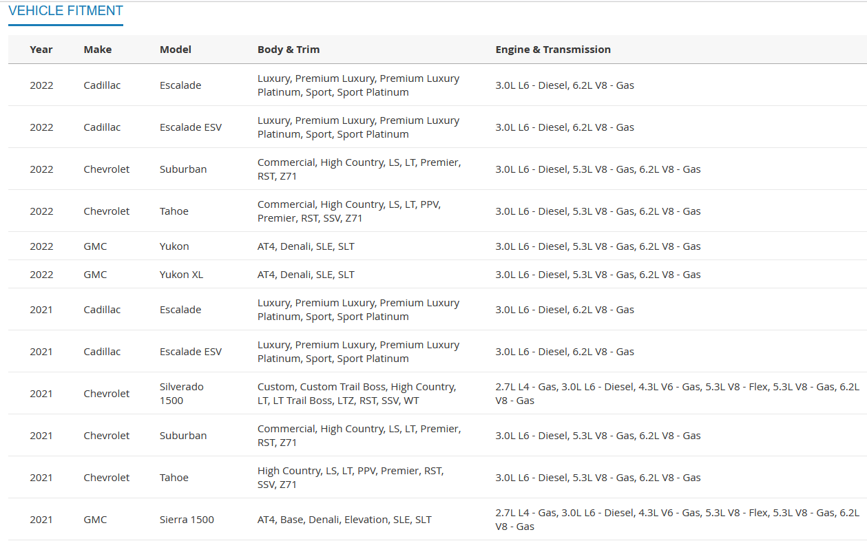

I need to find someone who knows the difference between these part numbers:
ACDELCO 84844874 GM Original Equipment Info
Fits Rear Left; Suspension Code(8GM), Suspension Code(8GN), Suspension Code(8GP)
or Rear Right; Suspension Code(9GM), Suspension Code(9GN), Suspension Code(9GP)
$81.79
ACDELCO 84844875 GM Original Equipment Info
Fits Rear Left; Suspension Code(8GR), Suspension Code(8GS), Suspension Code(8GT)
or Rear Right; Suspension Code(9GR), Suspension Code(9GS), Suspension Code(9GT)
$84.79
