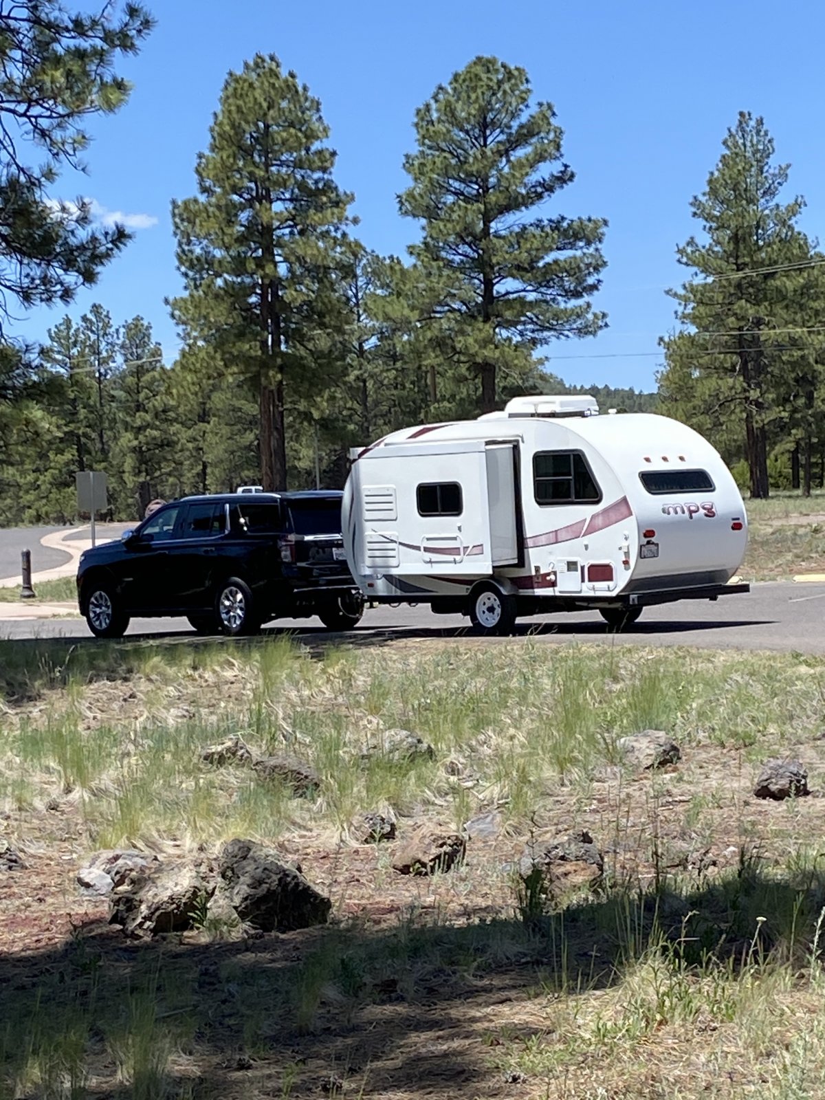

We love towing with our 21 premier, trailer around 4K loaded.
