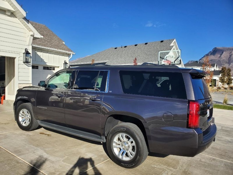

I have done a lot of reading and have not found exactly what I am looking for.
Like stated in subject, I have a 4” BDS non coil lift on order. I have 285 60r20 toyo at3 waiting to put on.
My question is where did you guys get the parts for the autoride setup to extend the rear shocks and the ride height linkage to match the 3” spacer.
Trying to have everything ready for when I get the lift.
Thank you for any help.
