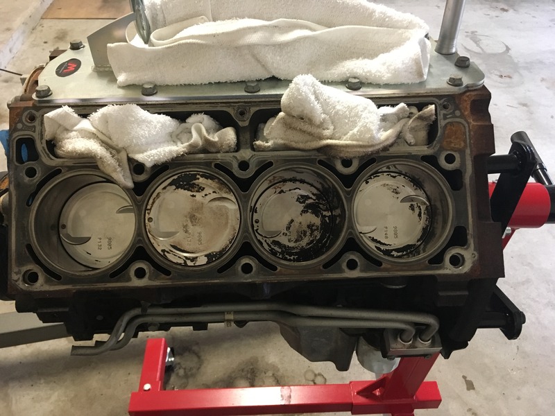

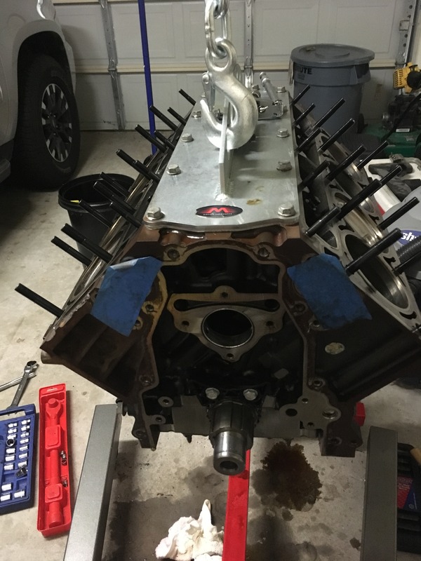

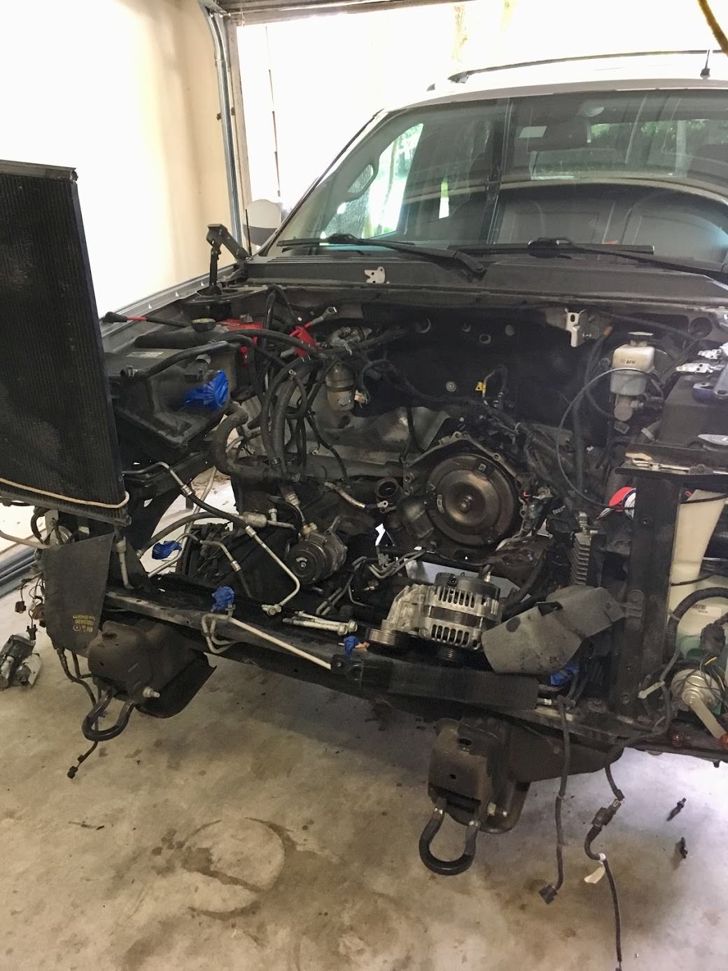

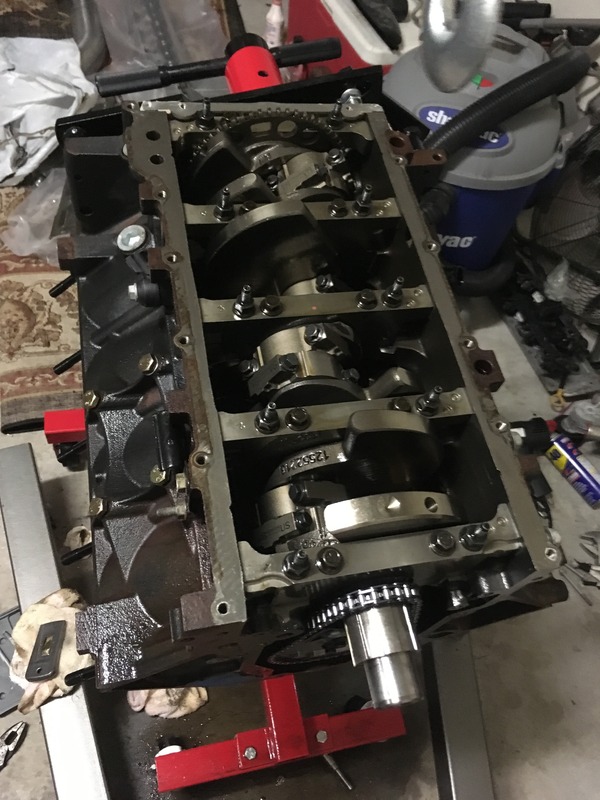

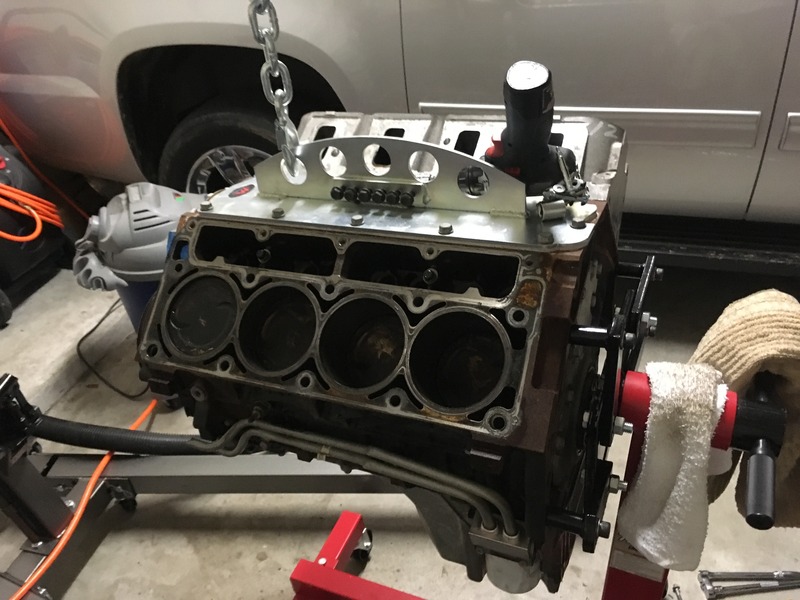

Currently working on swapping out my 5.3 for a 6.0...
Justin originally tuned my truck in person on 03/07/15 in person in Houston, TX...the tune has been excellent!

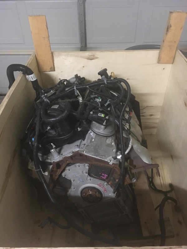

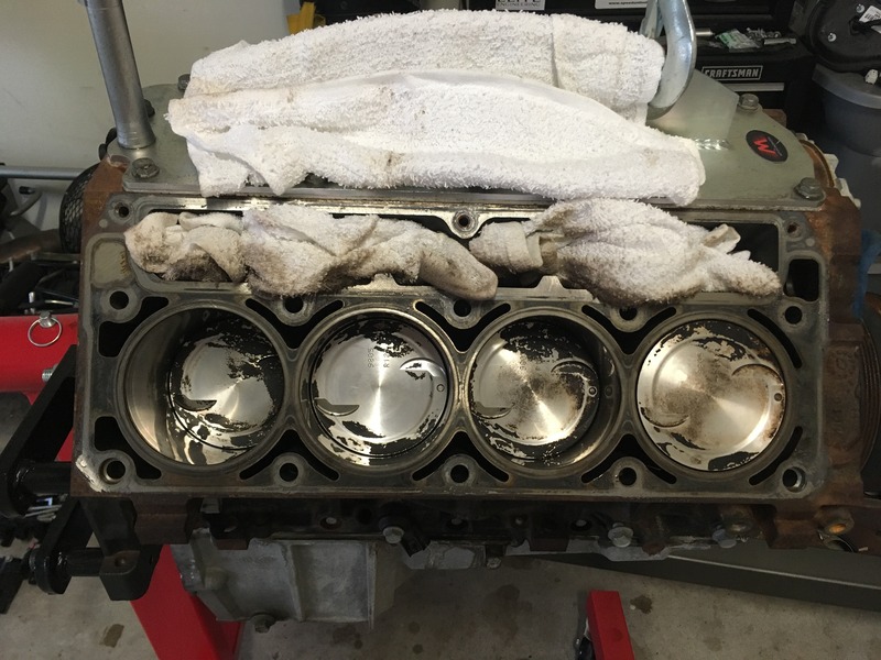

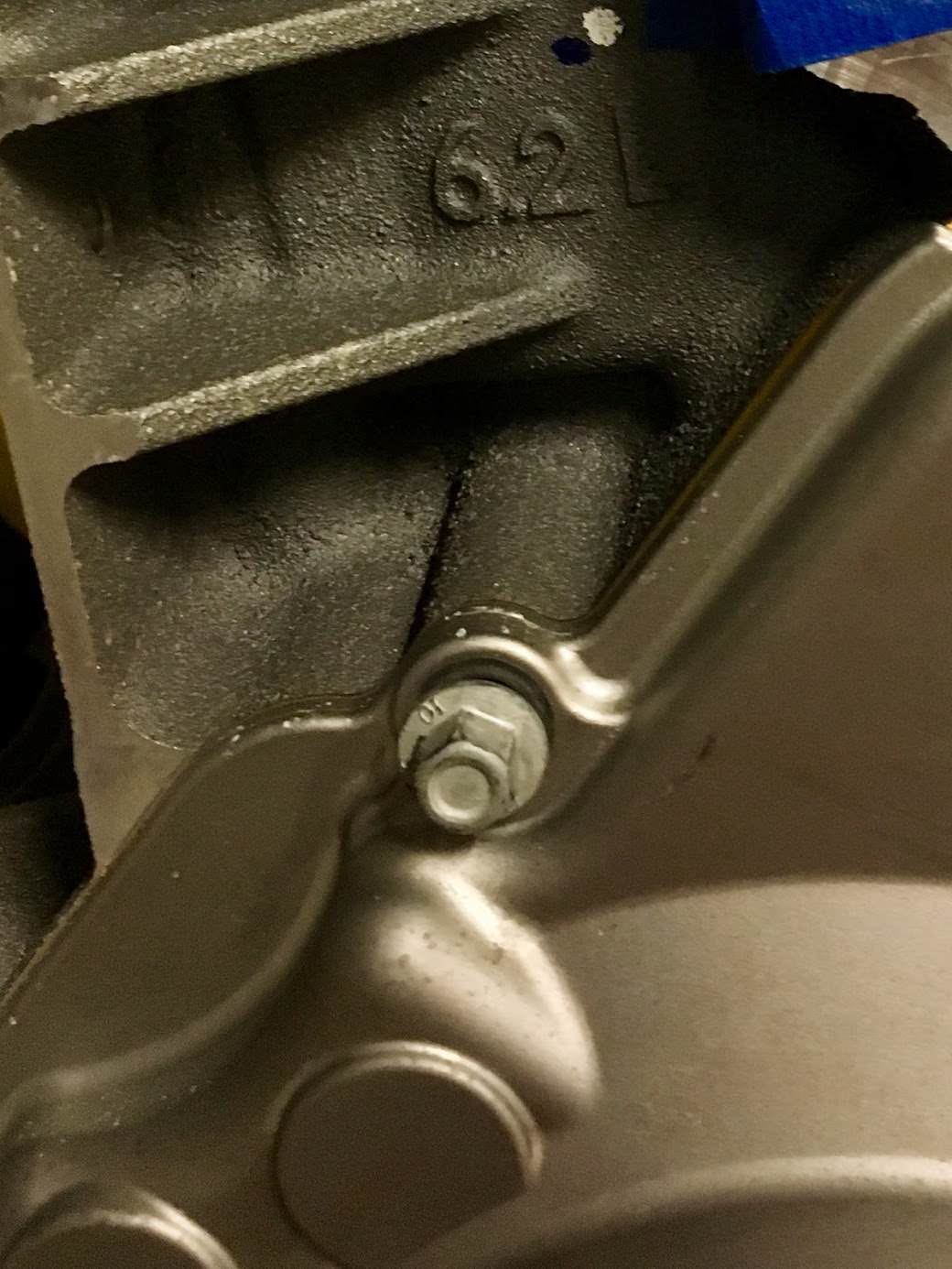

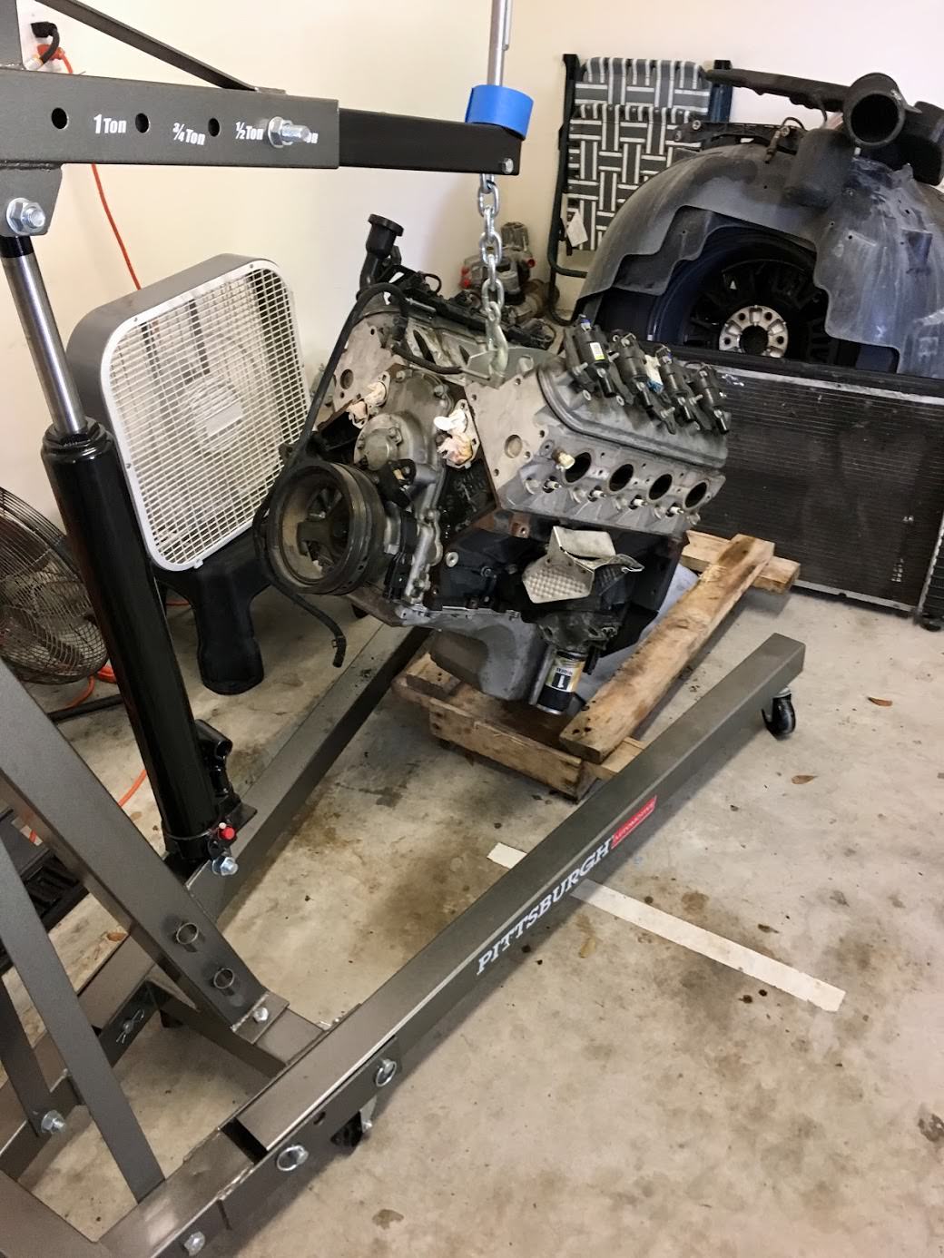

I bought a 2015 L96 out of a wrecked 2015 Silverado 2500 with 35k miles...

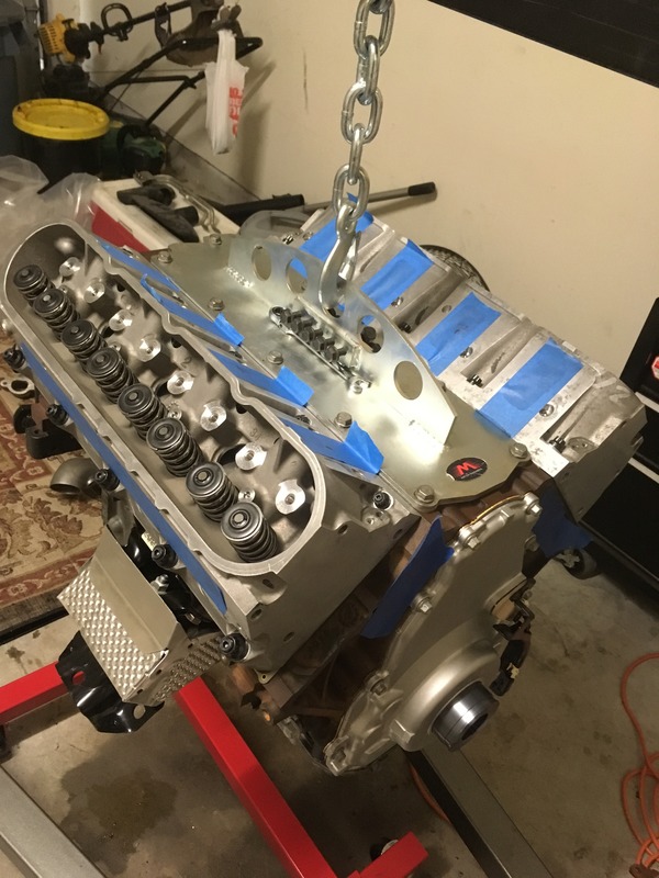

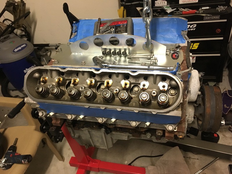

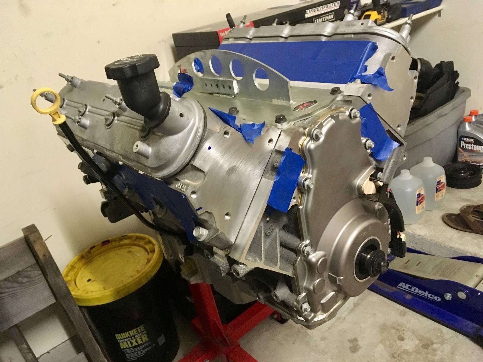

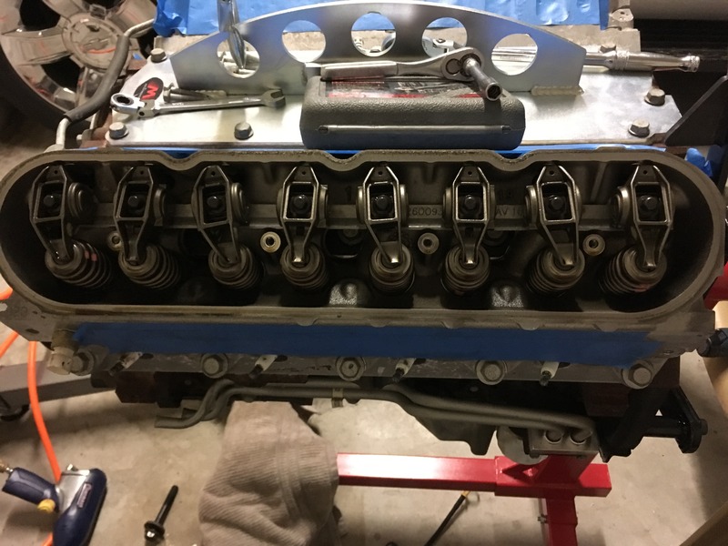

I have just finished deleting the VVT, swapping the cam and installing the LS9 Head Gaskets and ARP Head Studs...just waiting on my injectors and I need to measure for my pushrods

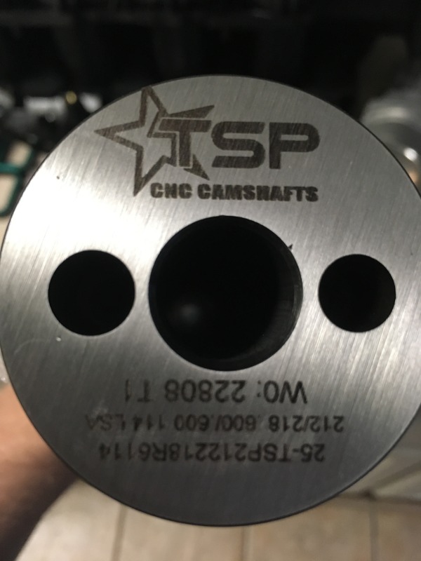

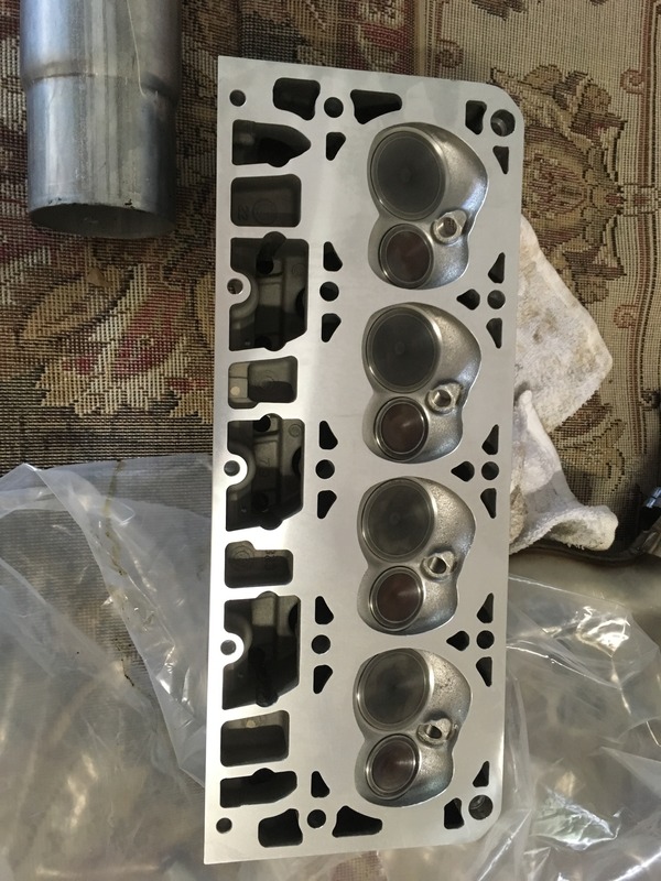

The cam is a 3 Bolt Non VVT Texas Speed 212/218 .600 Intake .600 Exhaust 114 LSA 111 ICL using the BTR .660 polished Valve Springs. The 6.0 has 823 Heads (Rectangle Port Heads), I had them milled 0.030 and added LS9 Head Gaskets and ARP head studs. I am using an L92 truck intake with the 6.2 truck Flex Fuel injectors which I think are 42lb or 54lb? Part # 12609749, I believe the 5.3 in my Avalanche now is tuned for the 36lb Injectors, Part # 12613411.
For the time being I will be running the factory exhaust manifolds and 93 octane only. But later down the road I will be adding a set of Kooks and switching to E85.
I purchased the AutoCal from BlackBear a month ago. It is Serial # 5000965503.
Is there any additional information you need from me to provide a tune for the swap?

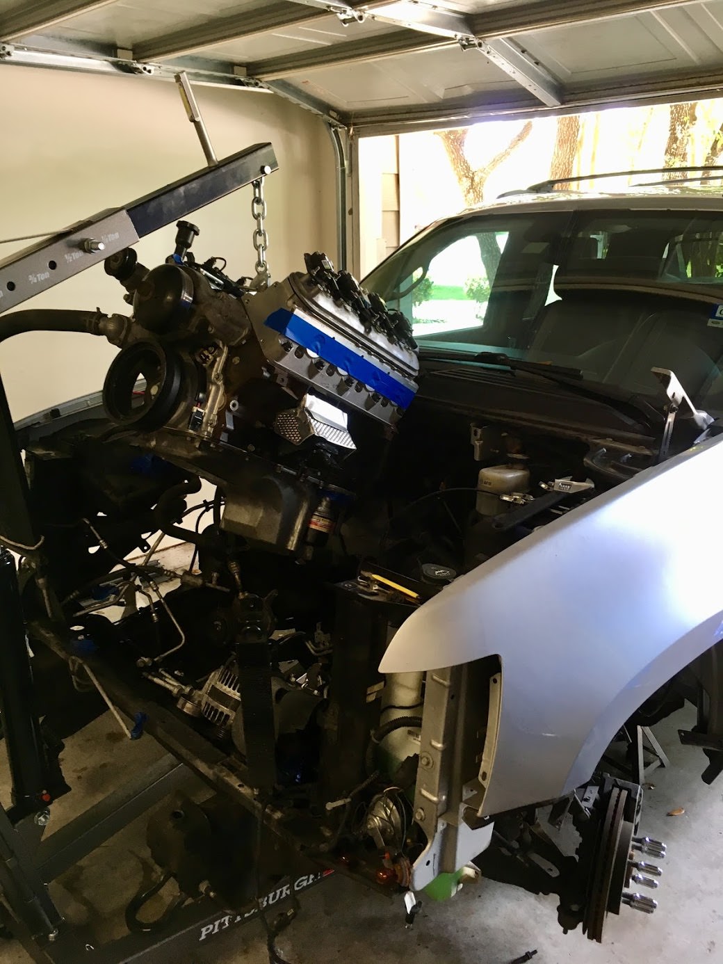

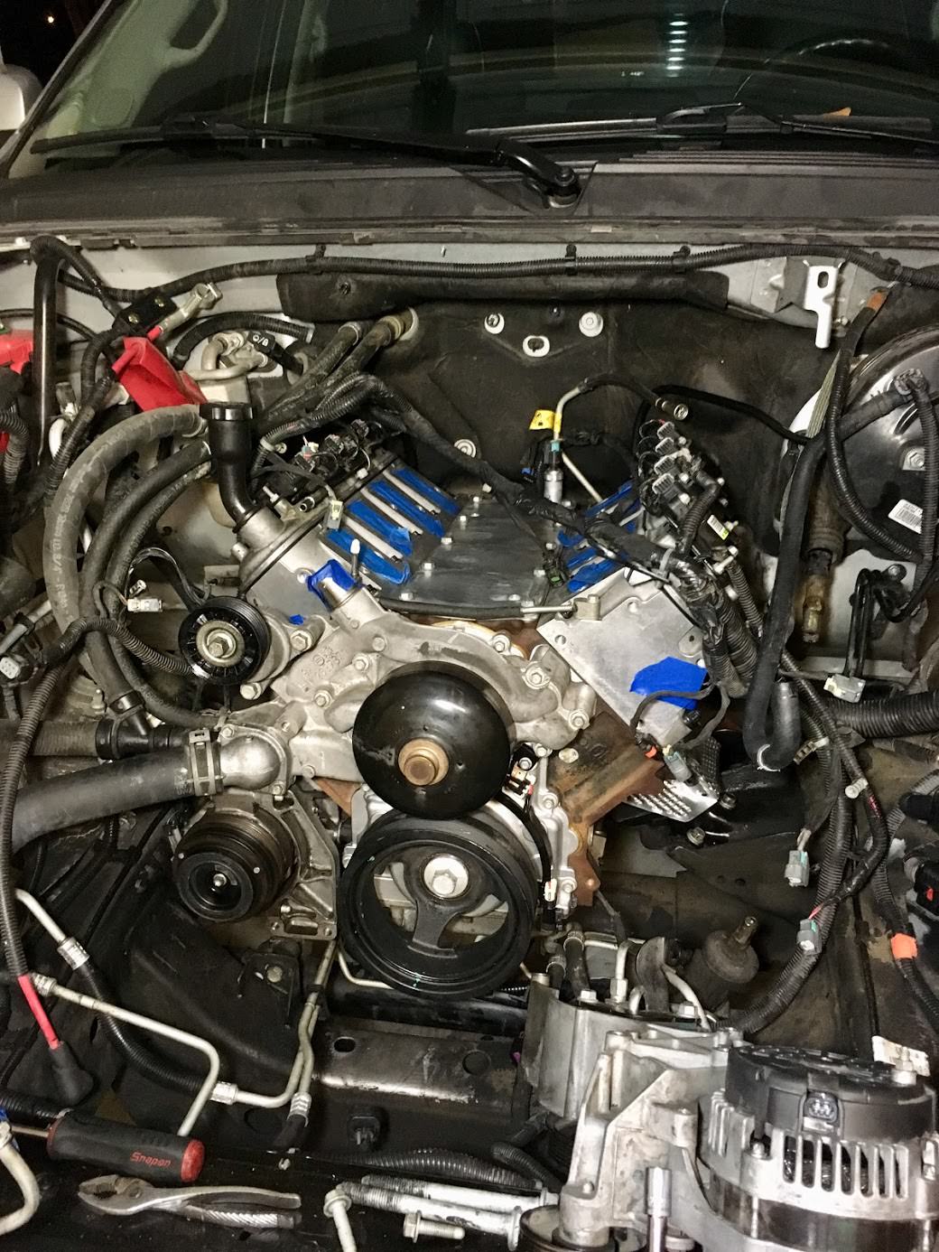

Email received! Great customer service!...looking to do the swap on the 14th...will keep the forum posted with progress updates!
01FormulaTA
01FormulaTA
Mar 23, 2017
534
561

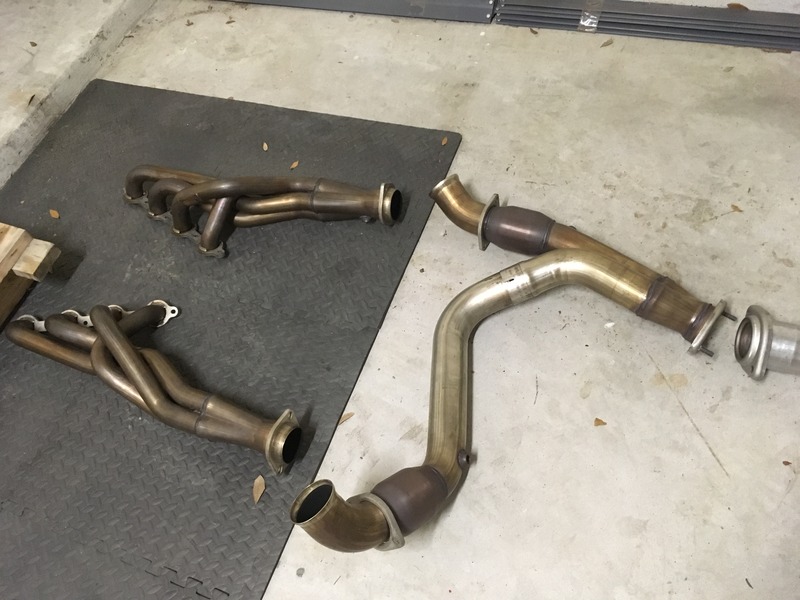

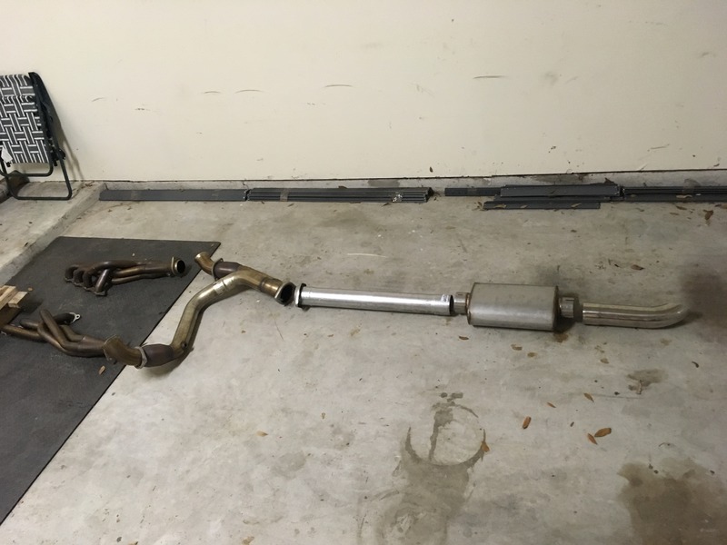

Got the tune file today! Hopefully I can the new motor in this weekend...scored a deal on some ARH headers on Craigslist so Im gonna do the exhaust as well..
