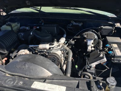

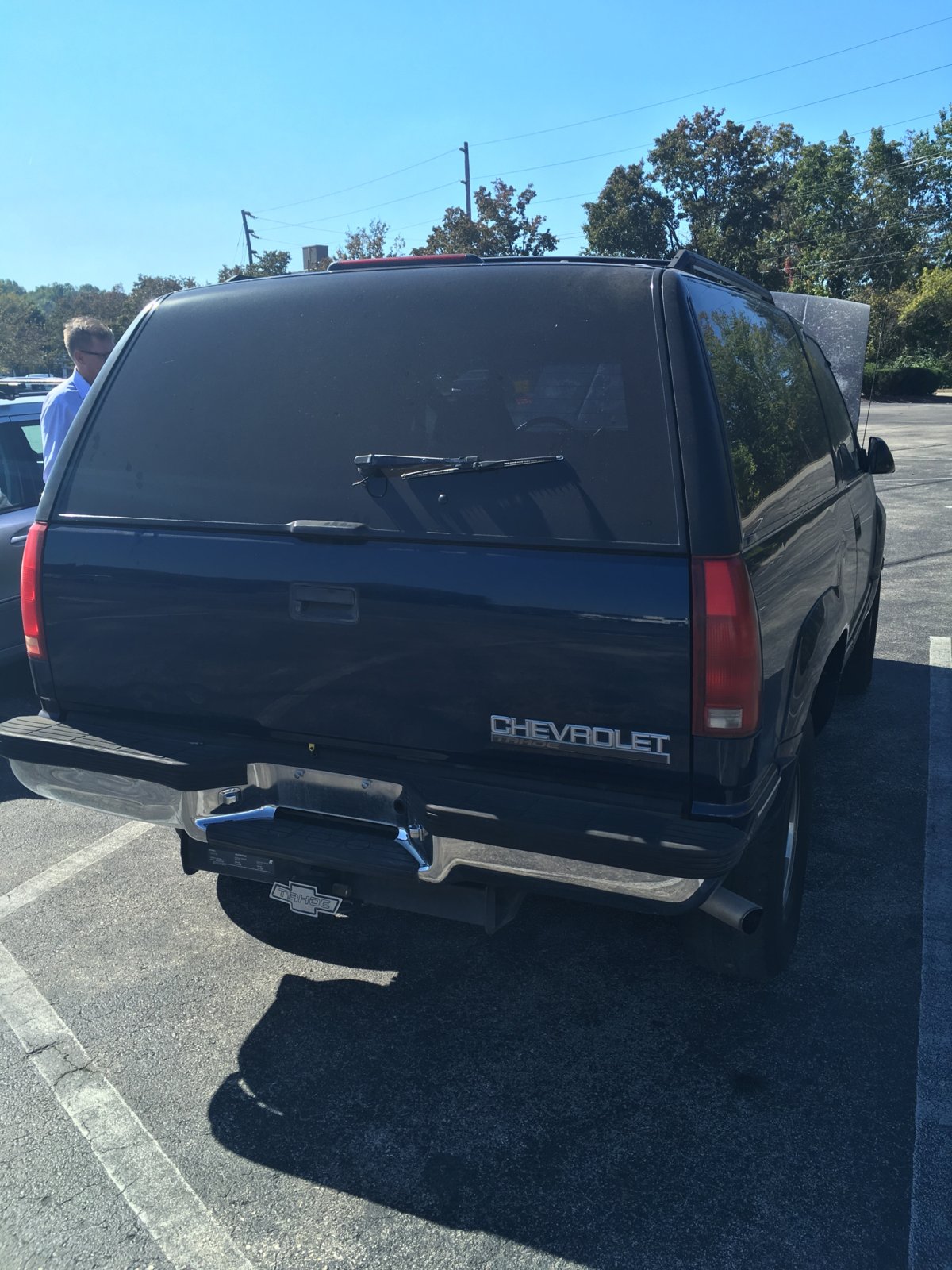

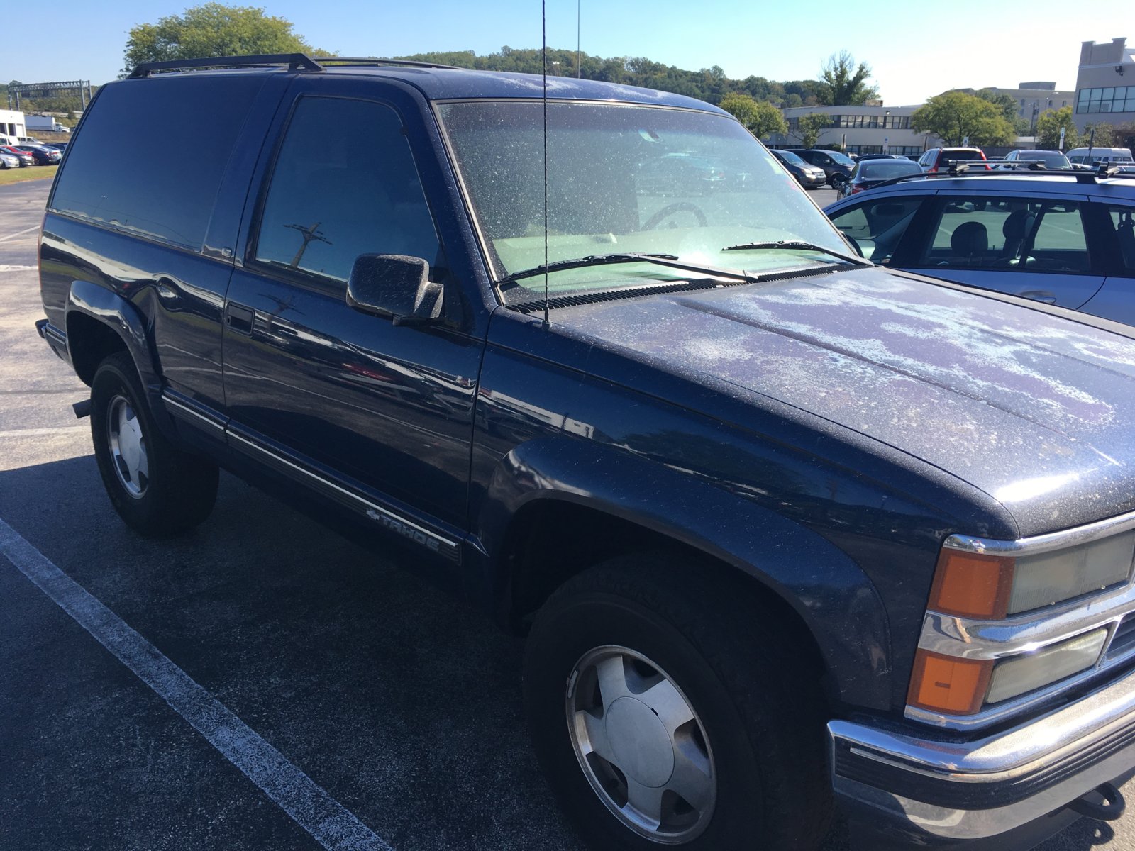

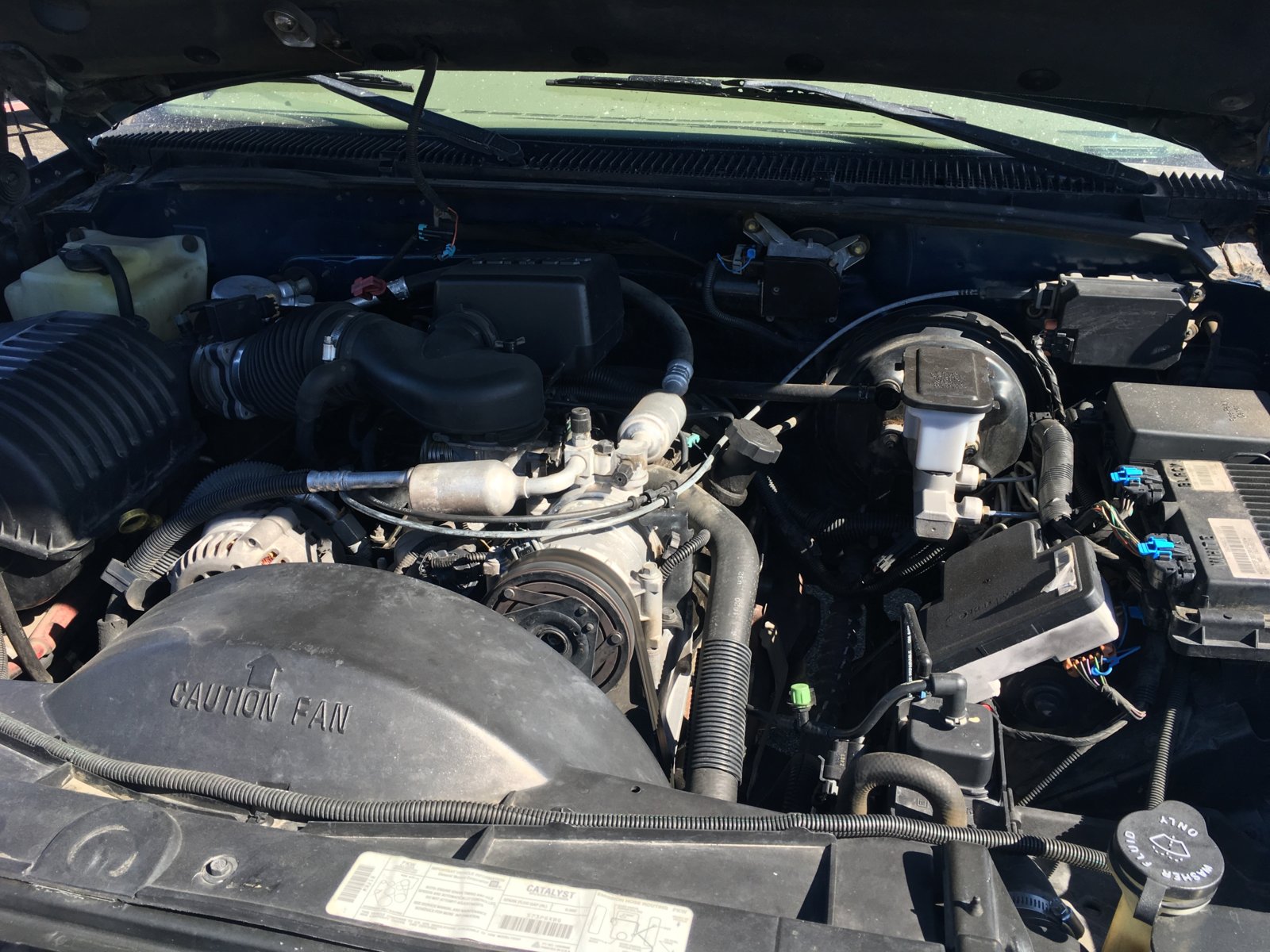

Well I got the truck finally a couple days ago. Here are some pictures. It looked a lot better after I got it washed but I forgot to take pictures afterward.
It's amazing what the sun can do to stuff. The indigo blue paint (what's left of it) has turned a medium blue in the Arizona desert. The good news is that the underneath of the truck pretty much looks like it just rolled off the assembly line.
I found a guy right next to the body shop I intend to use that I am hopeful is going to handle the mechanical side of things. He has a '96 silverado as his family truck for towing on the weekends and has a good knowledge of Chevy so I think it is going to work out well.
She broke down on me on the first voyage, and the mechanic thinks it's the fuel pump. Was also leaking oil like a sieve and he said someone took blue silicone to the bottom of the timing chain cover in a last ditch effort.
Next week will going over things completely. The engine is super clean as is the oil inside it. Despite 188K miles, I am thinking of keeping the original motor in it for now.
Seats are the color known as "neutral" and I think will be hard to match with new seats.
I am kind of obsessing over the seats because I really want to replace the front seats with modern GM truck seats. Looks like they will need to be mounted to the old tracks. If anyone knows of a good thread on here where this job has been done it would be a help. Also if anyone knows of a direct bolt in for the rear seats that would help too.
