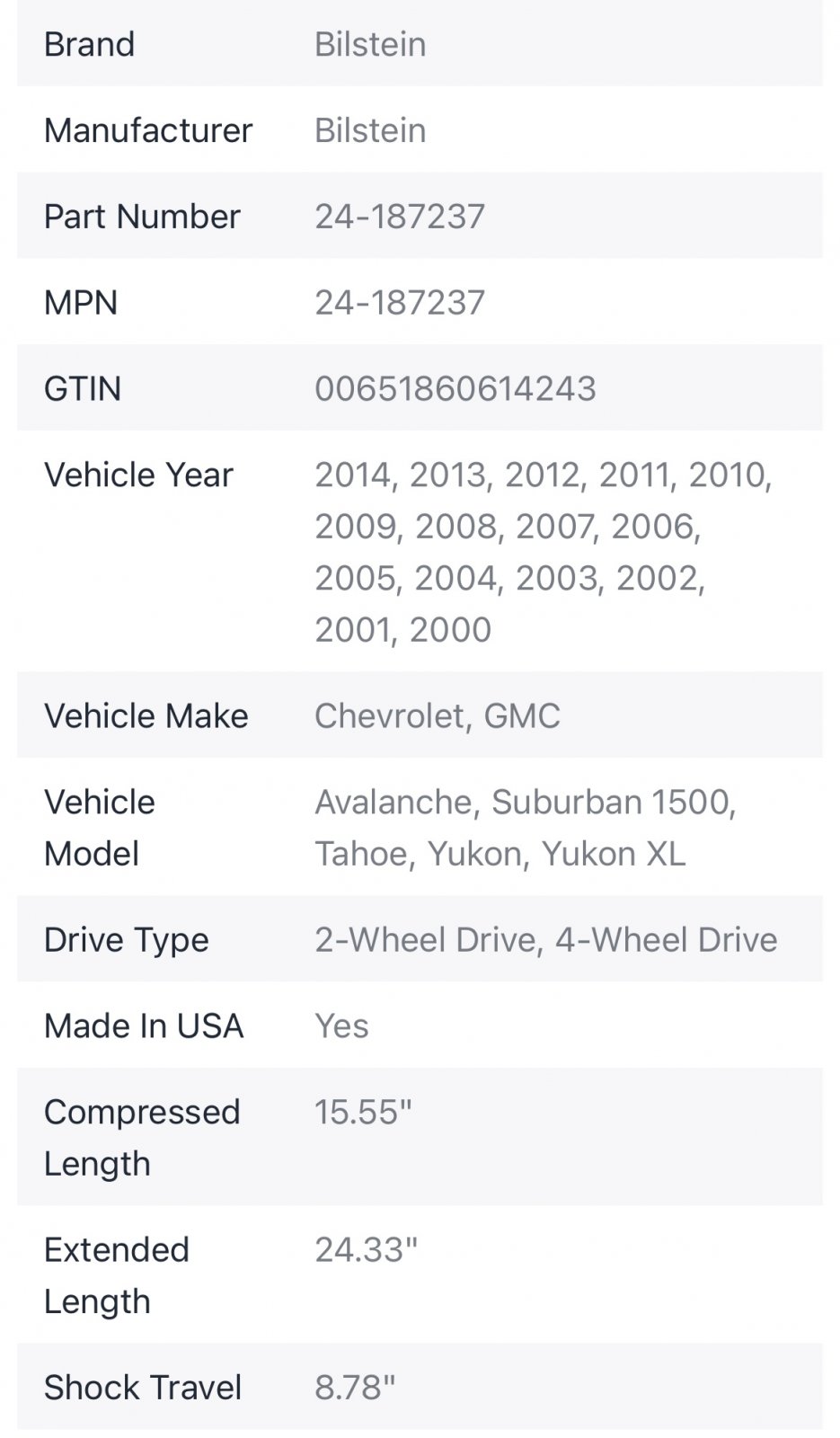

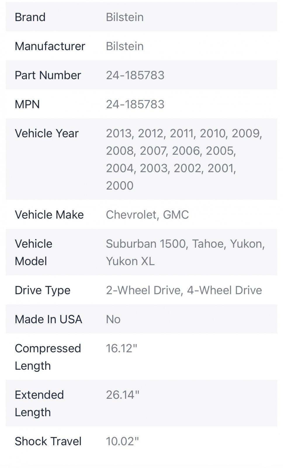

Hello. The car is a 2007 Tahoe Z71 4WD. I'm having trouble with my Bilstein rear shock.
I would like a 2inch lift.
24-187237 seems to be suitable for the normal height, but I would like to use 24-185783.
I use genuine z71 coil. I don't want to use spacers.
Please give me some good ideas.

Most of the bilstein 5100s you’ll find online will be for 0-2” of lift or for 2-4” of lift

Thank you for reply.
24-187237 or 24-185783.
Which do you think is better?

The z71 coils after settling are .8-1.5 inches of lift nothing crazy

Probably meant 1-1.5” of lift from the springs
Either of those shocks should work fine for your application but if weary get the second set you posted that’s for 1” of lift
The coil springs have been used for about 200,000 miles.
I feel tired and weak.
Is Bilstein 5100 24-185783 recommended as a choice?
Desired lift is 1.5-2inch.

The damper (shock) isn't intended to raise or lower the suspension. The length and travel are meant to match up with what's needed for your lift (done by springs, etc.)
